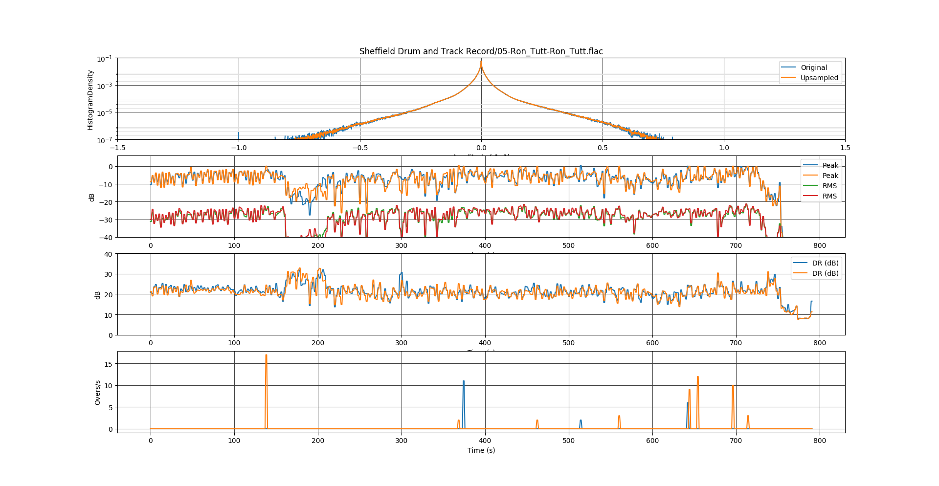

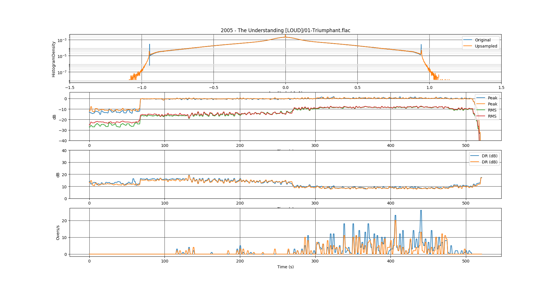

I upgraded the script.
Here are two songs compared. The first is a very compressed Royksöpp piece, which is only listenable in the car. This is a pity, because the album is quite good, except for the terrible mastering. The second is high dynamic range drums from Sheffield Drum&Track record.
Graph explanation:
On top we have a histogram of sample values. Amplitude is on X axis, from -1 to 1. The Y axis shows how many samples have this amplitude.
Royksöpp: Histogram is quite flat, which means the signal spends lots of time at high amplitudes. Also, there are peaks a bit below full scale (around +/- 0.9) which means the sneaky bastards applied some hard clipping then turned down the volume a bit to fool software which would detect samples pegged to the maximum value.
The orange curve, which extends past full scale in amplitude, comes from the sample values after 4x upsampling. Intersample overs show up.
Next curves are computed on oversampled data.
Graph #2 is RMS and peak amplitude over 1-second intervals. One curve per channel. Notice how well the peak value stays pegger to 0dB (and sometimes a bit above) while the RMS is also constant, ie, compressed to death.
Graph #3 is dynamic range (ie, difference between peak and RMS).
Graph #4 is number of intersample overs per second. It does not include samples clipped in mastering...
I can share the source code, if someone wants to play with it. It's python, so quite slow. If someone wants to make a fast C++ version....

Hi George, in your attached picture, on the right side, there's some kind of SW showing a signals corresponding value in bits, can we know the name of the SW used and where can we find it, thanks. 🙂
Hi maiko.
The SW is Steinberg Wavelab.
I’ve used version 4 and version 6. Both have the Bit meter under the “Analysis” tab.
Bit meter has two modes:
The “True mode” shows the bit depth of the file (fixed indication along the full length of the file).
The “Intuitive mode” shows how many bits are used during the flow of the program (this is what I showed in my post).
George
