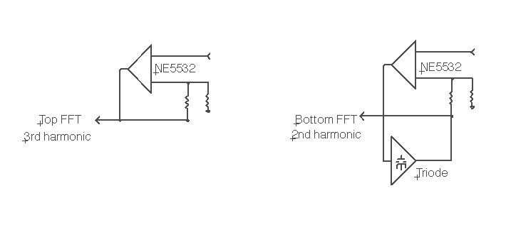

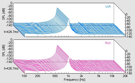

my latest uses opamps with valve in feedback loop.
Test on thd are as expected as the ne5532 is control element.
Interesting that looking at fft , same opamp only, waterfall shows dominant third.
With 6sL7 in fb loop the third reduces and second appears, slightly higher than reduced third.
This is a difference that can be heard and measured.

This makes zero sense.
Hope this helps.
Relative to the thread question, it looks like within the opamp output stage is where some work is required.
That is, if your goal is great sounding audio.
