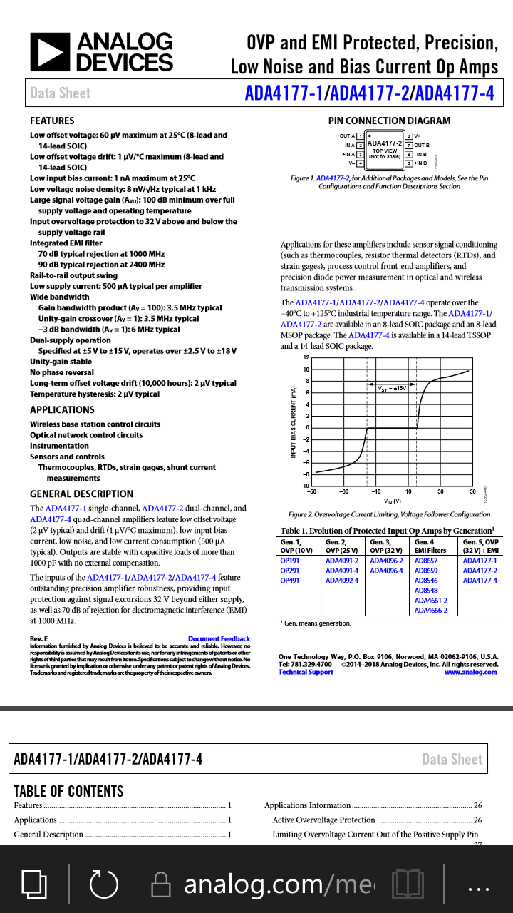

Anyway decided to make the opamps replaceable and add four 1k limiting resistors . One pair for each side of the opamp. Board is larger now.
I still think this is a component the chip mfgr should have built in and laser trimmed.
Would destroy the purpose of low noise op-amps.
Protecting Off-Amps | Analog Devices
You could also just disconnect the input when the power is off.
There are some parts that have internal protection, but they aren't the greatest for audio, like ADA4177.
Op Amp Input Overvoltage Protection | Analog Devices
If you TRULY BELIEVE that laser trimming the current limiter 1K series resistors is important, you can achieve the same result on your board full of discrete, not integrated, components. Simply purchase a large number of 0.1% 1K resistors from the low cost line item at Mouser, and then methodically winnow them down to one or two matched pairs, using a 7 digit benchtop meter made by Fluke or Kiethley or HP, that you purchase used for $300. I bought my benchtop 7 digit meter from John Bau who is a member of diyAudio, and who does business as linearz dot com, in case that helps. Presto, 100ppm matching for ten dollars of additional "marginal cost", and/or 10 ppm matching for a hundred dollars of additional "marginal cost". You pays what you wants and you gets what you pays fo.
What the user does with the (composite)part is something I can't predict and I also have no control over the target assy.
Ie power on/off , large amplitude square waves or a single fast rise time event etc.
It is my job to provide reasonable protection for the part.
Input current limiting falls within the scope of what is reasonable.
The chip mfgr should have addressed it (as diodes are on the die).
