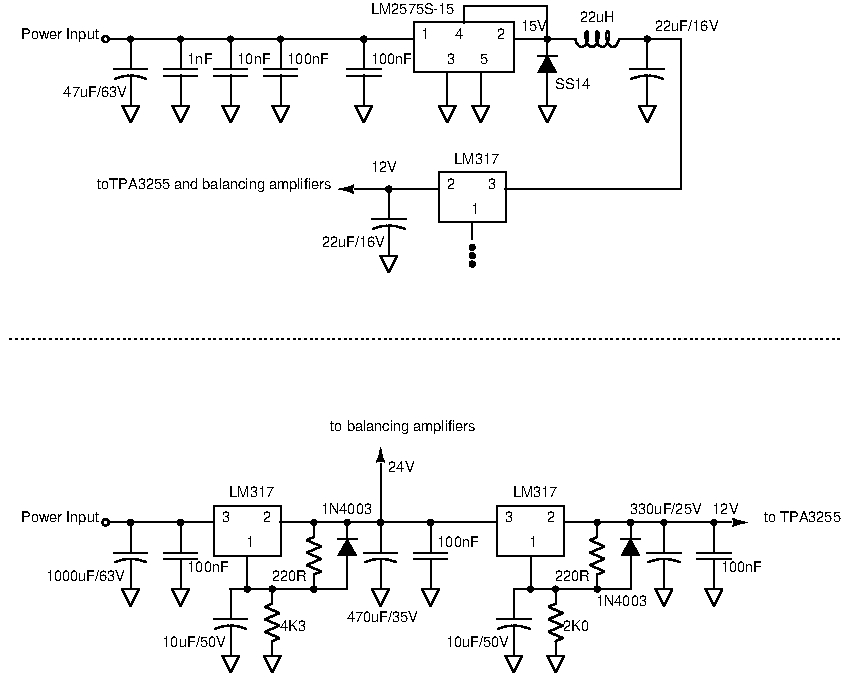

Chris, the Doctor, Think and many other did an impressive job in analyzing and proposing modifications of the “TPA3255 blue board” sold on Ebay, Amazon, AliExpress etc. Chris made me aware of the LM2575(HV)S problem so I started drawing up the low-power part of the board circuit. Schematics are appended to this posting.
The onboard power supply is made up of a Buck converter, stepping the input voltage down to just above 15V, followed by a linear LM317 regulator taking the voltage down to just above 12V with reduced ripple. The reason for the Buck converter is that the 12V consumption is above 100mA.
My concerns:
* I do not really appreciate an SMPS on a board with a high performance audio chip.
* The Buck output capacitor is 22uF rated at 16V (15.5V output voltage) and of an ordinary SMD type – not good for reliability.

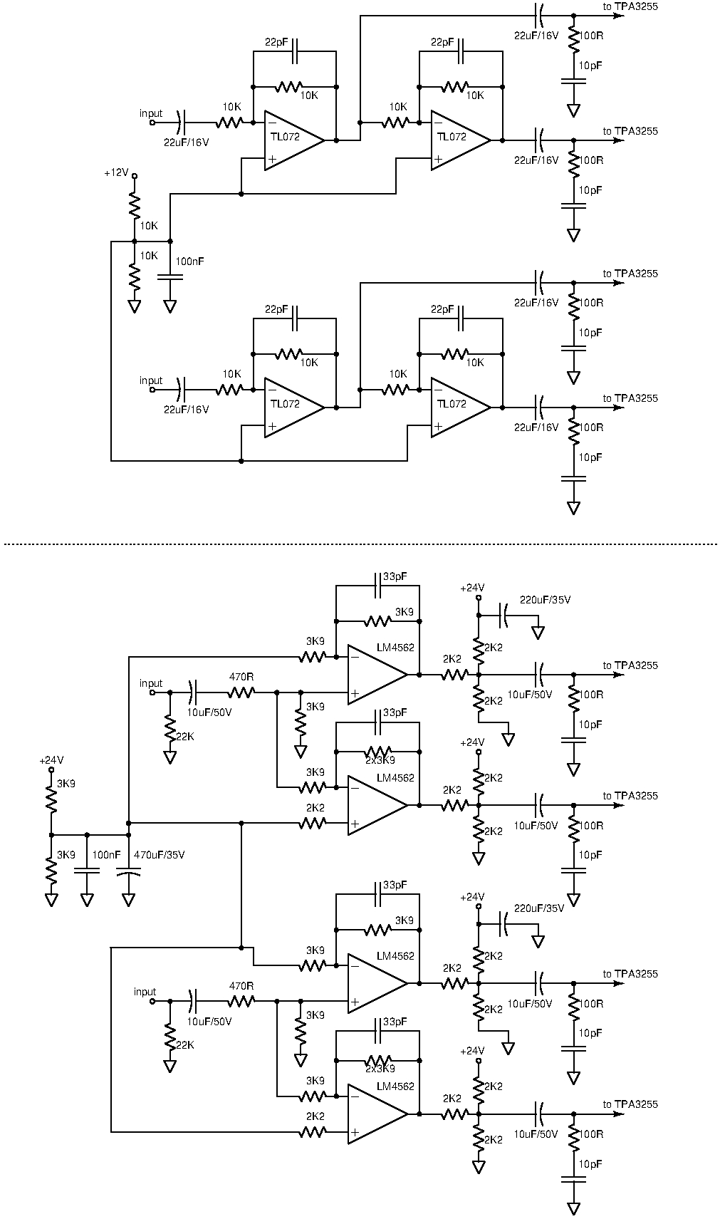

* The 12V is also used for the input balancing circuit amplifiers (creating counter-phase). Not much voltage for the OP-AMPS.

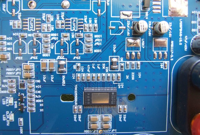

* As Chris told me, the Buck IC is not the right LM2575HVS type handling 50V but only the ordinary 40V version.
When I studied the input amplifier circuit, I noticed the amplifiers were based on TL072 OP-AMPS. Not really state-of-the art compared to the TPA3255. The input and output signal coupling capacitors were of the standard SMD 22uF/16V electrolytic type. Not recommended for quality audio use. Last, as mentioned above, the OP-AMPs were operated at only 12V total – not much and not allowing the best THD performance for high-performance OP-AMPs.

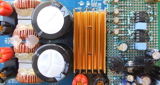

So, I removed all the bigger SMD components and implemented a new voltage regulator circuit and input amplifier circuit (shown below the dotted lines in the schematics). Cascaded LM317 linear regulators (24V and 12V outputs) and LM4562 based amplifiers operating from 24V. I arranged it all on a board put as a new input stage, and turned the power on – absolutely no sound!

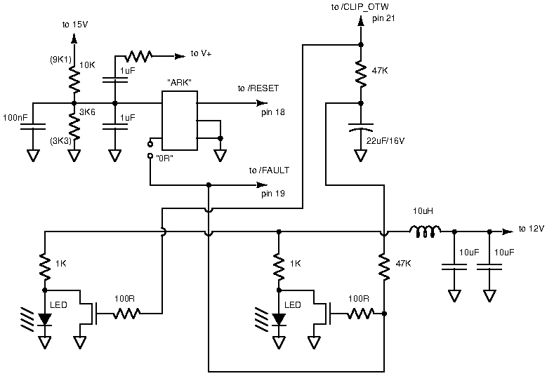

The reason was that the /RESET signal to the TPA3255 chip was affected when I removed the main components of the 15V SMPS. I drew up a schematic of the control circuit (more-or-less correct) and realized a very small 5pin IC (marked with “ARK” only) in a SOT-23-5 housing, just before the /RESET input. For a start, I believed this to be a micro-power 5V-to-3.3V LDO but it isn’t. The output voltage follows the input voltage. What exact purpose it serves here, I do not know. And, the input voltage divider (10K/3K6) divided the 12V voltage such that the voltage at the /RESET input was above 4V. The /RESET input is a 3.3V input that as absolute maximum can take 4.2V! There was a voltage stress problem here.
I put a 12K resistor in series with the 10K and connected it to my 24V supply line (resulting in 3.4V at the /RESET input). Then the amplifier worked.
How did it finally sound? - great. I could not compare with a circuit I had disassembled two days before but at least it sounds really good. The heatsinks get a bit warm but a slow-running fan brings them back to 30 degrees.

My concerns:
* As Chris told me, the Buck IC is not the right LM2575HVS type handling 50V but only the ordinary 40V version..
Concerning your concerns
* A small buck regulator with a proper pcb-layout is not a big problem. Dr.Mord and me use these from the beginning of our TPA325x boards, and never found artifacts in our high-resolution measurements.
* Agreed, I would propose some 25V-SMD-cap
* 12V should be enough. Keep in mind the voltage level to drive TPA-3255 into clipping is less than 5Vpp each input.
* agreed, LM2575 is a "budget choice".
* TL072 is often underrated by audiophiles, it is not that bad.
But also this is a typical "budget choice".
* Electrolytic caps are fine in the audio path - they definitely do NOT alter the sound. Anyway I do not like their smd variants, soldering / de-soldering them is a nightmare.
I agree the chinese most of the time try to copy the reference design, which is not bad at all. Afterwards they "modify" them to save money - often with little knowledge of the drawbacks following these modifications. Thus developped this sport of buying cheap chinese boards just to pimp them up afterwards. Obviously this is fun for the crowd involved as well for spectators of that game.;)

The TL072 was a star some 20 years ago. Today, better can be found for a low price as well. NE5532 is an example.
I use attenuators on the outputs of my OP-AMPs in order not to exceed the 7Vpp maximum input to the TPA3255. It is not that I believe 12V is not sufficient to drive the TPA3255 inputs to the limits. I noticed from the LM4562 datasheet that little supply voltage leaves less good THD performance, due to the reduced bias currents I assume. Above +/- 12V there is little to gain.
