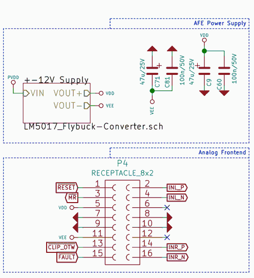

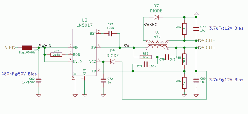

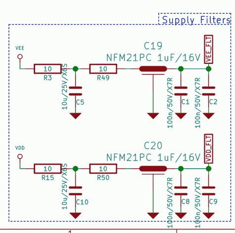

This isn't restricted to capacitance, but let me show you my decoupling path for the AFE:
Decoupling at LM5017 input/outputs:
attachment.php
This is done locally with a concentrated GND plane connected to global GND at the GND-pad of the input supply decoupling capacitor. LM5017 is equipped with LC-filter input. fSW is 620kHz.
in distance of 3cm there is local decoupling via 47uF at the AFE connector - this cap is of questionable value as it isn't effective at switchers fSW but in the audio range.
attachment.php
On the AFE module itself there's a 2 stage RC-filter with 2nd-stage feed-trough cap (X2Y) and finally local decoupling at the opamp itself.
attachment.php

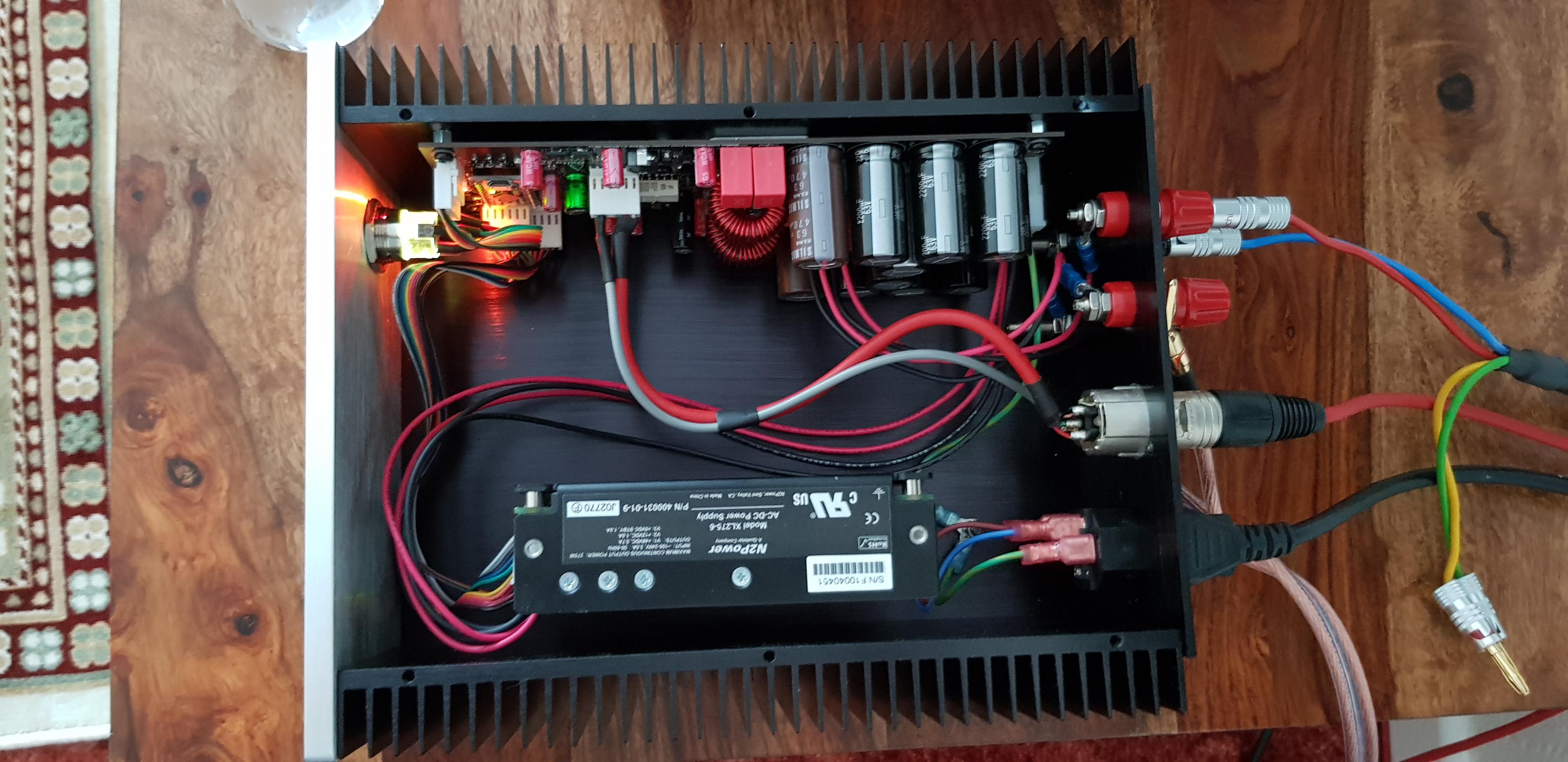

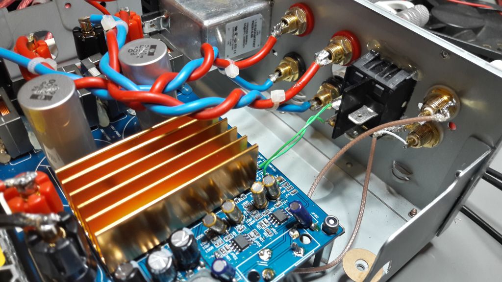

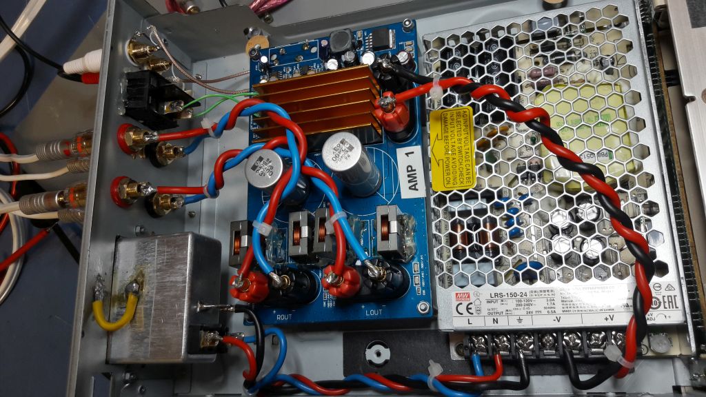

Hi
some photos from my amp light in the final installation
the amp board is still not my final.
i want to try different output filter according to the Ti designer.
as written in post #403
sounds fine.
i ordered new Ad8599...will see..

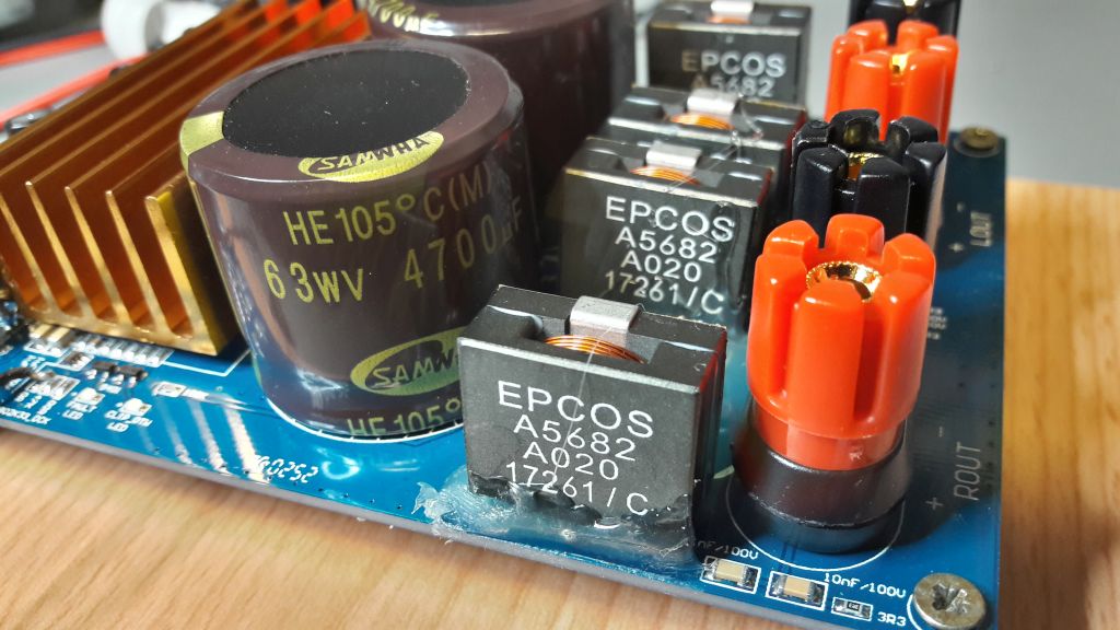

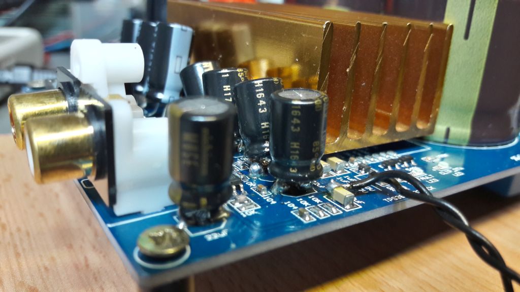

new board with muse caps
i changed the input all caps (nichicon muse = 10µF not easy because are bigger)and the regulator caps.
output caps are for 4 ohm speakers = 7µH Epcos and under the board 680nF TDK caps, original opamp ST TL072
after more the 70 hours "burn in" of this board sounds best for me.

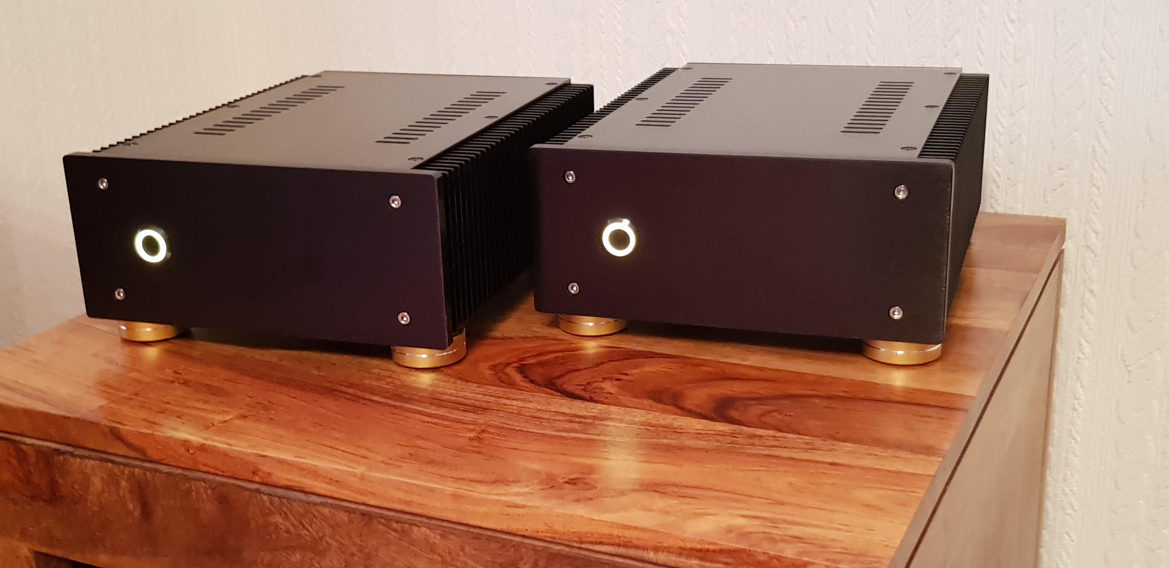

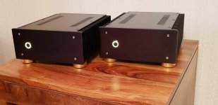

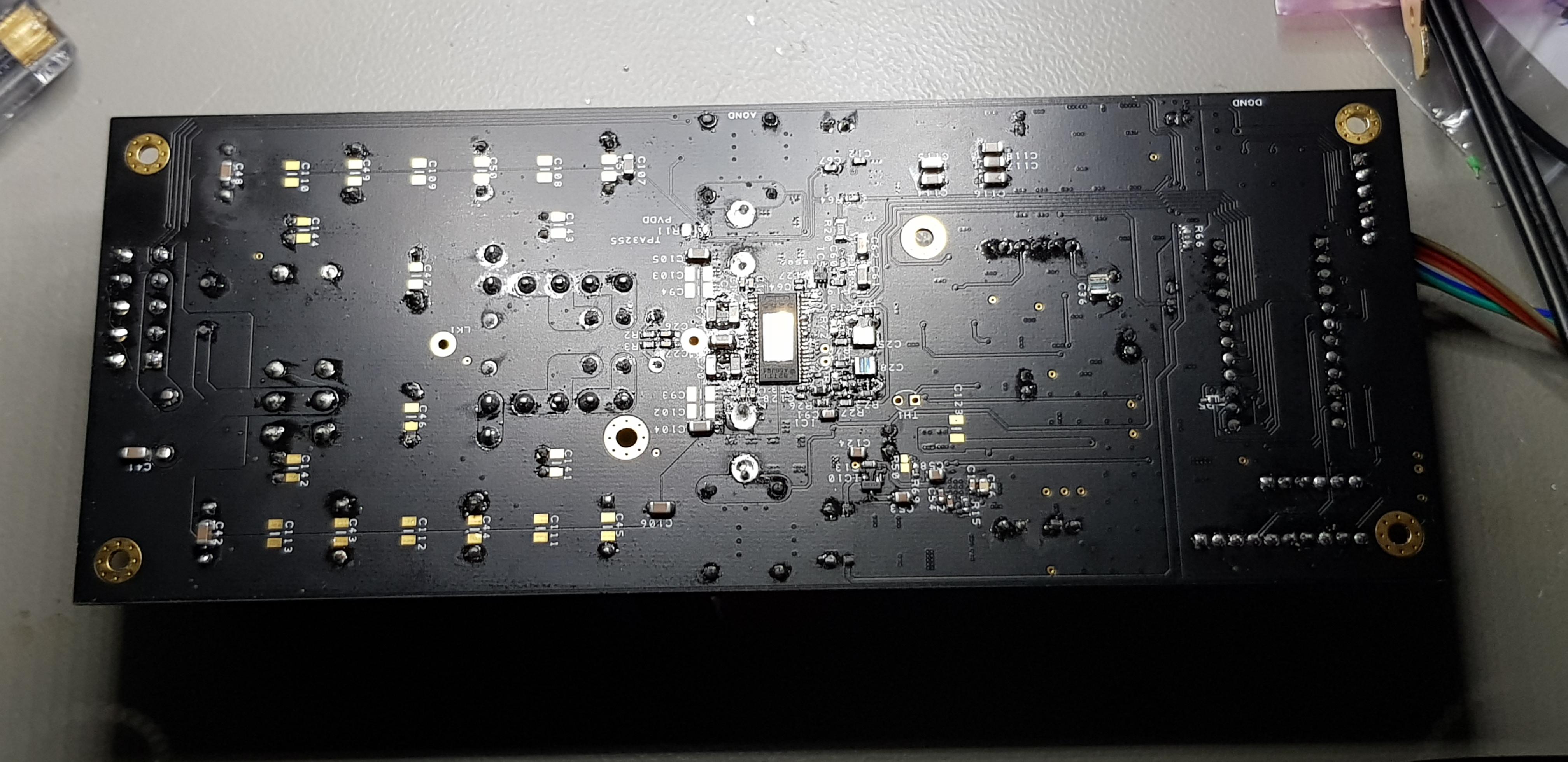

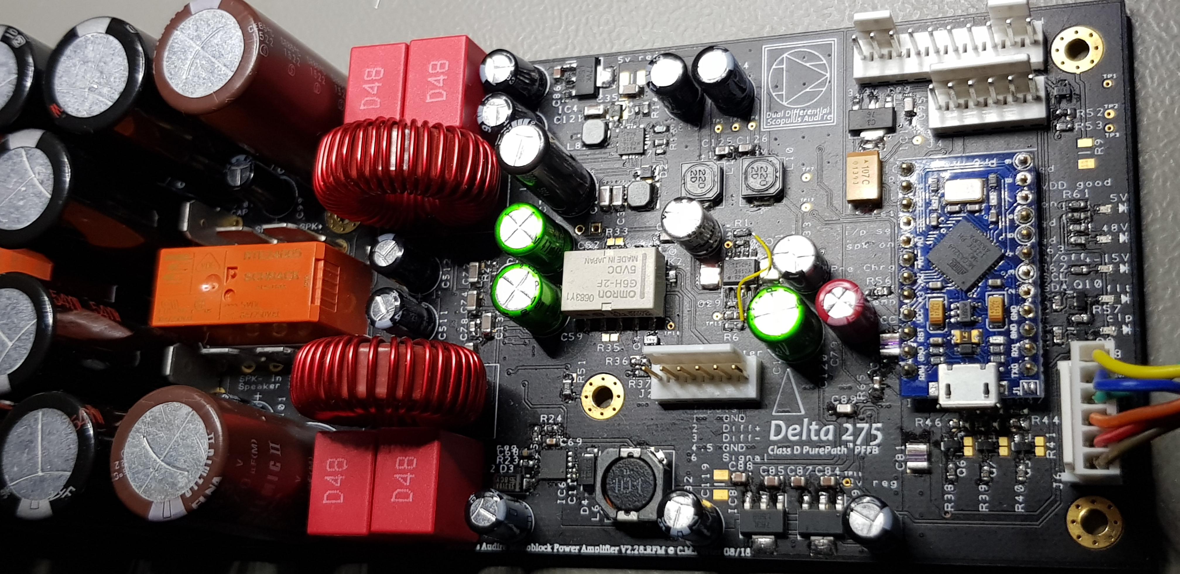

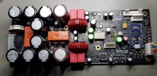

My Mono Blocks
See below my home grown TPA3255 Monoblocks.. Must admit it took me two goes to get the PCB right 😕 but boy to they sound awesome. seven months of hobby time well spent 🙂
