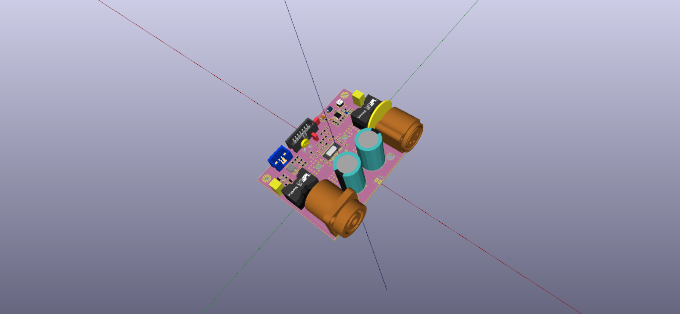

A more elegant approach is the "flybuck" converter using LM5019 or LM5017. Rated at max input voltage of upto 100V it delivers an output voltage of +/-12V for instance.
There is no additional linear reg involved.
This supplies the TPA325x 12Vinput as well as your op-amps with a symmetric supply - allowing high undistorted voltage swing and hi supply ripple immunity.
This solution does not take too much board space and works reasonably well in my TPA325x designs.

A power converter with an asymmetrical power capability. More "+" power than "-" power. Very useful for this particular application where the OP-AMPs use around the same power from "+" and "-" while the TPA3255 needs only "+" power.
I hope this kind of creativity also succeeds with the popular suppliers of TPA3255 boards.

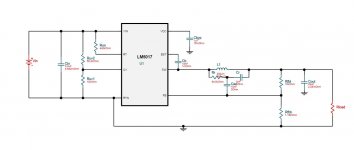

:cheers: well designed voltwide
i played with this TI WEBench Power designer.....nice tool !!! you can use smal footprint or more efficiency... for LM5017 i set the low ripple design value...see attachment
thats fine for an old man like me ;)

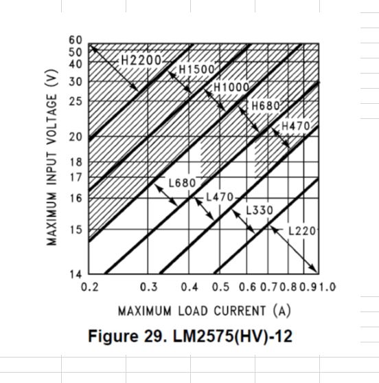

sorry to badger you both
but can you explain me the figure 29 of the LM2575 datasheet please ???
because of:
i pick up the idea from sybic mods to change the 22µH to 220µH.
FF told me 330µH is ok...its in the datasheet example too
but if i look at the Voltage x axle and i use 28V input and approx 0,2 -0,3 Amper current drawing i shlud use H1500µH - 2200µH...but there is a "black zone"
what does it mean??? or how to calculate correctl?
thank you...

2. chapter
is there a big difference of 330µH or 220µH..according to the datasheet 220µH is not correct
There is a range of inductors and capacitors you can use in the output filter. 220uH is not wrong. The rule is the bigger value for the inductor and capacitor, the less output ripple but at the same time lower filter cut-off frequency and less loop stability. When the LM2575 datasheet shows a 330uH/330uF output filter, they inform us that with the corresponding cut-off frequency the stability of the loop is fine. You can lower the inductor to 220uH and increase the capacitor to 470uF and you have close to the same cut-off frequency and loop stability.
The less the value of the inductor and the higher the value of the capacitor, the more "heavy" the filter becomes for the chip to operate because the total impedance (in series) is less. The higher the inductance, the physically bigger the choke needs to be to carry the DC current without saturation.
There are more factors to take into account at the same time, but 22uH/22uF is a filter with a strangely high cut-off frequency and high output ripple.
because of:
thank you...
