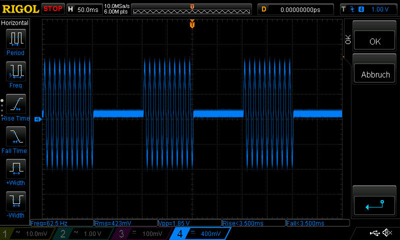

...loop reaction at SMPS
following the advice by FF post #357

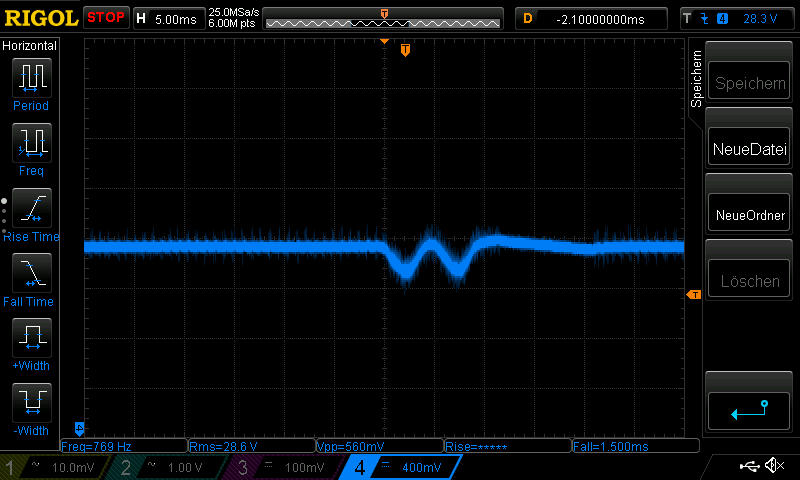

(Amplifier specific) Use the amplifier with the intended (dummy!) load. The test generator (input) must be able to run in "burst"-mode. Adjust the test generator burst amplitude such that the amplifier output is at a defined output power level. Suggested 50% of full output power and 100Hz frequency. Then run no input signal <-> input signal for defined output power and watch how the SMPS output voltage sags every time a signal burst starts. The response time is the time until the voltage no longer sags.
i try to made a burst on my freq.generator with 700mVrms and 100Hz into the amp. amp is loaded with 8R both channels.
smps is the LRS150-24 set to 28,7V
with 1cycle burst its not strong enough, because i get just shortly about 300mA out (DMM shows this)
with 10cycles i got between 300mA and 2,3Amps DMM
with 5cycles i got 300ma to 1,4amps out
is the reaction time about 20msec? at 10ms overshoot and at 20ms back to the voltage? ....pic 2
pic 1 input voltage 10 cycles 700mVrms 100Hz
pic 2 1 cycle differential probe directly on V+ and V- of the smps
how to intepret the other cycles? which reaction time

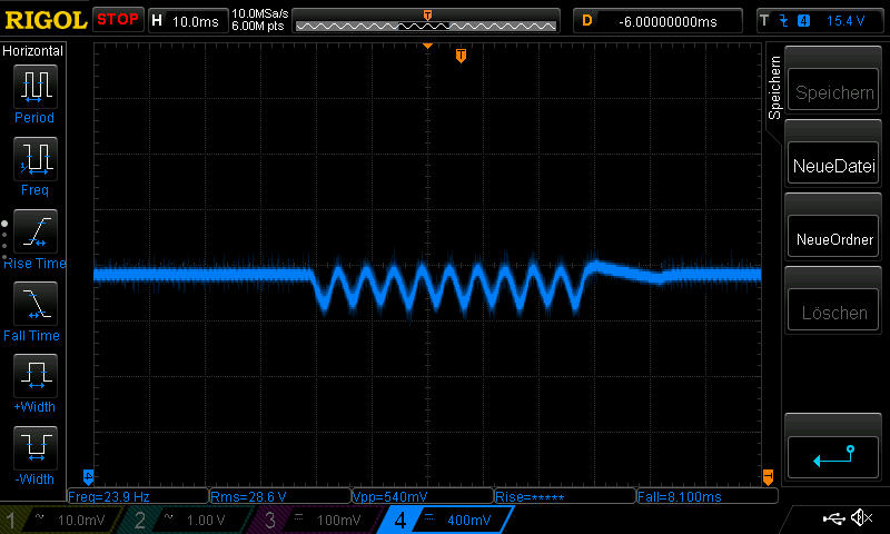

pic 3 5 cycles

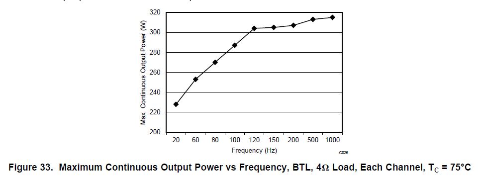

pic 4 10 cycles

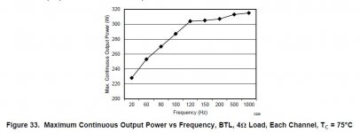

I would not care about 0.5V peak-to-peak around 28V=![]()
ok. i want to know are these measuremnts technical ok. i could play around the burst mode with delay and cycles to push the smps harder-the input freq. could be changed from 100Hz to something that hurts = 20hz...
see datasheet figure 33
this test is done at an original board with this big fat strange ESR caps (elna or sanwah)

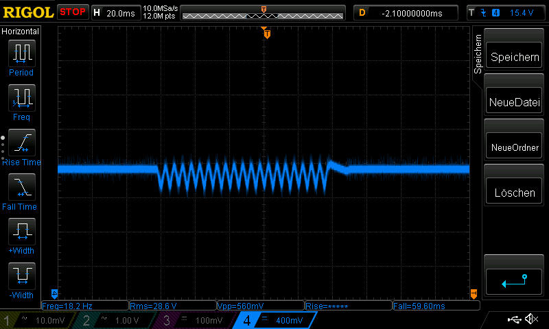

Good work, Chris.
You can see the signal-bursts causing important disturbance of the supply voltage. The SMPS loop is (slowly) trying to bring the voltage back but the change in load current is constantly bringing it out of balance. My impression is the power line decoupling is preventing voltage swing the most and the loop is rather slow.
The loop reaction time is normally measured with a single load-step. For instance a 0.5A->2A load step which will cause the output voltage to drop for a start. When the loop has managed to stop the drop in voltage and started returning it to rest-value, you have a measure for the loop reaction time.
A variation in the supply voltage will affect THD but will in part be compensated by the amplifier regulation loop. As Voltwide concludes, do not worry too much - it is inherent in the supply design.
