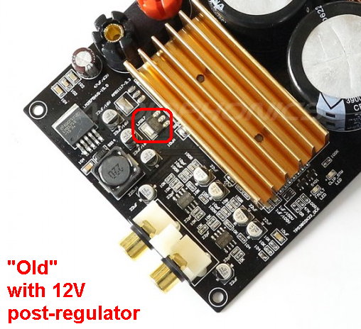

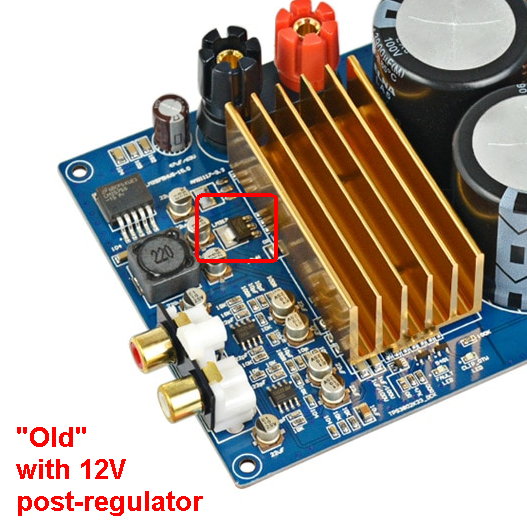

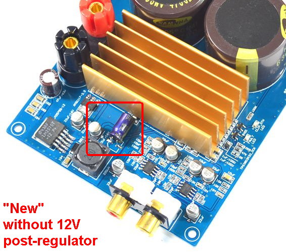

What is wrong with TPA3255?
Newer versions skip it, like this one:
New:
NEW DC48V LM2575S 12 TPA3255 300W + 300W Class D audio Digital Amplifier Board-in Amplifier from Consumer Electronics on Aliexpress.com | Alibaba Group
attachment.php
Old:
attachment.php
attachment.php
Image-Source: TI Purepath HD 150 Amplifier Module Class D TPA3255 2x110W 8 Ohm - Audiophonics

Hi
the regulator is according to doc a version which is not able to keep the technical specification of the HV version- same chip- same production line....so it could be ok but without garantee. i would not do it.
try to adjust your power supply with the variable resistor on it.
chris
i am sorry. i miss match the versions
T version-> fixed output voltage - 40V max.
S version - adjustable output - 40V max.
HV version > 40V
chris
