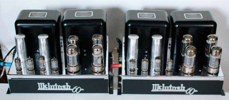

mcintosh chrome
Best chrome plate in the industry. The tube amps had 3 lb (est.) output transformers, 3 times the size of a Dynaco ST70. In a world where bass sells iron, before transistors, McIntosh was the best I ever heard. In a world after transistors, I doubt if a tube Mac ever blew up a $500 speaker. It would take a vast lightening bolt to get through all that iron. I've always spent 3-5 times the amp cost on my speakers, and I'm a bit sensitive about blowing the speaker. I'm sitting here today, watching my transistor ST120 throw welding sparks from the ring the R27 resistor is soldered to, to the 6-32 nut clamping it down to the output transistor collector. (Infinity ohms). And most of the other transistor amps connect this point directly to the speaker?

Thanks for everyone's thoughts on this! So it seems the general feeling is that the design/circuit is nothing to change the world, but McIntosh used good quality parts, made it look great, and built it like a tank. Am I correct? It seems that turned out to be a recipe for success as far as they're concerned.
With all due respect to everyone who answered... I think maybe you have missed some things...
The thing that made McIntosh's reputation is twofold:
1. they were the only manufacturer to successfully employ a cathode winding in the output transformer on a commercial basis.
2. they also made some very high power tube amps using the same output stage technology and a bootstrapped driver. I think one of them was the K-104. I think it used 8005 output tubes...
So, what was it that made any of this special?
Read the chapter in the Radiotron designer's handbook on the McIntosh "design". Many other designs were suggested that used cathode coupled output stages, but none were so elegant as this one.
What it did in one shot was to reduce the primary impedance so that the usual problems in output transformer design that forced a rather limited bandwidth went away. They could get ~100kHz. The other thing that worked nicely is that in class B the crossover notch distortion (iirc) was minimized by the "carry through" of the iron.
The original McIntosh amps did not have multiple nested feedback loops, as far as I can recall.
The big problem with the McIntosh design is that the output stage had "unity gain". That meant that the driver has to swing whatever the output voltage swing (on the primary) happened to be! That is extra swing compared to an output stage that has gain. Sounds familiar to solid state amp aficionados?
This was a major problem in the big amps like the K-104 (it was also made under another model number but it escapes me at the moment) because there was almost 2kV on the plates! The solution was a neat "bootstrap" of the driver tube where it is lifted by the output. Of course keeping that arrangement stable is a bit tricky, but they did it. A worthy schematic to find.
I've seen examples of this amp running, and the 8005s run with the plates cherry red - kewl because these are nude nickel plates!
Unlike many competing amps of the day, the McIntosh's square wave response does not have the typical ringing due to the feedback trying to keep the sagging HF response up (the iron is rolling off), the square wave was nice and clean, usually without any overshoot at all. Clean.
I have a 50-W on my bench - it has an interstage as well, and it is very clean. The Mc30 that used to inhabit that spot was the same.
So, the McIntosh design is/was special, imho.
