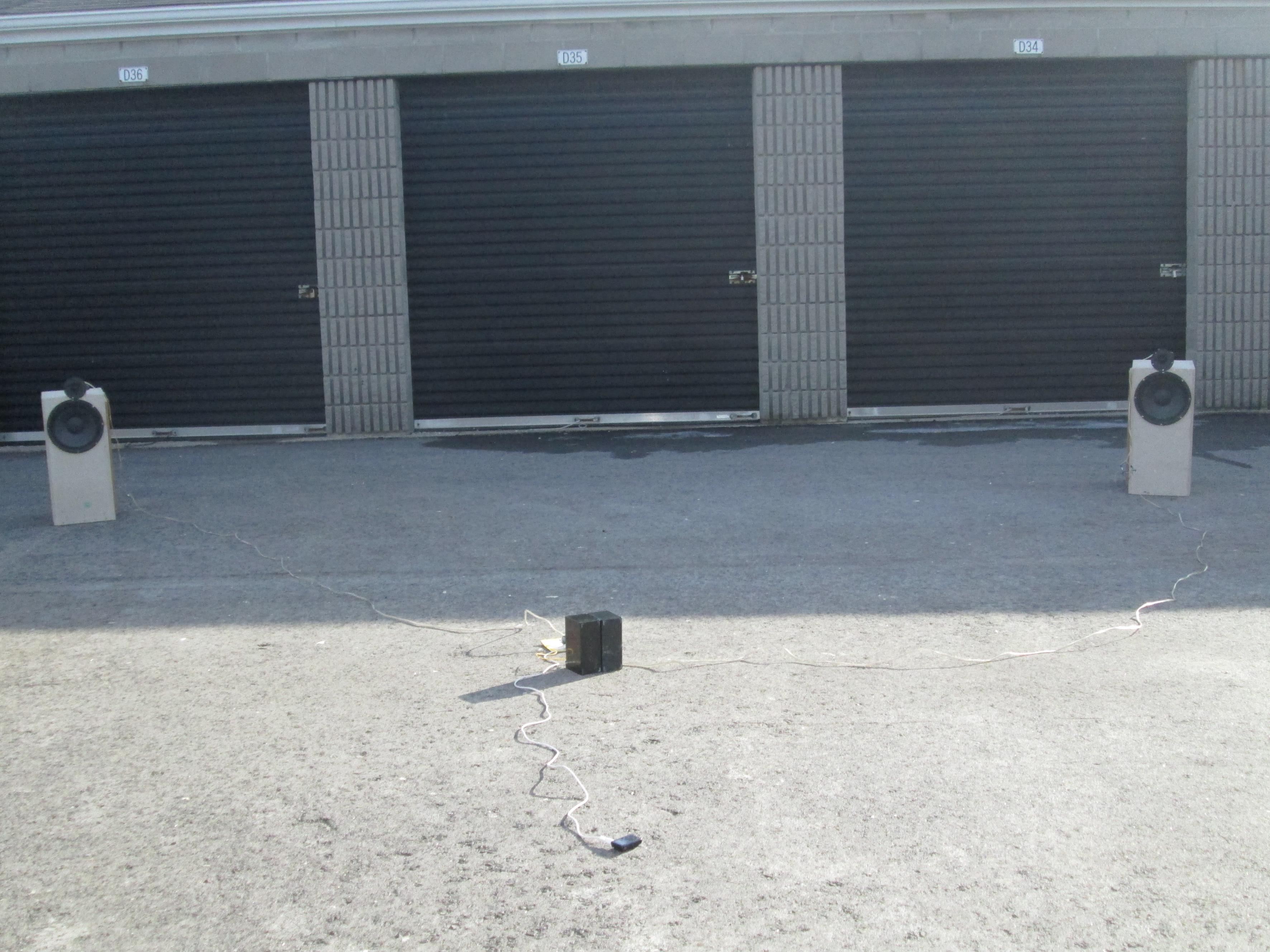

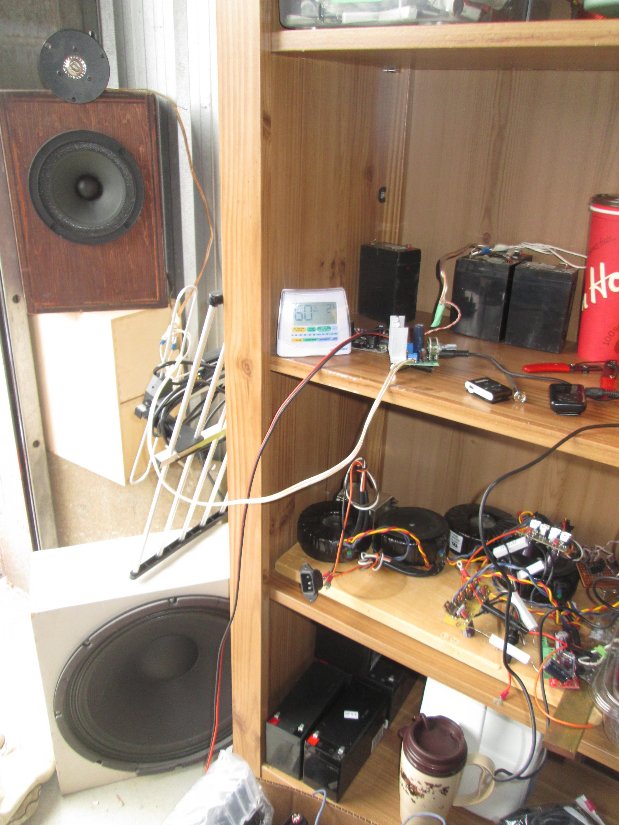

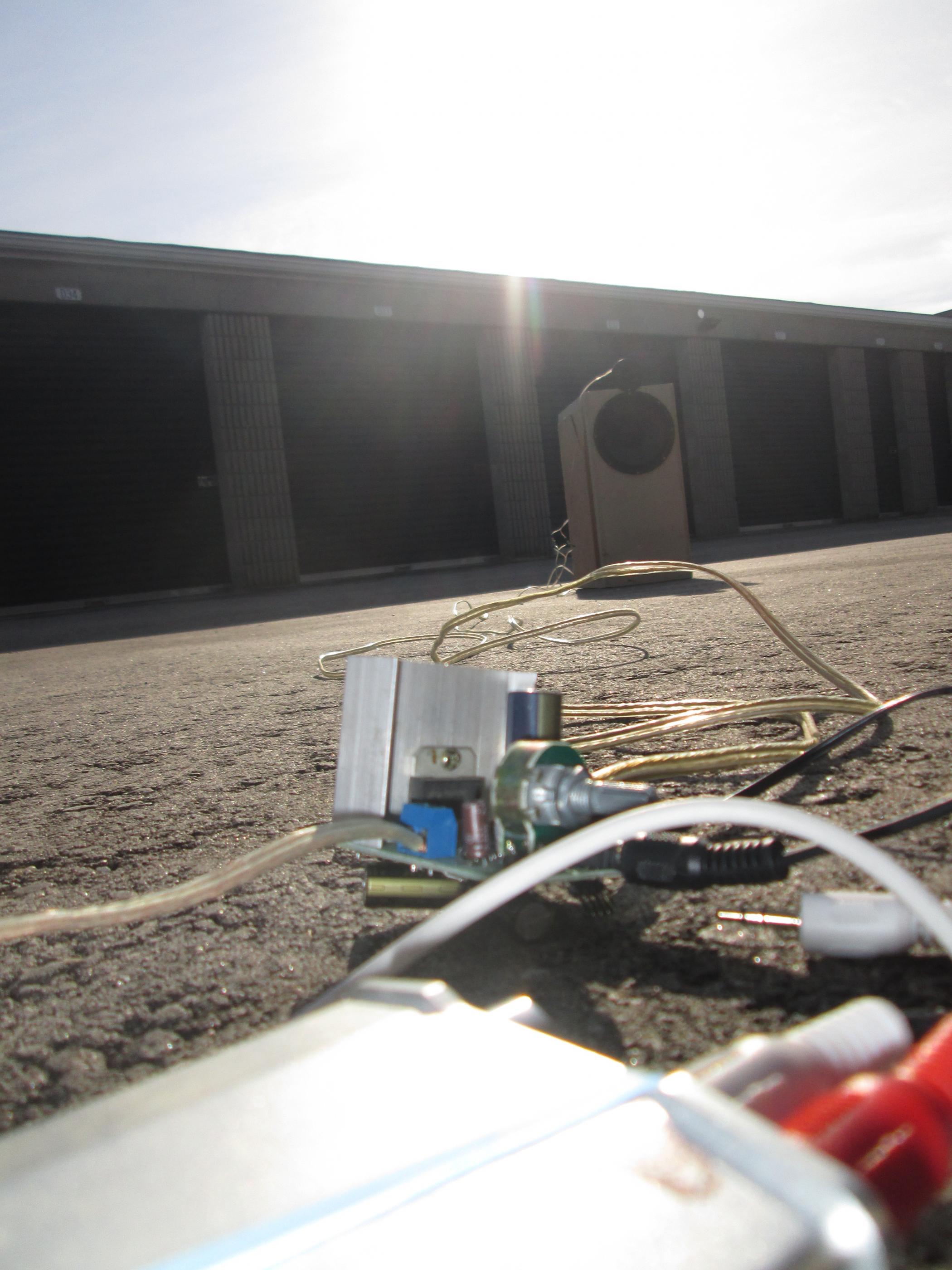

Lunchie rockin (2 x 12V SLA) the storage locker 😀
[w Beta15, PR170, St8 tweets]
[at a chilly 2 o C, 35 o F]
Lunchie rockin the storage area (eventually got me 'silenced'! ... because ...)
... and I quote, from mangmnt, "No, no, no, no, no, no! No partying going on here!" [With 2 x 12V SLA batt!]
Lunchie in steree-ereo!
