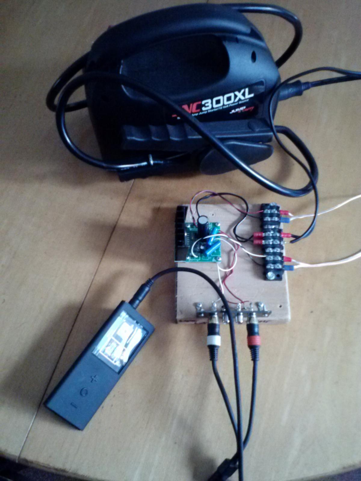

While waiting for my gmarsh Wiener TDA3118, I put a mildly hot-rodded TDA7297 to use to audition some Klipsch Kg4s from Craigslist in Troy, MI. The small amp, battery booster and Pono player make it easy to listen to speakers that are not in a system.
Dave Brubeck's Take Five and Eric Clapton Unplugged sounded very good from the Kg4s.
I didn't buy them. They were too nice, almost mint. I'm not looking for furniture. The seller is asking $300 OBO and should not accept much less, which is more than I was willing to pay.
