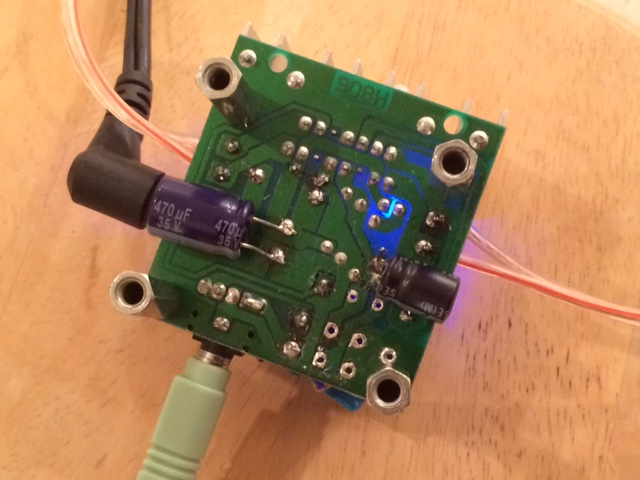

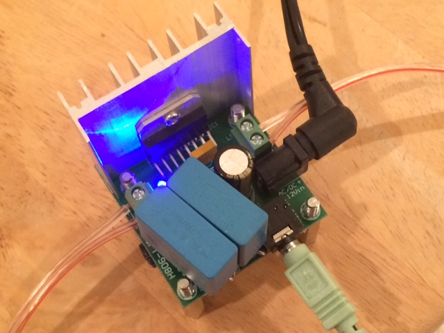

Founder of XSA-Labs
Joined 2012
Folsom Mods
I followed the mods by Destroyer OS (aka Folsom) suggested as much as possible. I did not buy any new parts but scrounged all this from my existing or salvaged parts bin. I am using an ENEC 1uF X2 MKP 305V cap bypassed with a 1800pF 250V axial MKP film cap which I also used for its long legs. Panasonic FM 560uF 35V (top) and ECA-1VM471 470uF 35V (bottom), Nichicon 100uF 25V in place of the the little 10uF electrolytic (what is that for? Are you saying it's not needed?). I replaced the 22nF ceramic bypass with a Milspec AVX 104 100V box film cap. I got rid of the pot, but decided to keep the power jack and 3.5mm jack for convenience. Got rid of the diode. Swapped the terminal blocks for higher quality (green) ones.
So it sounds pretty nice - I think the bass is more decisive and mids have more clarity.
Top view:
Bottom side:

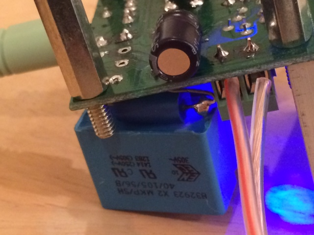

Detail of ENEC 1uF and 1800pF bypass cap, and new terminal blocks:

The small film cap is very bad for sound. You can literally hear the ringing stop if you remove it. (you can just wiggle it till it's off) The treble will be much easier to listen to without it.
The 10uf is needed to keep the mute/standby from turning on. It's not very important in terms of quality at all.
1uf input caps are a little small. If you want good bass under 100hz, down to 20hz, you'll need to up it to something like 1.5uf.

I believe I changed it to 1.5uf. The corner frequency says 1uf is good, but listening shows truncated base with only 1uf.
The .22nf cap rings with the capacitance that comes before it most likely, not the chip. What I'm saying is it's not just a minor argument about best practices, but rather that it's very audible and bad.
100uf on the mute/standby is causing no harm. There wasn't a reason to change it before, nor one now. :)
Do not replace the small cap. It causes directly audible ringing.
There's no reason to jumper the diode holes.
Bypass the pot if you don't need it, it's junkie.
