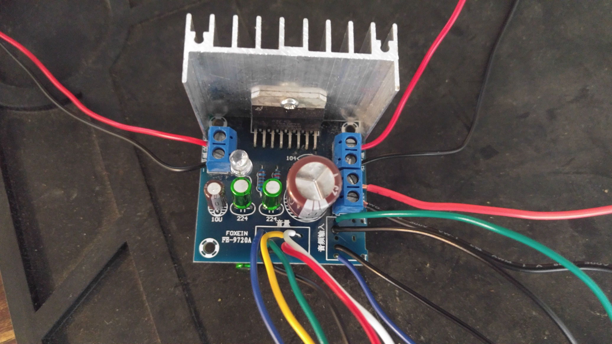

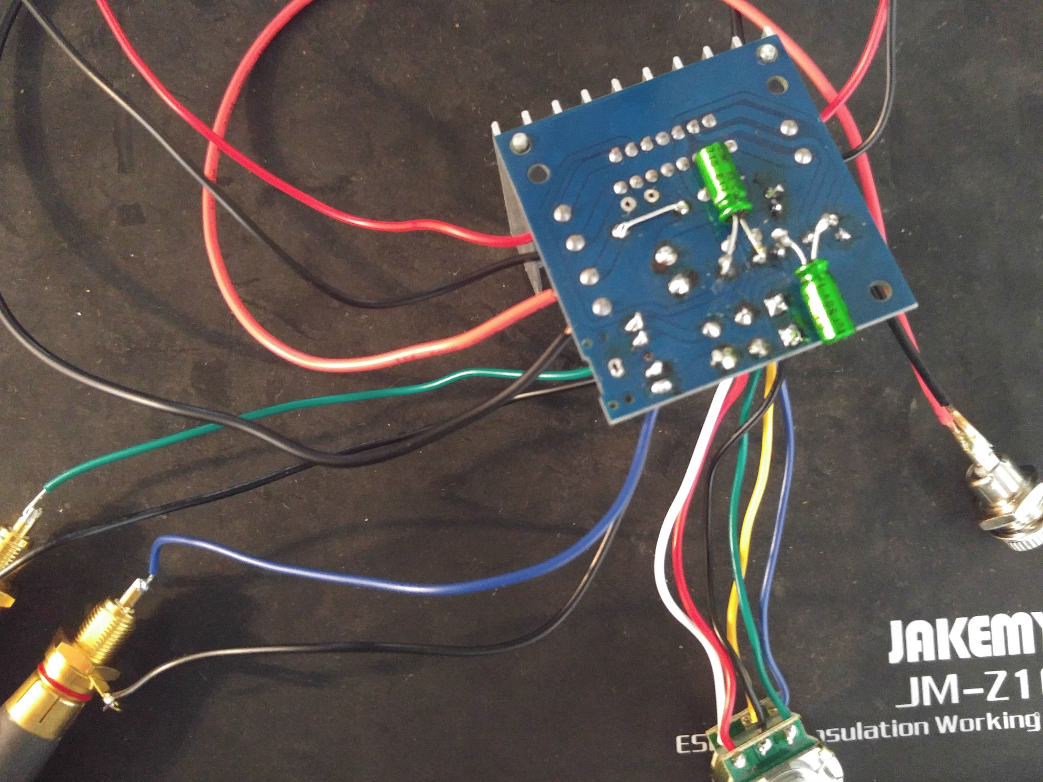

LED comes on! But I only get hum coming out of the speakers (I can turn up the volume of the hum). Was trying to follow DestroyerOS ver1 build guide. Does anyone see anything out of place?
Thanks,
Doug
