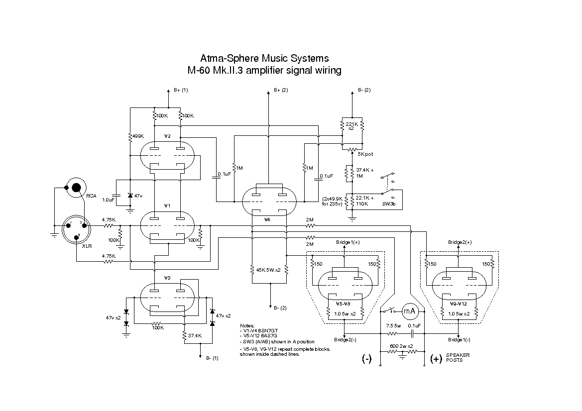

Right. This schematic is copyright by Atma-Sphere Music Systems, Inc. but you can use it for your personal projects. As always, all rights reserved and all that stuff.
The B+ for the power tubes runs about 135-140V. B+ and B- for the driver tubes is +300 and -300.
The place to start is to work with only a pair of power tubes and get the amp running, then wire the rest of the power tubes. The other elements of the circuit, driver, power supplies etc are the sort of thing you run into with a lot of amps, so no issues there. The nice thing about this is there is no guesswork to get the OPT right- there is none. I often run the amplifier with less than the full complement of power tubes. You will want to provide enough room on your chassis to space the 6AS7s about 3 1/2" apart (center to center) at a minimum.
This circuit does not use much feedback- about 1 db. If you want more, you are going to have to have more gain in the voltage amplifier, perhaps even an additional gain stage in front. If you want my advice, don't do it! Instead find a speaker that is easily driven by this amp without feedback. It **will** sound better.

As I mentioned earlier, you do not need any special speaker protection circuitry, even a fuse, as long as the primary for the output tube B+ is properly fused. For 6 6AS7Gs running at 135V that will be about 2 to 2.5Amps slow. We've been building these things for over 33 years now and if they were eating speakers we'd be in a hurt locker. We *have* seen a few problems; almost all of them have to do with people putting a different power tube type in the sockets of the amps! So eliminating those incidents, overall we have seen one driver damaged in 33 years and 1000s of amps. In that case the cone shattered but the voice coil was fine. So a crowbar or the like seems like overkill to me.

Markus, running 4 6AS7s per channel seems to be in the 20-25 watt range.
There are several ways to determine output impedance, apparently based on what you believe in. I'm not a fan of what I call the Voltage Paradigm as it tends to lead to the use of negative feedback in a lame attempt to get the amp to look good on paper.
Gentlemen, what looks good on paper has little to do with how we perceive sound. The bench specs measure things that are not important and for the most part ignores the things that are.
So I measure output impedance by seeing what its actual impedance really is. Most techniques used by the Voltage Paradigm are actually putting a number on the servo gain of the feedback loop. Feedback enhances the odd orders used by the human ear/brain system to measure the volume of a sound, if we tamper with that the system will have a false loudness and a brightness. If you want it to sound like real music feedback has to be avoided. Consequently the method of measuring the output impedance looses is value as soon as the feedback is reduced or eliminated.
We have used this formula from the Radiotron:
2Rp/u + 2
where Rp is the plate resistance of all the power tubes in the circuit, as they are in parallel.
In the case of 4 power tubes this comes to 33.75/4 or 8.44 ohms. In practice our measurements come well within 10% of this formula.
If you use the Voltage Paradigm rules the 33.75 ohm value is what you will get. FWIW as I write this I am listening to an amp that only has 3 power tubes per channel, and its driving our test speakers (High Emotion Audio Bellas) quite well. Obviously a high damping factor is not all its been cracked up to be. I think that myth was started to sell the Voltage Paradigm to the public, and they bought it hook line and sinker. We all paid a price for that too but now I'm way too far down the rabbit hole...
