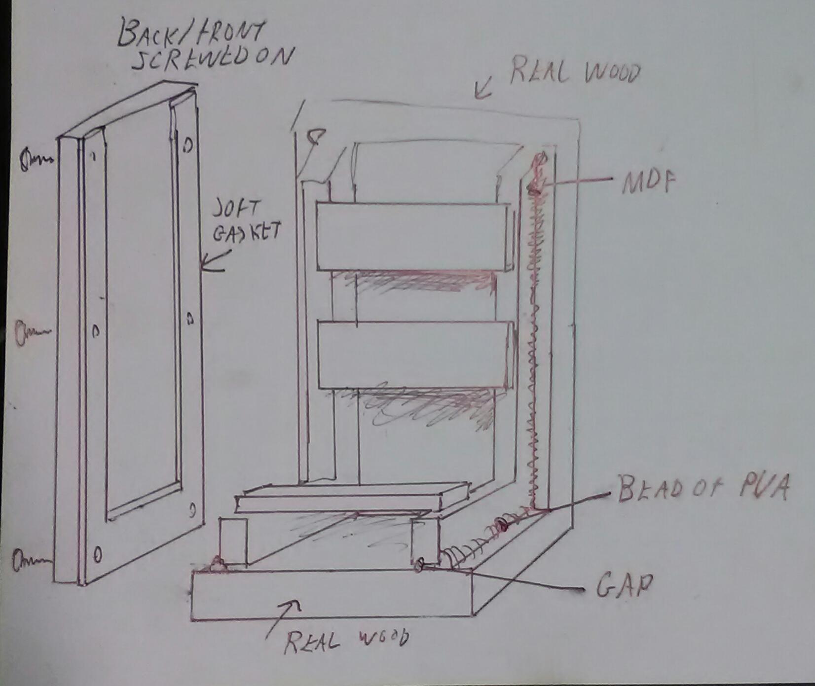

I’m going to have my cabinet maker make me some nice BB boxes with beech battens. I heard original in-house BBC boxes were 9mm all around vs 12mm side walls and 9mm front. I’m going to make mine with flush mounted front drivers though as my Xo is based on that. Should look great.
If you're going to get some cabinets made can I recommend something like the attached image, the combination of using MDF with a ( tiny ) gap between the sides/top and bottom and a thin bead of PVA gives a very damped box, the " ladder rungs " glued to the MDF help to diffract the internal sound. I've used cork between the front baffle and box ( held on by tension springs ) and foam between the rear panel and box ( screws ).
Thanks for the construction tip, Cracked case. So you are saying that you don’t want the battens solidly glued to the walls but only on the edges and that helps the dampen vibrations? I was going to apply butyl sheets on the inside already and was thinking the framing is needed to strengthen the 9mm ply box. Although of flush rebate mounting the drivers, 9mm is rather thin.
I read somewhere that when someone was testing a batch of the originals they found that one sounded better than it should, upon investigation it was found that there was a badly glued joint between the sides and battern, they even considered badly gluing them in production but dismissed the idea because it would be difficult to " badly glue " consistently. This is reminiscent of when testing race engines ( I think at Coventry Climax ) it was found that one engine produced more power than it should, and it was found that it was out of specification and the piston was making physical contact with the head at TDC causing a " super squish " during ignition. So yes, have a gap and bead of glue. I wish that this thread had been around when I thought about doing a homage myself, as the considerable expertise here would have been very helpful, I gave up on the drivers and crossover in the end and just used two full range car speakers wired in series with a cap across the bottom one.
This may have more to do with allowing the panels to vibrate more like tone wood walls on a guitar than actually dampening the vibrations. Is the rear screw mounted wall critical as well? Sounds like it might if fitted with a soft gasket. These are all very fine points. The production LS3/5A’s had glued on back panels and solidly glued beech battens, screw mounted front panels, 9mm front and 12mm everywhere else.
I wonder if the in-house BBC units with all 9mm walls sounded better because of the extra tone wood effect?
No, they don't vibrate like a guitar, quite the opposite, they're very dead, they also have rubber sheet ( carpet tile also works ) glued to the sides. I think the difference between the real wood and MDF also helps. A magazine did a shoot out of Ls3/5a remakes and two best ones had screwed on backs. Previously on this thread there should be some pics of the ones I did, you might be able to see the triangle beams that I used to stiffen the sides, and give a non flat surface for sound to bounce off.

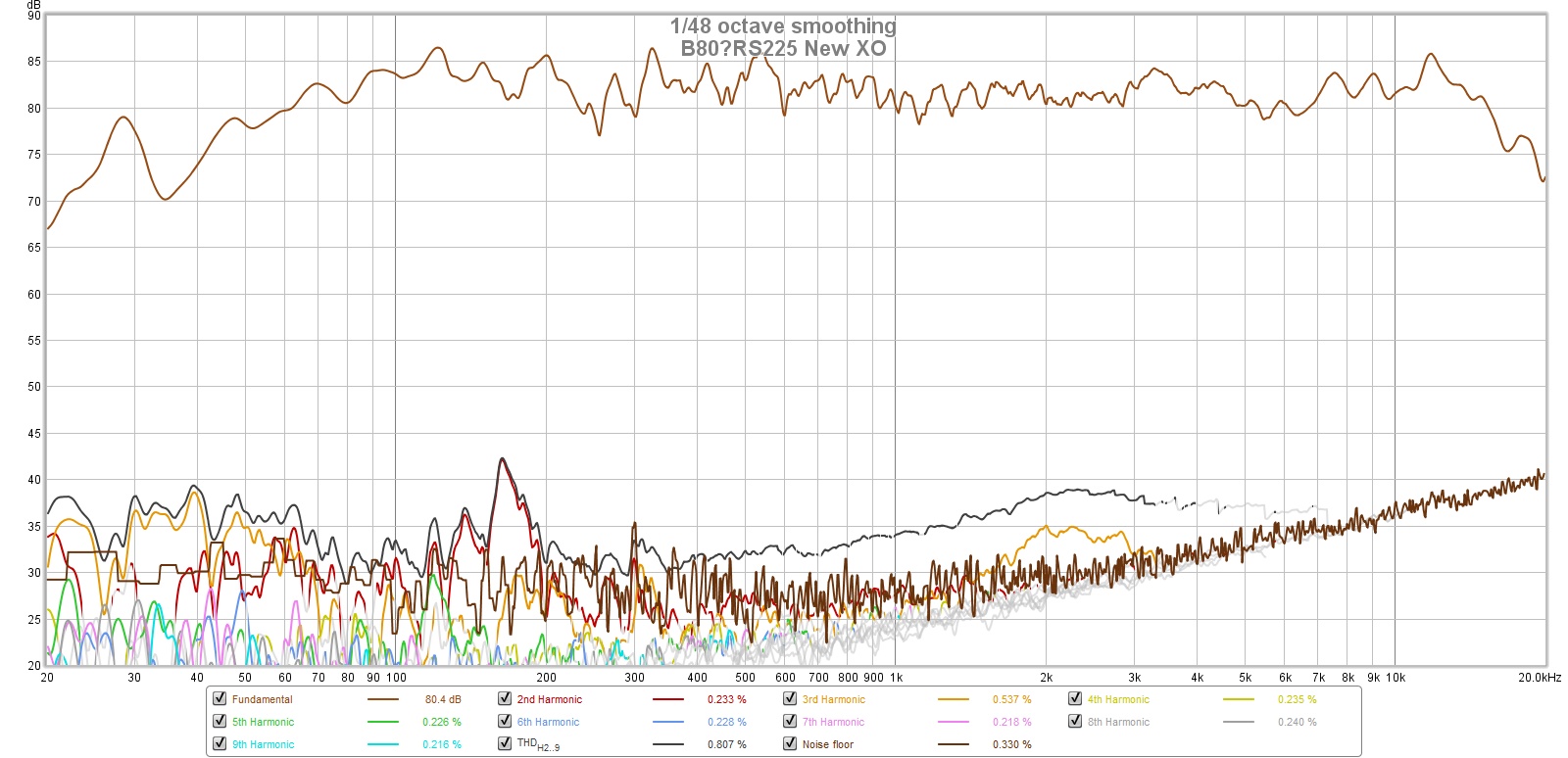

There are exceptions to the metal drivers. The RS225-8 is aluminum and special - I love how it integrates nicely using a transient perfect first order XO near 1kHz. Very smooth and low distortion with nice clean midrange and articulate bass. I have not found a replacement for it at any price or any other brand.
For example: 1st order XO with B80 at 1kHz
