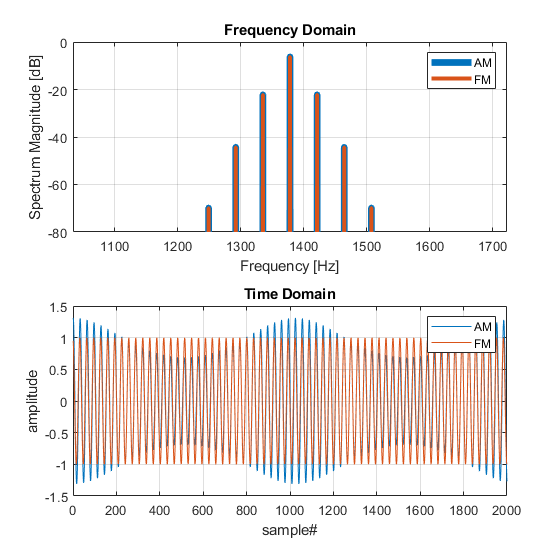

Doesn't look right at all. Should look like the spectrum shown in the article with a carrier and modulation sidebands (looks like your FFT bins are too wide to resolve the separate frequencies):
Sorry, you are correct. I have a new PC and didn't increase the default 2K FFT size in Sound Forge. But even when set to the max 64K the FFT displays are different. And they don't look anything like you and that web site show. Try it yourself with whatever audio program you have.

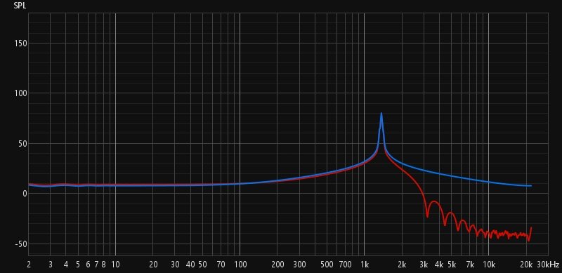

Right. They will look like this. Which is an insignificant dif imo. The time domain is obviously the measurement to look to.
Wrong windowing, looks like now. Will it work with no window? Do you know how to tell from looking at the wave files? What you do is loop them, if you know what that is. If the tail end of the file meets up smoothly with the beginning of the next looped version, then probably good without windowing. In fact, windowing is just needed so that there are not abrupt discontinuities where the beginning and end of the file would line up if looped.

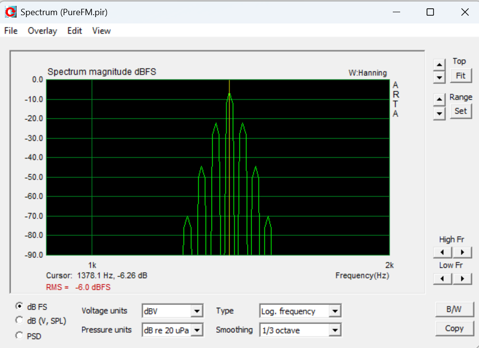

Here is a spectrum of one of the files downloaded from Purifi example page, as viewed in Arta:
Here is the spectrum shown in the Purifi example:
They look about the same in terms of displayed frequencies, as they should. Don't know why other software doesn't seem to be able to get the FFT settings close enough.
Purifi blog page url: https://purifi-audio.com/blog/tech-notes-1/doppler-distortion-vs-imd-7

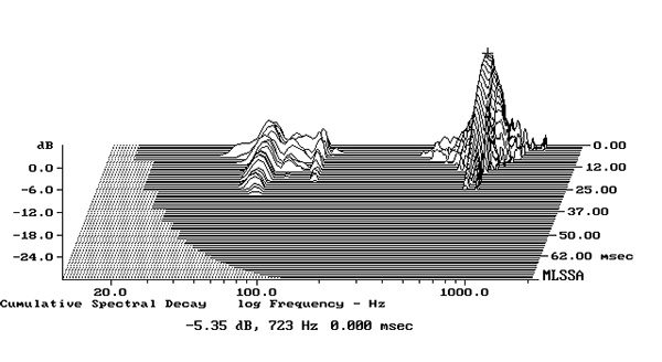

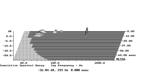

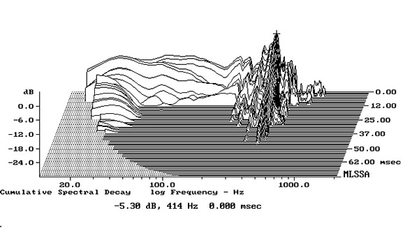

Mechanics stethoscope is a very quick tool to detect excited resonances and also is not expensive. Play music loud and listen to the speaker panels (or whatever). Will give immediate qualitative data. Quickly tells you where you have problems.
Quantitative measurement takes more time, effort, and tools. Laser inferometry or an accelarometre attached to a panel. The latter only samples one point at a time and will add a mass (Stereophile has lots of examples). The former can scan enire sides.
Examples from Stereophile shown here, but remember, it is just one spot on one cabinet wall.
I have speculated that a mic capsule could be stuck into the stethescope tube and get some quantitative data.
