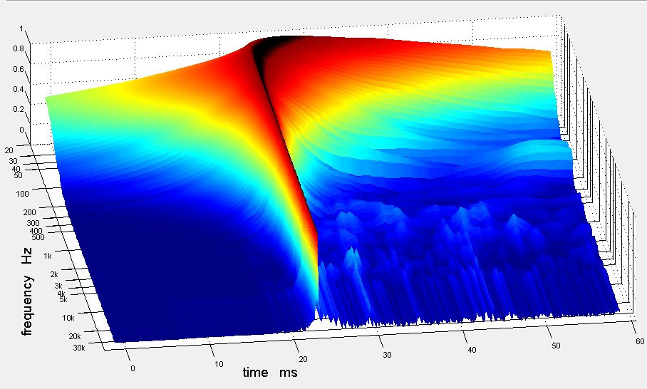

Ok, so "coherent" is the same as flat phase response. Good luck with that.The first loudspeaker is coherent, the second is not.
dave
That’s why we like a linear response plot eh?
Both amplitude and phase. Both of those could have flat amplitude response.
dave
Thanks for this which fits to some degree although the wideband enthusiasts I have chatted to offered no technical explanation and were referring to something they could perceive. Perhaps they weren't referring to a particular aspect of the sound they could pick out and identify but more having faith that the overall "good" sound they were hearing was due to "coherence". I am still baffled by the attraction of wideband drivers but this adds to the pot of knowledge which may eventually lead to a better understanding. Thanks again.
Having said that it seems to be more of an argument against wideband drivers rather than for them. A wideband driver will go deeper into the mass controlled and stiffness controlled operating regions with their relative time lag and lead compared to drivers operating over a narrower frequency range. A multidriver speaker that is designed to minimise "coherence" as a feature would appear to be preferable? Of course signal processing could be used to address the issue in wideband drivers as well as multidriver speakers but wideband driver enthusiasts rarely seem inclined to use signal processing.
Of course the modest lag/lead in time of different frequencies with a wideband driver is not audible because of how the cochlea works. The modest lag/lead introduced by most reasonable crossovers isn't audible either but could be addressed if it was considered profitable to do so. At the lowest frequencies the relative time/phase shifts in some speakers can become perceivable (though it's importance is debatable) and so it isn't a complete non-issue.

Can you provide examples that don’t need DSP for aligning in time? I have yet to see one.
Post #104.
On SystemXXX serie Tannoy used analog allpass cells (in serie) to solve the issue seen in link in post 104.
You can see the circuit in first post here:
https://www.diyaudio.com/community/threads/tannoy-system-800a-crossover.336733/#post-5768150
No dsp, all analog.
Tannoy drivers used in the revolution XT 6, and some Kef drivers don't need compensation for Z axis. In big diameter B&C have some claiming same thing.
