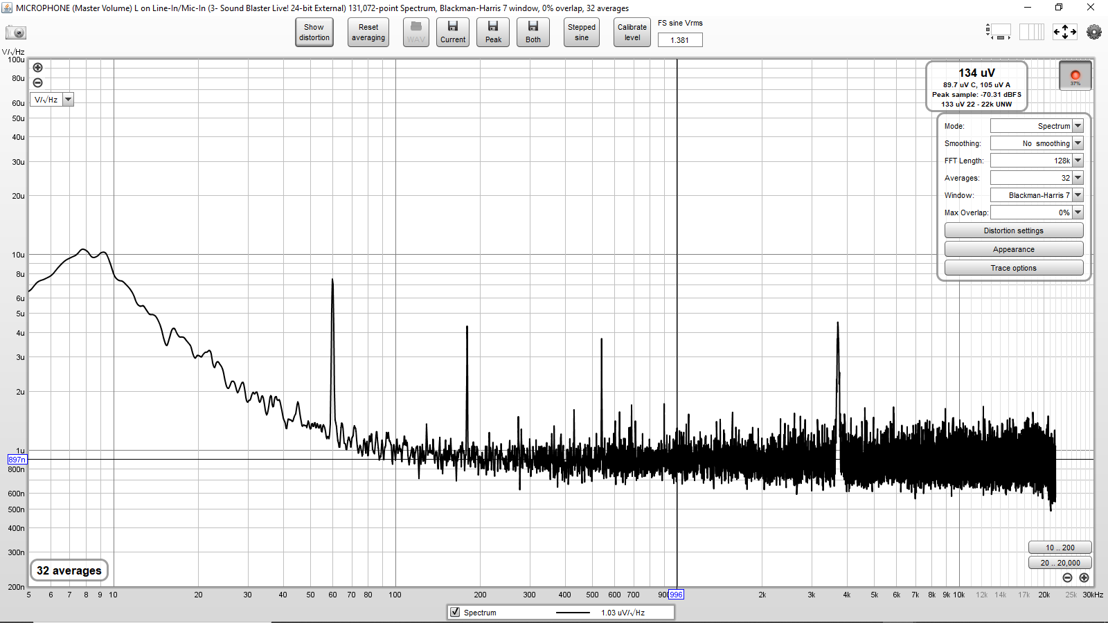

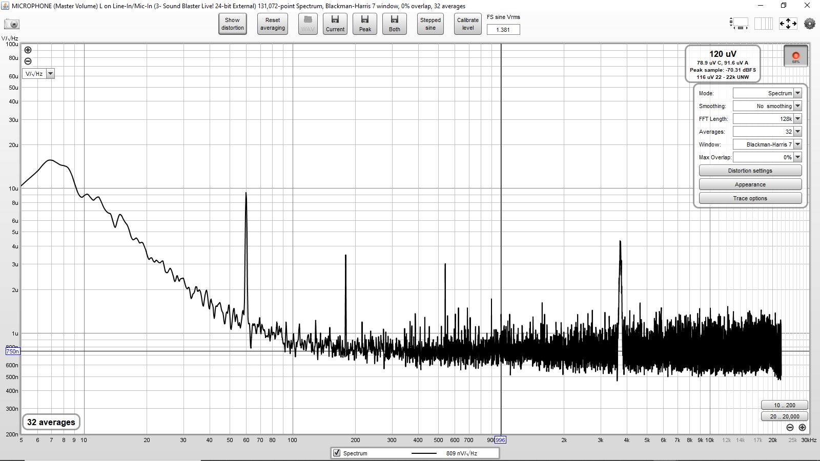

I did a quick measurement of 3x parallel S8550 generics from the cheap ebay assortment plastic box kits.
I would not be surprised if the original S8550 process and die layout was similar to the National process #63 and die layout I posted here #149 for 2N4403/2N2907.
I have attached the measurements. Divide by 1000 due to the 60 dB gain. I apologize for the 60 Hz harmonics and SB0490 noise spurs.
So of the cheapest available transistors the 2N4403/2N2907 with rbb=17Ohm is a good bet. For more expensive better devices there are the Zetex devices. However the cheap plastic box assortments do seem to have reasonably low noise S8550 devices in them. (Aside: I am having pretty good luck with the cheap generic TO92 devices. And terrible luck with cheap generic power transistors, which I do not buy anymore.)
- I get around 0.9nV/√Hz when my 60 dB LNA uses 3x parallel S8550 generics as the input devices. (First image.)
- I get around 0.75nV/√Hz when my 60 dB LNA uses 3x parallel old Fairchild silver face PN2907 as the input devices. (Second image.)
