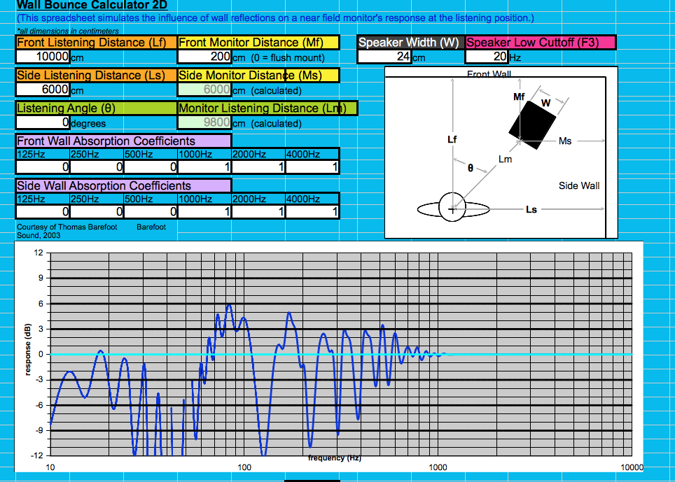

For context the systems where placed front centre 2-4m from the back wall facing straight forwards.
The back wall one quarter wavelength reflection (speaker-boundary interference) at 2 meters would cause a null ~43 Hz, and a peak an octave above. Can't bring back the phase cancellation frequencies, and the peak makes the lack seem even more apparent.
http://arqen.com/acoustics-101/speaker-placement-boundary-interference/
There is a link to a calculator there, looks like this:
Sub placement up against the back wall corners will eliminate low frequency speaker-boundary interference, other than the ceiling boundary, though that cancellation would be localized.So the question is, how can I avoid this in the future?
