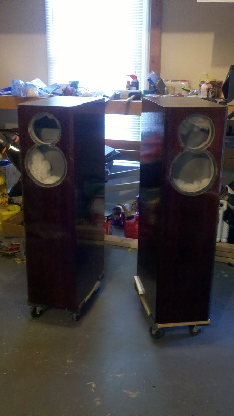

I've built them (4x10") and they are my primary speaker. Attached is the pic before I mounted the drivers and buffed them down a bit.
I'm fairly new to the audiophile obsession and these were my first build. My overall impression is they are very smooth. They seem to be fairly tolerent of placement and amplifiication. It seems to be the one part of my system that I really enjoy. I demoed serveral speakers before I tried to build my own and compared to my demos I'm very happy. Where are you located 2muchRice?
I'm in Dallas, TX
What kind of drivers are you using? I plan on using the 12 Eminence DeltaLite II 2512 that he recommends.
I've build them with Eminence DeltaLite 2510, 10". Maybe with some room gain below 35Hz you can get better response on these frequencies. My room is not working on these frequencies unfortunately. Anyhow like most of the speakers there is a compromise. Here on the upper bass, drum kit sound so real.
