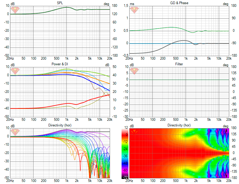

Here is this plotted in graphs, a GIF animation cycling through ideal 5" driver Sd 55-80-105cm2 on ideal 20x35cm baffle.
Kind of shocking how much there is change, not that much directly on axis other than diffraction related ripple changing, off-axis changes more, DI changes.
I guess its not showing in the simulation as I'm using ideal drivers that seem to have constant sensitivity no matter the Sd used.

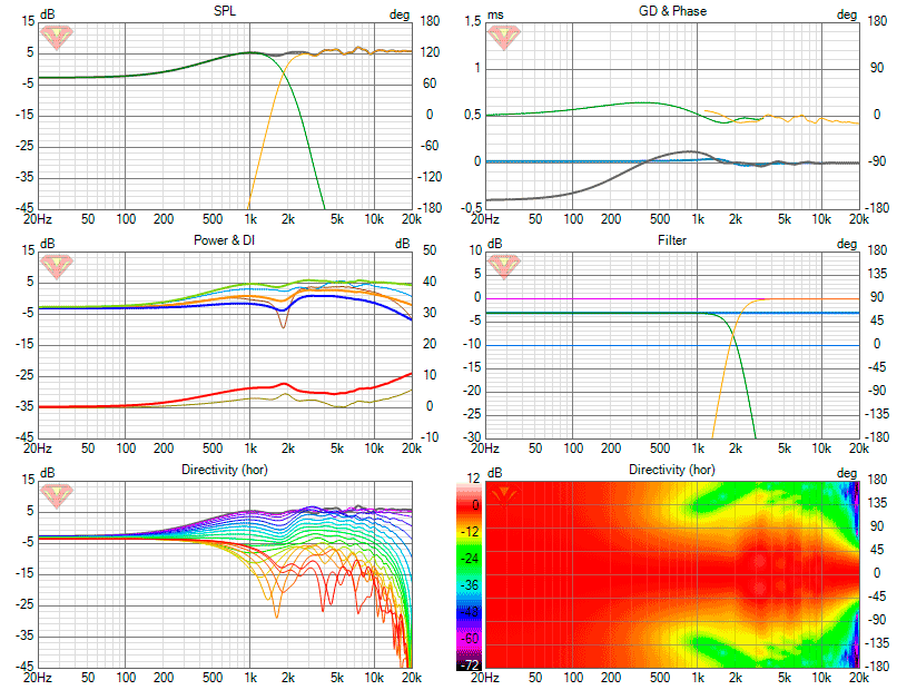

Here is GIF with SPL adjustment, -3db when SD is 55cm2 and +3db when Sd is 105cm2, is this more correct what would happen? If it is, crazy stuff.

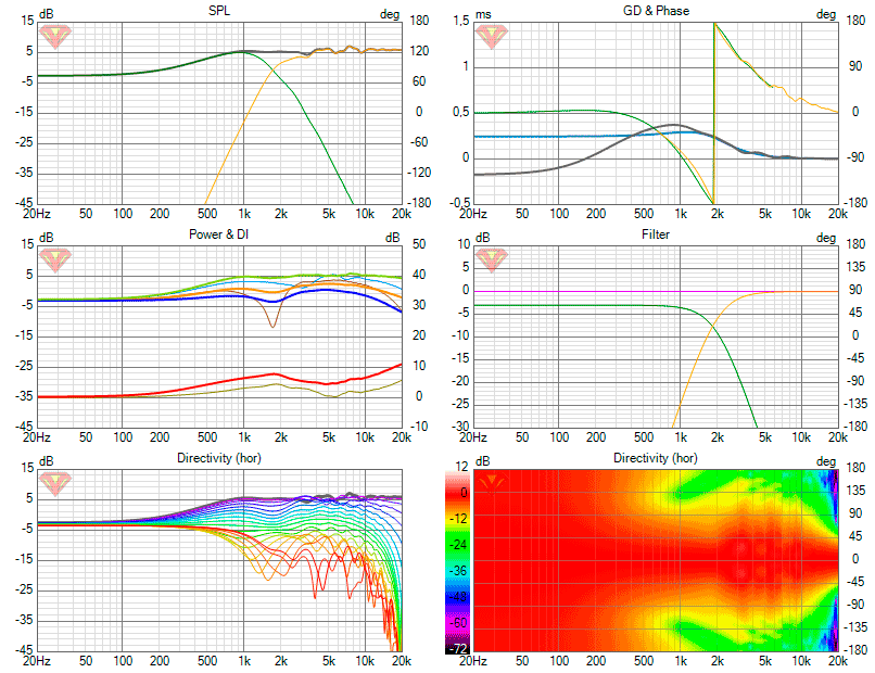

Even the system group delay modulates with excursion, crossover varies. Conclusions can be drawn in haste that audibility of group delay also depends on SPL, excursion happening in the system, like diffraction perhaps. And something whose audibility cannot be tested in headphones for example unless whole listening environment was somehow constructed with sources doing the modulation and reflections auralized.

Looks to me like the behavior is entirely driven by the off axis response changing due to the diaphragm diameter changing, that's why the on axis doesn't change, you've already defined it (idealized flat probably). The sim won't change the on axis, just off due to the diffraction calculation. So we should at least ask the question of whether we are just playing with models and not reality.
To the extent the sim is accurate of realworld behavior, a larger driver is one solution, but so is a 3-way. The midrange won't move much even when crossed fairly low, and as long as the woofer is crossed at frequency where it is still omni-radiation, there shouldn't be much issue.

There will still be issues with the woofer when its radiating area is modulated. This would lead to excursion-dependant efficiency. As already mentioned this will lead to a behaviour similar to nonlinear BL.

Yep, the amplitude modulation seems severe though and affects the whole bandwidth of the driver making the excursion. And in addition directivity changes with Sd, which is also kind of roughly here giving some hint of magnitude of things. Real world response would be more complex especially on the top end. Also, this is quite radical example, 5" driver taken to limits. Anyway, good food for thought.Looks to me like the behavior is entirely driven by the off axis response changing due to the diaphragm diameter changing, that's why the on axis doesn't change, you've already defined it (idealized flat probably). The sim won't change the on axis, just off due to the diffraction calculation. So we should at least ask the question of whether we are just playing with models and not reality.
Edit, 5" driver in example has 8mm surround and it makes the Sd vary guite much. My 15" driver has ~15mm surround and Sd varies much less, roughly between 760-960cm2 if considering surround fully exluded or included to Sd. Only about 25% increase, whereas the 5" driver was almost 100%, 55-105cm2
