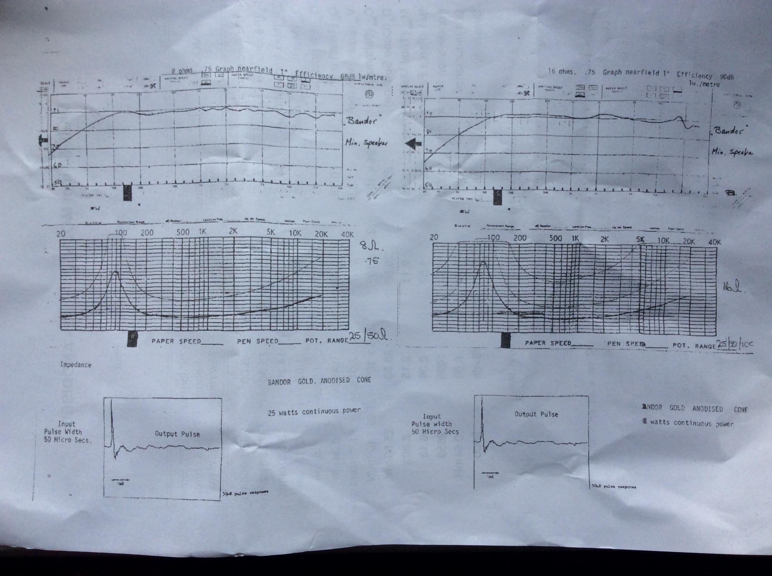

Thanx for the info. Seems like you got a bargain, in that condition 😉 What colour are the cones ?
It would be helpful if you could post an image of the impulse graph, so others can see how good it is 🙂 I have one somewhere, but it's at another location, miles away.

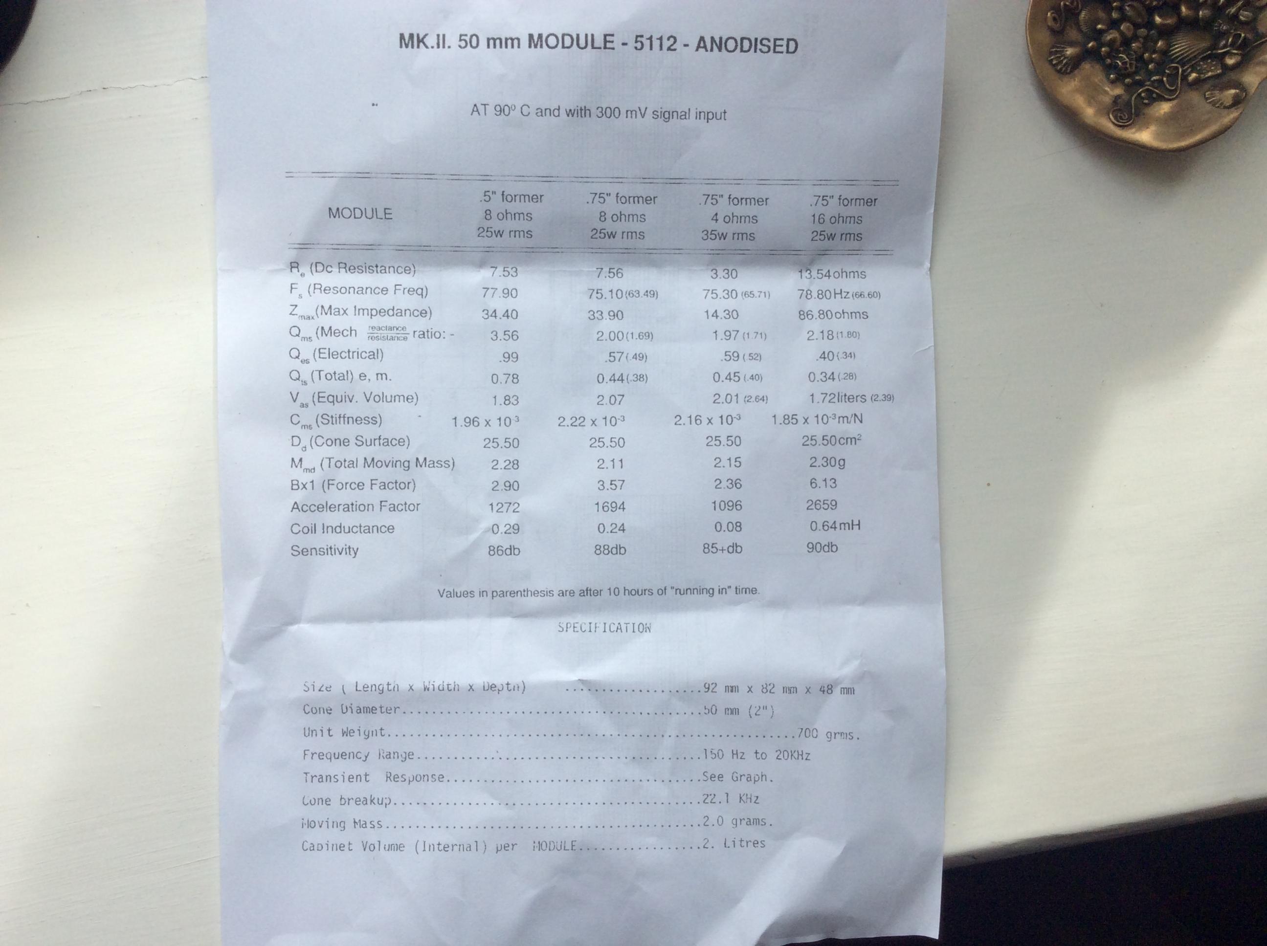

Here we have the specs. and graphs for the Bandor 50 units Hope you can see enough to of use!

they were on eBay and are in near perfect condition. Especially the cones which are extremely vulnerable to damage. I paid £40.00 approx. for the pair. I’m quite happy with this and am looking forward to hearing what they can do.
What.. If they are in good working order you have a real bargain there. The cone design is as good as any full range today and bandor were first to use anodized metal cones. Imo the treble and upper mids betters the small jordans and mark audio drivers
Bill Poster..........£20.00 each plus postage is worthwhile for a bit of unique handmade audio history. A moving mass of 2 grams gives a great impulse response so they should be very nice to listen too. Crossover is around 150Hz although a tad higher might be worth it. I have some Hi-Vi D 6.8 mid/bass drivers that might work well with these for the bottom end.
No enclosure yet.....just got them recently so working on non-parallel sided 2 litre box of some sort......I have two 30 cm diameter spheres made of 25mm thick plaster that have an internal volume of 7 litres that I could modify to accommodate these drivers. Non- parallel sides could be made internally, reducing the volume to two litres. As good as it gets diffraction externally from the spherical surface with these drivers mght yield some interesting results!

I believe, to protect them against over excursion as the cones are very delicate, but also because this is the recommended loading from Doreen Bance, the designer. Might be worth trying out ‘naked’ nonetheless with limited power to see if it would work.
The recommended box is between 1.5 and 2 litres as far as I know. I’ll test them with a Dayton Audio Woofer Testerto check T/S parameters but I’ll avoid using the ‘added mass’ technique for VAS because of the cone fragility.
