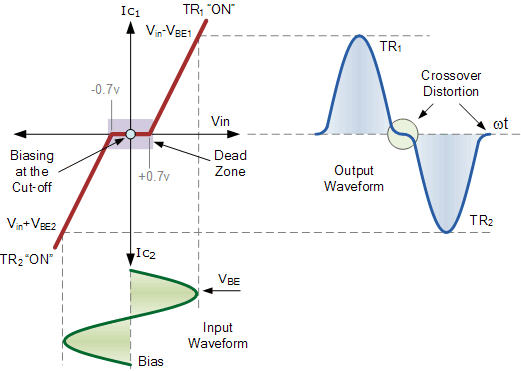

I'll try to explain this in simple terms. Consider what causes distortion in the time domain,
you have a time domain waveform, a sine wave for HD tests or a pair for IMD tests. Many
would say that ideally we want Vout(t) = 10Vin(t) using a gain of 10 for example. If you
plotted this you'd get a straight line with a slope of 10. Any deviation from the perfect
straight line is non-linear distortion. An example might be that as Vin gets larger the gain
compresses to 9 then 8 etc. just using this as an example - not the case for a high feedback amp.
So, what Earl is saying is that if you give him the test signal and the harmonic structure with
amplitude and phase, he will "back out" the Vout(t)/Vin(t) non-linearity and then use that to
compute the distortion with any IMD stimulus.
This assumes of course that the non-linearity has no frequency dependency, etc.

Here's an example of the graphical understanding of distortion in the time domain,
think of the IC1 axis as Vout and then the red line is the Vin vs. Vout transfer function.
This is not a good example for speakers because they should not have crossover
distortion rather it just shows the method:
