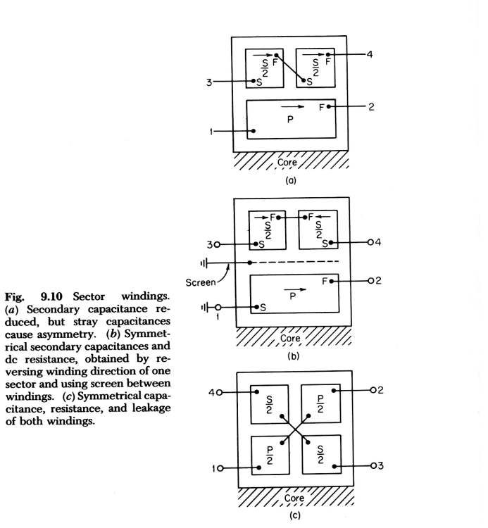

Hard to judge by what Lundahl does. For their amorphous core units they are faced with having to build quite a bit of distributed capacitance into the coils and also eliminate as much capacitive coupling as possible to achieve flat frequency response. Just the nature of the beast.
For an M4 core material you are going to want as much capacitive coupling as you can get, with as little distributed capacitance as possible. You can use two coils sets with a primary secondary primary winding scheme and then cross couple the primaries in an X fashion. 3mm back from the gap, for each coil should get you out of most of the seriously nonlinear field effect.
Look at the attached picture from Nathan Grossner's "Transformers for Electronic Circuits" to get a general idea. For Audio purposes you want to have the secondary driven symmetrically so you will have to imagine another primary block added to each side of the secondary, opposite the ones shown in fig C, and cross connected.

Thanks Bud, helpfull as always. I stopped a while ago compiling winding methods and I developed mine (much like fig. C in your attach.). We discuss audio transformers but the name of the game is mostly capacitive coupling, the technical version of "the beauty and the beast"

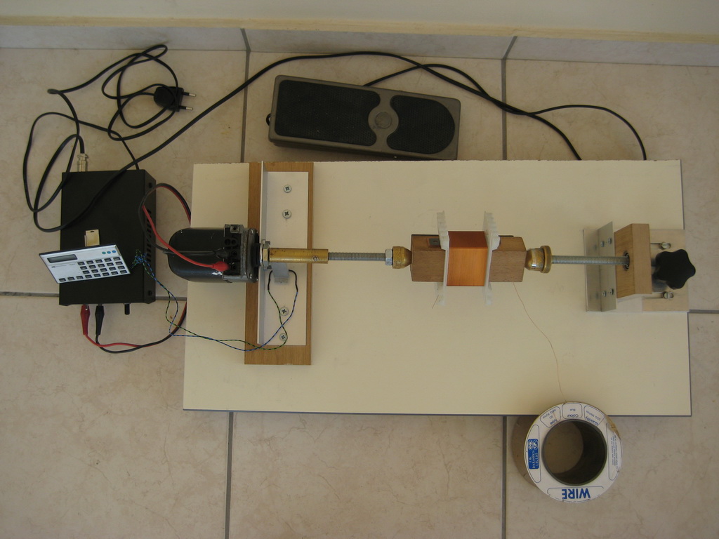

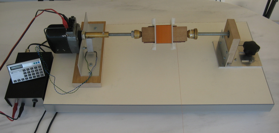

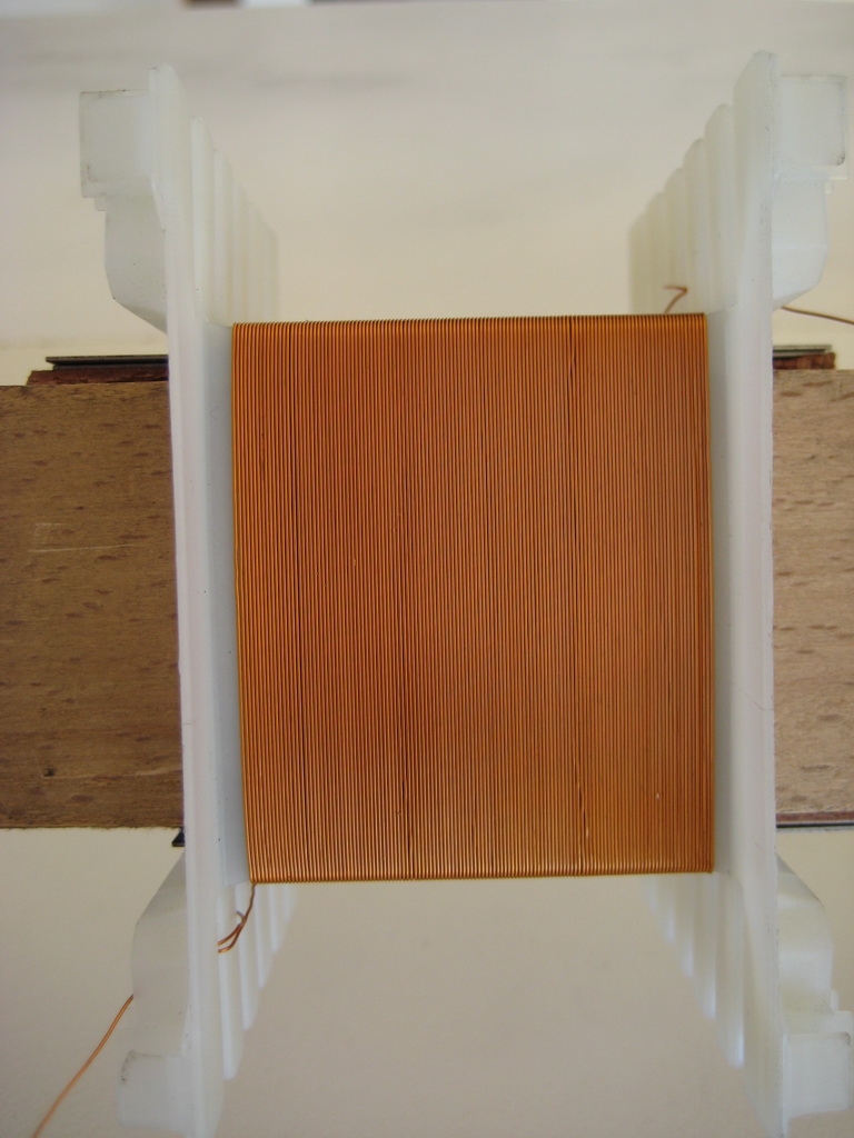

Just saw this thread and I found it very interesting, since I have wound myself a couple of transformers. Design is from a friend of mine, who knows a lot more about output transformers than me.

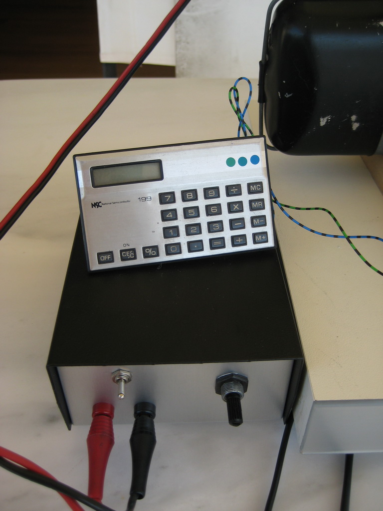

I have constructed a very simple winding machine for that purpose. It's a 24 VDC motor driving the spindle where the bobbin is mounted. The motor is driven from a PWM variable power supply to control winding speed without loosing torque. For turns count, I have implemented a very simple solution: an old calculator where I have connected a reed switch on the + button contacts. On the spindle I have mounted a series of small neodymium magnets (instead of one large - that's what I had in hand) which momentarily close the contact of the reed switch on each revolution, adding up number of turns. I also have included a footswitch, which is just an on-off switch - turning speed is varied on the PSU unit.
For the moment, I guide and stress the wire by hand (and I have learned to do so with ease, producing nice and even layers), but I plan to include Yves's "AVANCE" circuit with the needed mechanical construction for automatic advance of the wire.
Below, you can see a couple of photos of my DIY winding machine and a sample layer while I was testing it.

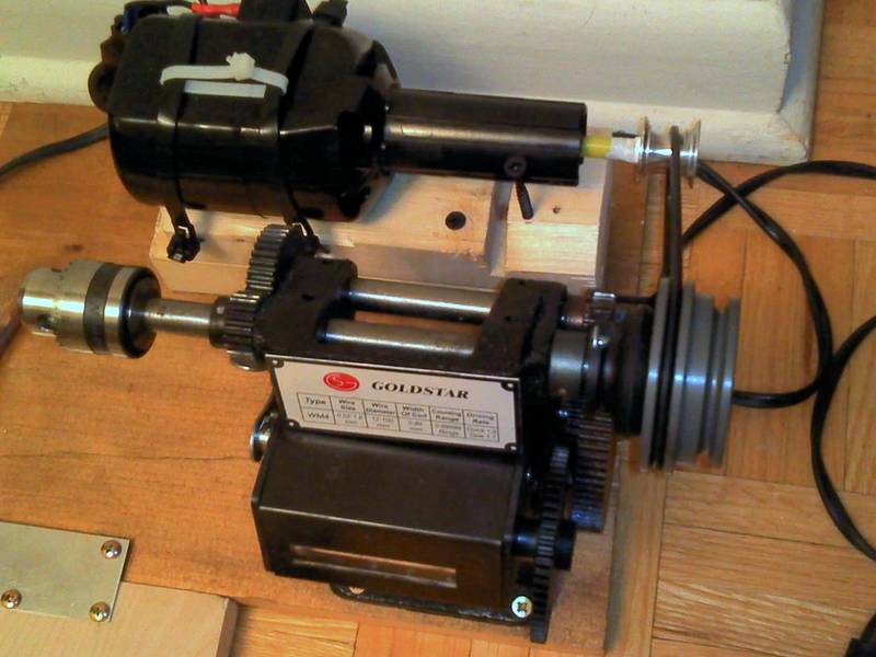

This is my tertiary winding machine (a Nittoku as primary), mostly for small tasks, winding wire reels and never ending tests. For a DIY enthusiast, spending about $200 for a coil winder project it's almost a minimum. Well, that's the price for this little chinese machine bought on eBay (Coil audio Output transformer motor winding machine 2 | eBay). Having one and testing it will turn out that, as it is, it's pretty useless; the original sewing machine motor it's a joke; it has 10,000 RPM (no bearings) and it's very weak - anyway, the overall speed it's far too fast. I have (gladly) replaced the original motor with a junk-recovered ugly beast having lower RPMs and a lot of power. I had to adapt the rectifier bridge and the power MOSFET transistor inside and I've adapted the signal from HALL counting sensors to a stepper (via a Vexta driver and lately to a Mdrive17 from IMS); now it's meaning business...
No, I have no schematic for the original winding machine, I'll be thankful to anyone providing me one, as I'm still thinking several scenarios with this setup.
