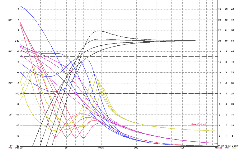

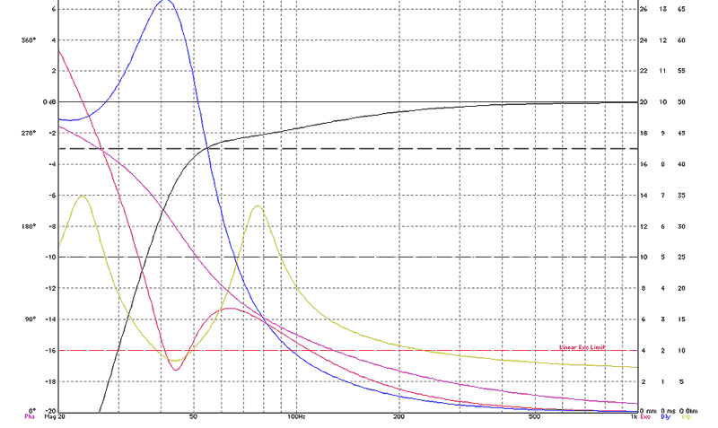

As i recently discovered on an Onken thread, k is just a way of specifying an alignment. It is, to my mind, much more informative to look at the curves generated when you change the vent size.
Here you see what happens when you take a fixed volume with 40/50/60/70 Hz tunings. Each would have a different k factor.
What thw ks are i forgot already, GM mentions 2 in the recent Onken thread , more commn today a max flat, which would be somewhere between the 2 middle curves. The other number he mentions, for a tradiitonal Onken tuning gives a curve something like this. Do note that to get this alignment i had to increase the box volume.
You will see this kind of alignment in many Tannoy’s for instance, and is a way of trading off bass extention for box volume, really needs good match to room gain, and IMO some quality & finesse.
It does bring up that there is a large space of possible reflex designs. Volume and tuning are the variables (speaker data being fixed) and as one moves thru that space there ar eliterally an infinite number of potential results. It is very easy to get into the weeds.
And don’t make the enclosure a tower. Because it is now an ML-TL.
dave
dave
