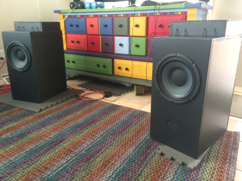

I'm using Eminence Beta 10cx with the PSD2013s-16 in my theater behind my AT woven screen and they are stunning. Had a great deal of fun getting the XO right but once it was...Wow.
I live near the Eminence factory so I took them over (with permission) and they were quite shocked at how good they sounded.

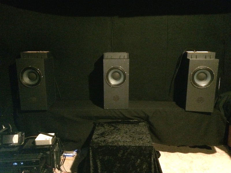

3 verticals up front! Cool! Publish your crossover for the benefit of all mankind, would you? (Maybe start a thread "Eminence coax crossovers"?)
It is patent pending right now but I will post it "fair use" for DIY after that goes through.
