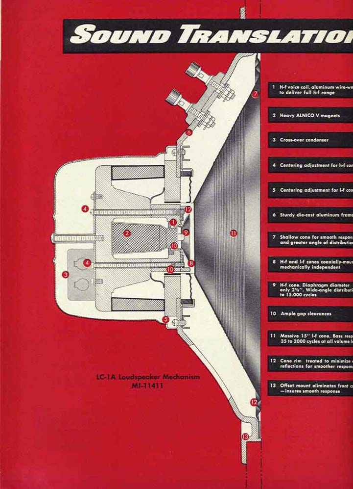

The trouble with many, perhaps most, coaxials is the response of the woofer is pretty messy in the crossover region. Digital EQ is not a cure-all, since there are very large response changes with changes in emission angle (spikes in the polar pattern that are frequency dependent).
This comes down to the big horn right smack dab in the middle of the cone. The cone doesn't like this; I'm not even sure the "phase plugs" that are popular these days are an improvement. In other words, hard reflecting surfaces in the middle of the cone does odd things to the time response, which also leads to directional spikes in the polar pattern.
I agree 100% that a driver like the famous RCA LC-1A needs to go back into production. The patents have long expired - heck, RCA itself is just a trade-name owned by Thomson of France. Another fun driver to bring back would be the Altec Biflex, with an elegant decoupling ring, which provides an inner and outer cone.

Without directing my attention to any one design I will give you my take on the three basic design constructions and my opinion of the pluses and minuses of each.
The first design to consider here are the cone loudspeaker, any size and compression driver combination. In this design the mid/bass cone assembly is basically the same as any other direct radiator and has all the pluses and minuses of that traditional design. Nothing special, a well known and understood design. The obvious difference is that the center dust cap is removed from the design. A compression driver is mounted to the back plate of the magnet structure and the pole piece rather than solid as is normal is a hollow cylinder. This hollow pole piece is traditionally shaped as the first section of a normal compression driver whether that is a straight conic section or an exponential expansion which is much less common. This section is connected to the cone driver by one of two methods. The cone can be used as the waveguide, Tannoy and others, or a small short horn is mounted in front of the throat section in front of the cone. Here are the limitations of each design. Both of these designs will have a rather long throat section that has a limited expansion rate, this causes beaming in the upper frequencies of either of the two implementations. The longer this transition the greater the beaming. One solution has been to foreshorten this area as much as possible and use a very fast expansion rate allowing for greater dispersion. Another attempt to correct for this is the use of larger format drivers, typically 2" exit drivers to increase mid-range output, but this comes at the cost of both less upper frequency response and a greater tendency to beam on axis. The second implementation of these devices is the short horn lens coupled to the throat section in front of the cone, Altec and UREI are two of these designs. These designs have two short comings. The horns are very small, the lower cutoff frequency is limited to the 1/4 wave mouth size of the waveguide and this is typically fairly high in the frequency band. Meaning that the cone driver has to go much higher in frequency before cutoff and this leads to both cone breakup and poor polar response at the crossover frequency. Another problem is the destructive interference to the radiation pattern of the cone driver. Neither of these two designs has a perfect response curve but they are highly efficient and can sound extremely good but you have to be aware of the limitations of each of the two basic designs. Also remember that though the acoustic center is concentric the time alignment of these designs is not optimum without an active time alignment circuit in an active crossover. The distance is to great to correct this with a passive alignment circuit.
The Second typical coaxial design is that of a dome tweeter or some version of that in place of the above compression driver at the apex of where the dust cap would normally be on the cone driver. This implementation has the advantage of both coaxial and time alignment of the two devices.The RCA design earlier shown is a very early design of this design taken to a high level of integration. Many times these designs are simply a dome tweeter with a separate magnetic system mounted on the pole piece of the driver where the dust cap would reside. The time alignment will be slightly askew as the magnetic system will offset the tweeter forward in time alignment. This design can have a fairly good sound depending on the quality of the two devices but will have a slight interference pattern in the upper mid-range response of the cone due to the assembly in front of the cone driver. Typically the efficiency match of the dome tweeter is on the lower side due to the minimization of the motor assembly allowable in front of the bass cone.
The third implementation is a tweeter or mid range and tweeter device mounted on a plate in front of the cone loudspeaker. This design has many drawbacks to its design. The time alignment of these devices are no better than a dome tweeter separately mounted on a baffle, though the on axis implementation is superior. Mounting the device in front of the cone loudspeaker will fundamentally interfere with both the radiation pattern of the cone portion of the driver. There will be a shading of the cone driver, cavity resonances, reflective energy redirected back at the cone and many times resonance output from the actual mounting plate emanating in the audio band. This is the typical design of a car loudspeaker where this design is used due to space constraints and ease of installation. This is the most destructive implementation of the three designs, with poor polar response, lack of time alignment and cavity resonances. Carefully evaluate your needs and desires as in any loudspeaker selection. do not believe the marketing hype that discounts the design flaws of each implementation. Listen carefully to any of these designs before settling on any particular brand or design. Let your ears tell you the story, not a disingenuous specification sheet.
The concept of a coaxial time aligned single source driver is one of the holy grails in loudspeaker design, but there have been no perfect implementations of all of these design parameters. Chose wisely, each design has issues that must be accepted, just as any distributed loudspeaker design has its own design concerns and limitations.
