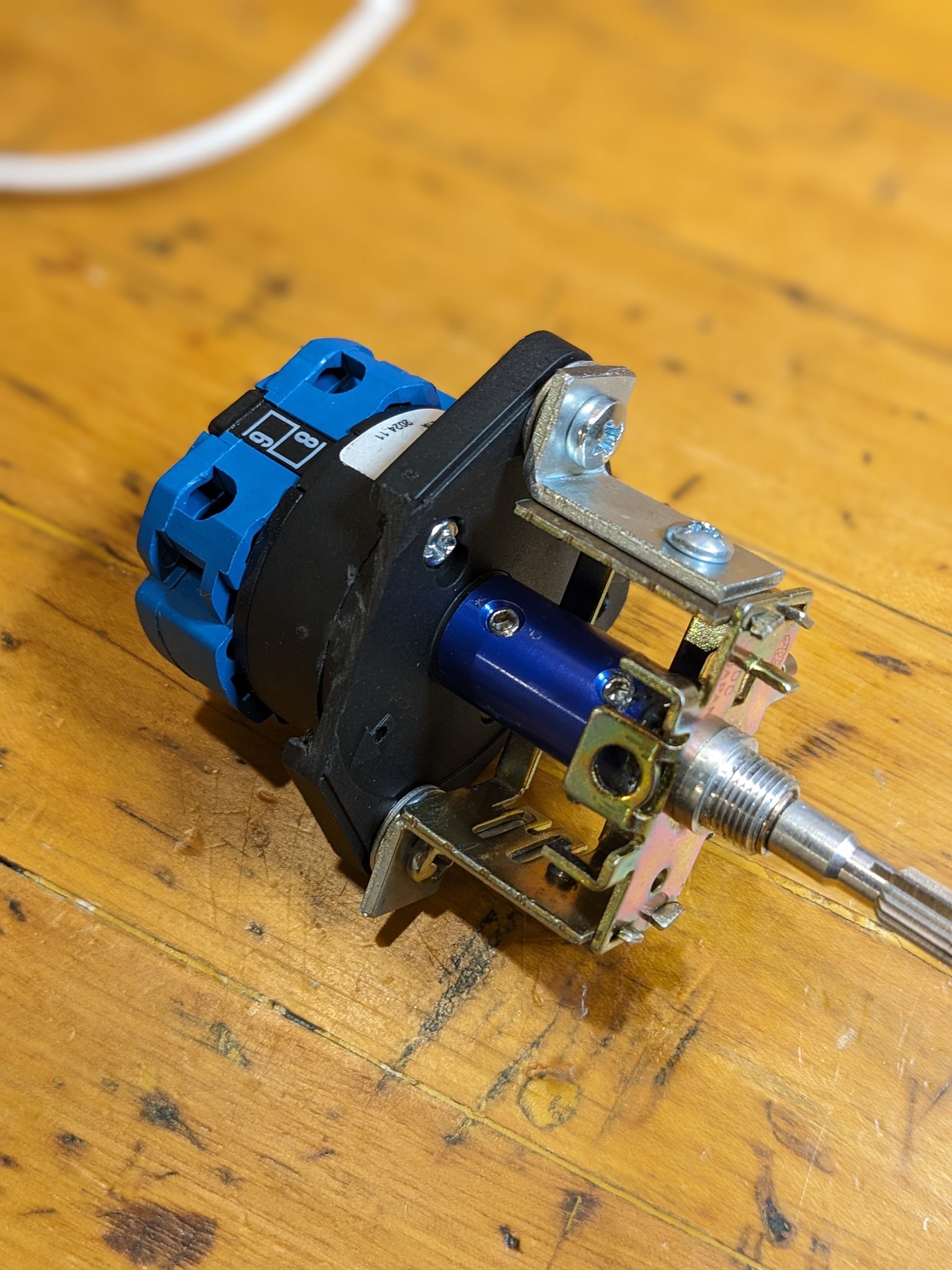

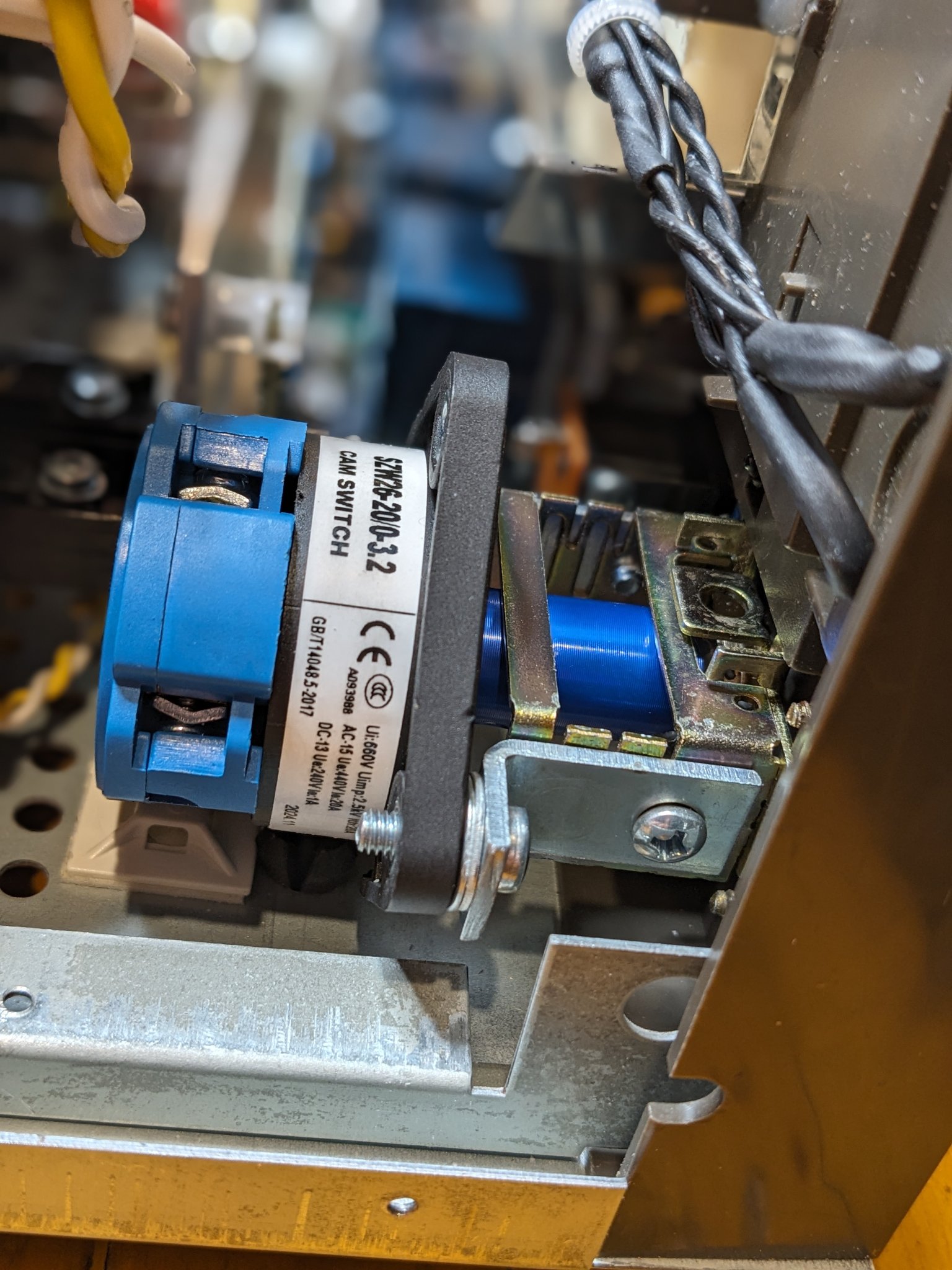

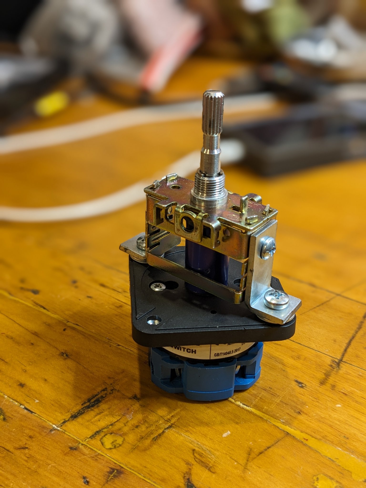

This is the switch I used:
https://www.amazon.com/gp/aw/d/B00NTROK8Y?psc=1&ref=ppx_pop_mob_b_asin_title
Because of space constraints several mod's were needed.
I removed one section and converted it to a single pole. The two black pieces that hold the sections together had to be shortened. When separating the switch halves, I would suggest doing it inside a plastic bag. It's easy for the contacts to fall out and the springs to go flying. I lost a couple to the ether but I only needed one, so no loss.
The 6mm post adapter had to be drilled out slightly to accommodate the square switch shaft, which I also had to shorten. One corner of the housing also had to be cut off.
Despite the low price it feels like a robust switch and is a much better solution than what I had.
