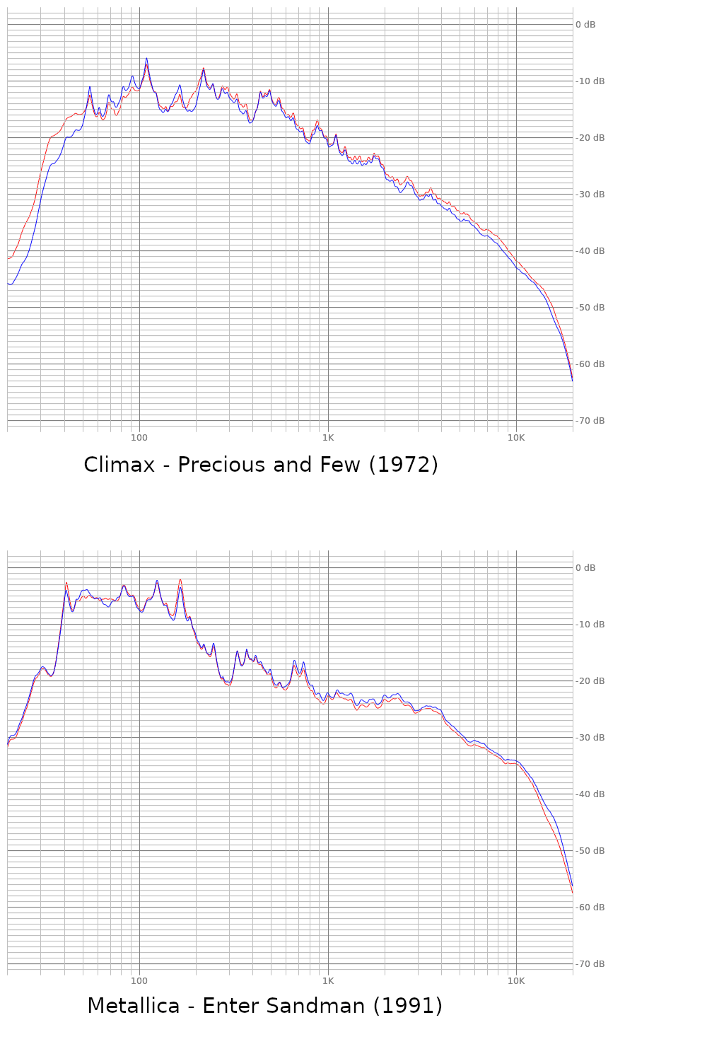

Here's a nifty comparison between:
Compare the drop from 1KHz to 10KHz. "Precious and Few" sounds pleasant. "Enter Sandman" sounds grating.
"Enter Sandman" has much more high-frequency energy than one would encounter in any live performance. "Precious and Few" may have soft highs, but it is closer to natural sound.
Ed
