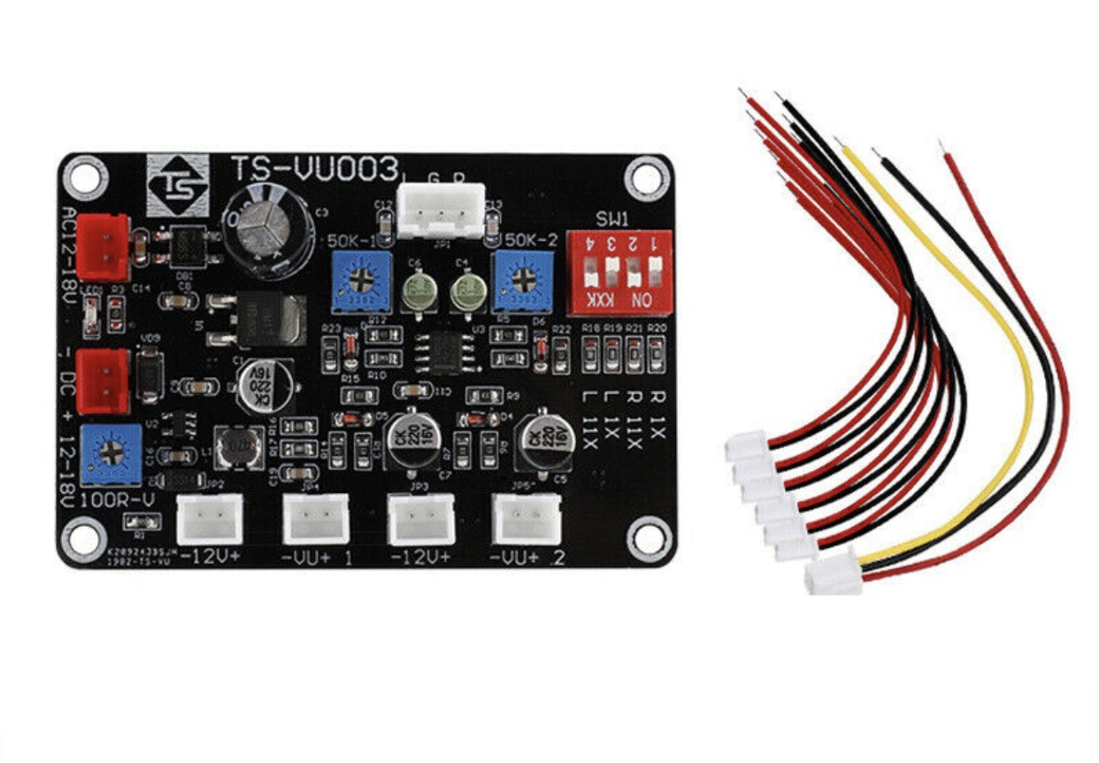

This is the meter board I ordered: https://www.ebay.com/itm/133921989559. I saw it in another thread and others were happy with it.
It has dip switches for line level vs. power out sensitivity, plus trimmer pots for adjustment. I don’t imagine it’s terribly accurate, but I was only interested in some movement.

I think my meter board may just be faulty. There’s rhythmic 7-15 mV AC going out to the meters at all times. The pot to adjust the lamp voltage does nothing. I can’t get rid of the mains hum with the meter board that was negligent without it. I will try the hand wired passive circuit I used in another amp to get bouncing meters. Gotta find what the values of those diodes, caps, and pots were… 🤔

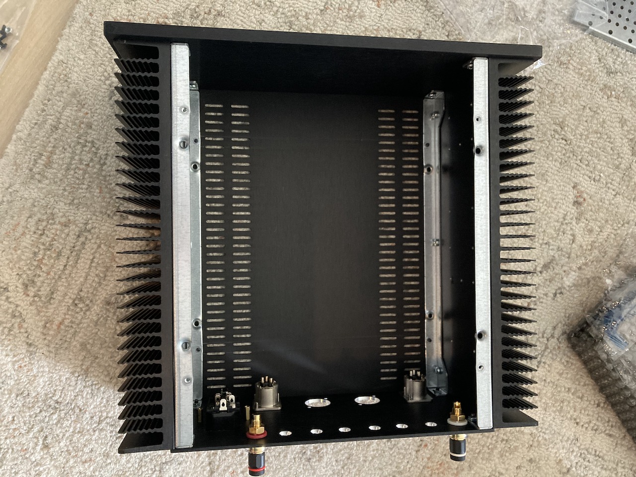

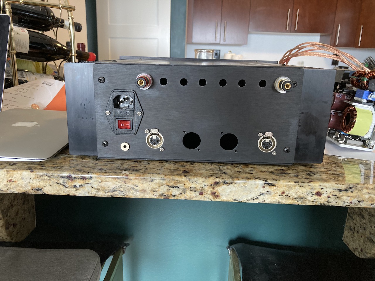

Received my modushop chassis today. Everything looks perfect but I cut it really close on the spacing of the furthest right speaker terminal and the back panel mounting screw, fortunately it fits fine but that is what I get for not including the mounting holes in my drawing 😳. Otherwise just need to order some 30 mm spacers and long M3 screws for mounting the modules to the heatsink and wire everything up.

Awesome. So you had the cutouts done by modushop then? What do they charge for that? Looks like a nice case. You went with the heat sinks I see. So you are going with 2 mods single ended and 2 in BTL? Correct?Received my modushop chassis today. Everything looks perfect but I cut it really close on the spacing of the furthest right speaker terminal and the back panel mounting screw, fortunately it fits fine but that is what I get for not including the mounting holes in my drawing 😳. Otherwise just need to order some 30 mm spacers and long M3 screws for mounting the modules to the heatsink and wire everything up.
The perforated sub-floor that they sell for mounting everything makes it real easy and gives the case a lot more rigidity. Have you thought about getting one for your case? When I ordered mine I got the sub-floor and have no regrets at all. It really helps keep the box square and if it ever gets dropped I think it would help prevent damage.

After talking to von I've decided to put a couple VU meters on my amp. I ordered a couple meters and a driver board that I should have around the 18th or shortly there after. They will dress up the front of the amp nicely me thinks.
From what I was reading from the sellers of some of these drivers boards they recommend using separate power supplies for powering up these boards so as not to introduce noise into the audio output. I got one of these to power my DSP unit and it works great. I think it would work for powering the driver board no problem.I think my meter board may just be faulty. There’s rhythmic 7-15 mV AC going out to the meters at all times. The pot to adjust the lamp voltage does nothing. I can’t get rid of the mains hum with the meter board that was negligent without it. I will try the hand wired passive circuit I used in another amp to get bouncing meters. Gotta find what the values of those diodes, caps, and pots were… 🤔

Yes, cutouts done by modushop which makes it very easy. It was 45€ for the rear panel cutouts (more than 20 holes) and drilling / tapping the heatsinks was 35€ each. I purchased three of the same chassis which resulted in a discount and they had a 15% off sale. So all said and done it was 710€ shipped which at a 1:1 $ to € conversion rate was not too bad. All chassis will have two modules, one chassis will have modules in BTL for subs, other two will be in stereo mode.
I did order the perforated sub floor to mount the extra capacitors PCB and to provide some additional support for the power supply even though it is fastened to the heatsink. In the test fit up the power supply seems pretty rigid without the sub floor but I don't like the idea of it being cantilevered like that with only two M3 screws for support.

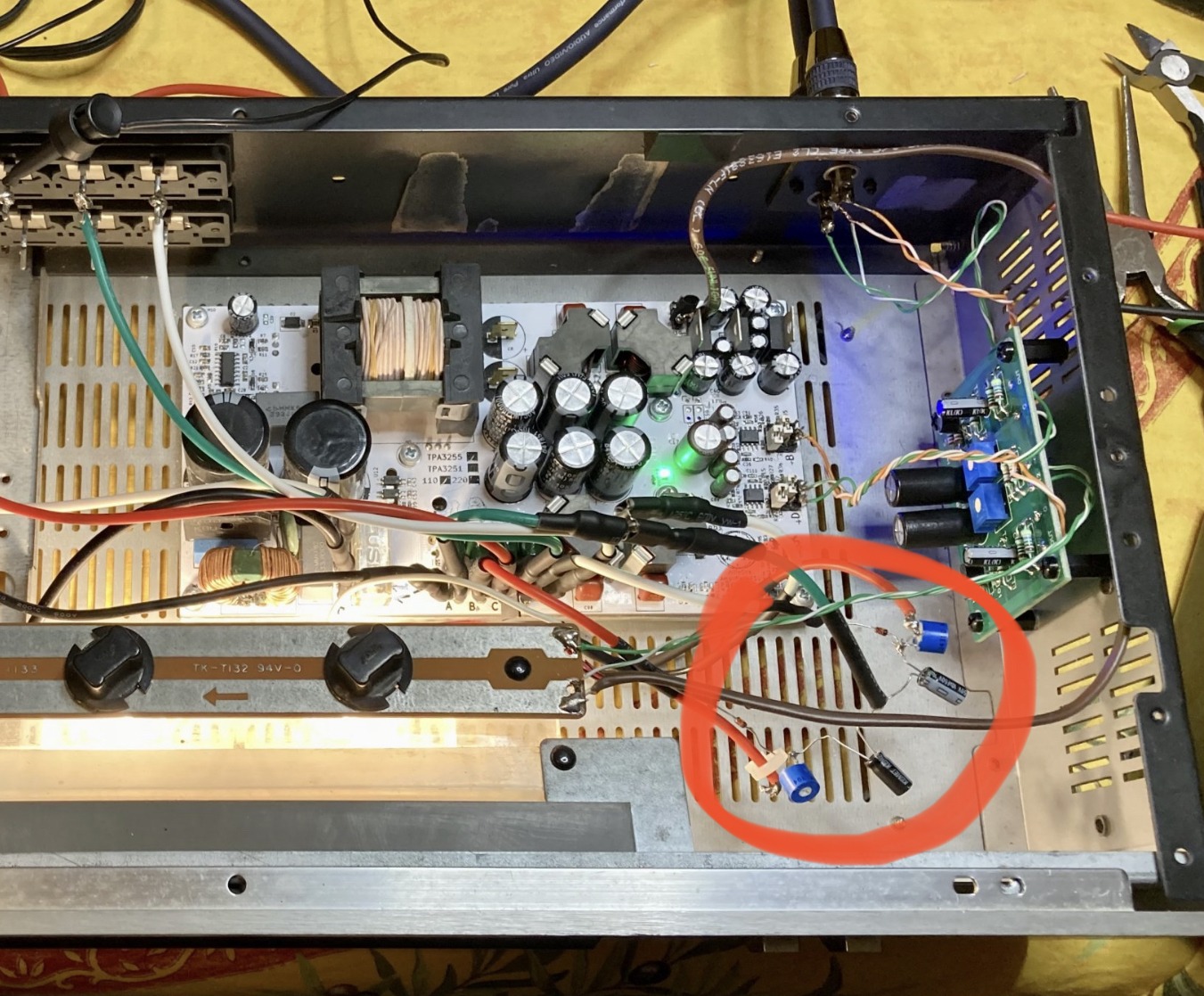

That’s an interesting option, thank you. I did try a separate 12V smps to power the VU board and got similar results. I believe there is something incongruent with tapping the amp output as L-GND-R to feed the VU board causing my ground loop noise. I am open to trying the separate power supply like you show, but I also want to try the passive circuit for meter movement. Just gotta order components.From what I was reading from the sellers of some of these drivers boards they recommend using separate power supplies for powering up these boards so as not to introduce noise into the audio output. I got one of these to power my DSP unit and it works great. I think it would work for powering the driver board no problem.

All this talk about meters got me thinking how good they would look on the front of my amp and since the boards allow input from the preamp as well as the amp(s) I decided to put a couple on mine using the preamp inputs. They will be here around the 18th or so. I will be using the separate amp I linked you to to power the driver board as I already have one in the case for the DSP unit. Hopefully no noise.That’s an interesting option, thank you. I did try a separate 12V smps to power the VU board and got similar results. I believe there is something incongruent with tapping the amp output as L-GND-R to feed the VU board causing my ground loop noise. I am open to trying the separate power supply like you show, but I also want to try the passive circuit for meter movement. Just gotta order components.
Have you considered using the low level single ended inputs instead of the output from the amps to drive the meters?

I will try that now! 😀All this talk about meters got me thinking how good they would look on the front of my amp and since the boards allow input from the preamp as well as the amp(s) I decided to put a couple on mine using the preamp inputs. They will be here around the 18th or so. I will be using the separate amp I linked you to to power the driver board as I already have one in the case for the DSP unit. Hopefully no noise.
It worked! Everything is operational and the ground loop noise is gone. Thank you, @iamjackalope, for suggesting that test. Easy fix.

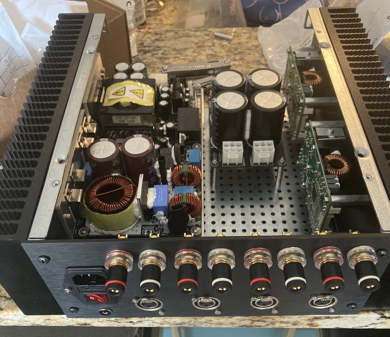

Pic of everything fit up. Just need to do the wiring.
Michael
Cool. Glad it worked.It worked! Everything is operational and the ground loop noise is gone. Thank you, @iamjackalope, for suggesting that test. Easy fix.
It’s going back in the main system tomorrow.
Looks great so far. Very nice job. We already know it sounds great. So the most expensive part of this amp is the case right? If you ever want to sell it you shouldn't have any trouble like with many DIY projects that just look to DIY to sell. This looks like a commercial offering. Nice job.
How’s the 4-channel build working out?Pic of everything fit up. Just need to do the wiring.
Michael
Very slowly, have all the wiring crimped (which is one of my least favorite tasks), need to solder the speaker, XLR and trigger terminals. Also need to apply some thermal grease to the module heatsinks and power supply. Thought I would get to it this weekend but ended up working instead. 🙁
