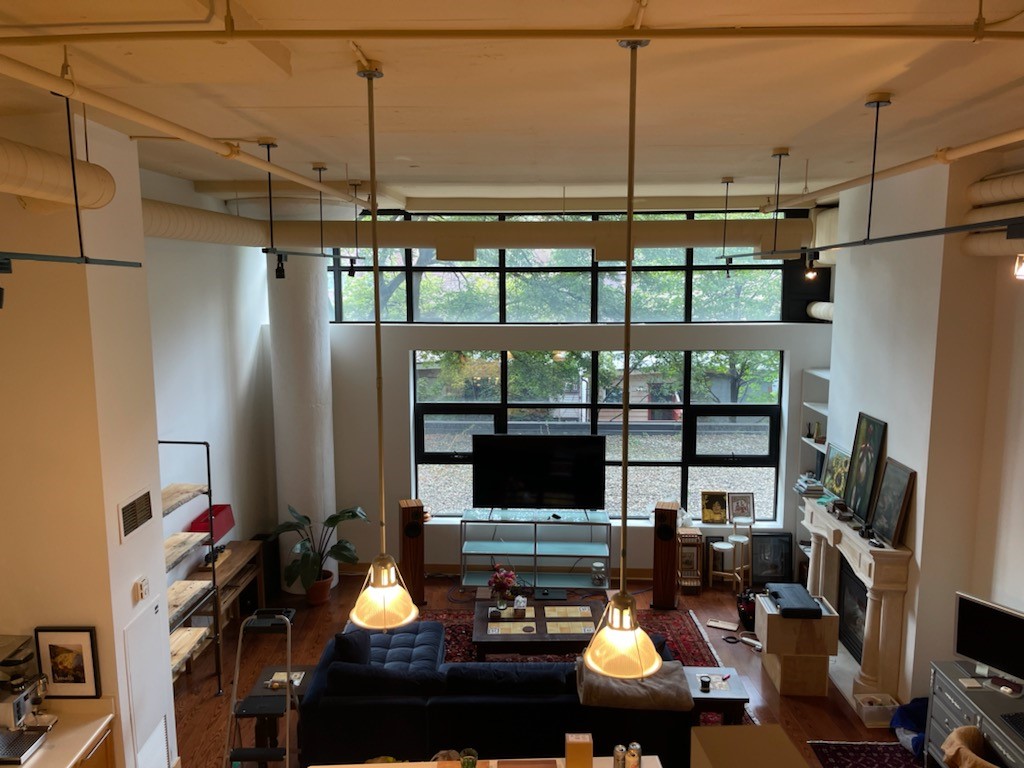

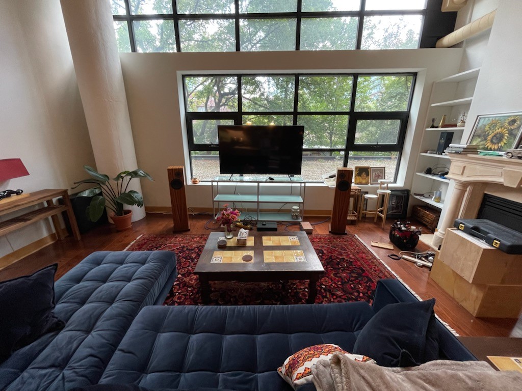

I set up proac clones in a condo loft this past weekend. The approx dimensions are about 18'W,14'H,60'D - A very big space. The bass was less bloated then what I have ever heard from these speakers. Its the first time I enjoyed the bass quality from these speakers. IMO, clearly the appropriate size room for them..

Joel,
That is a beautiful room, and very spacious.
I see a large carpet and a couch; beyond that have you considered any room treatment, and something on the ceiling?
Yes, we discussed treatments. Does this room need treatments? The boundaries are distant.
Any suggestions for treatments.. Diffusers mounted to the ceiling would look amazing. I know they would like that aesthetic.
I really don't see the need for acoustic treatment with those Proac cabinets .....
You say that you have noticed a big change when using them in that bigger environment, there are more defined bass, etc. You are at the limit. From now on, any treatment that is based on damping low frequencies will make them anemic to faithfully reproduce double basses, organs, etc.
