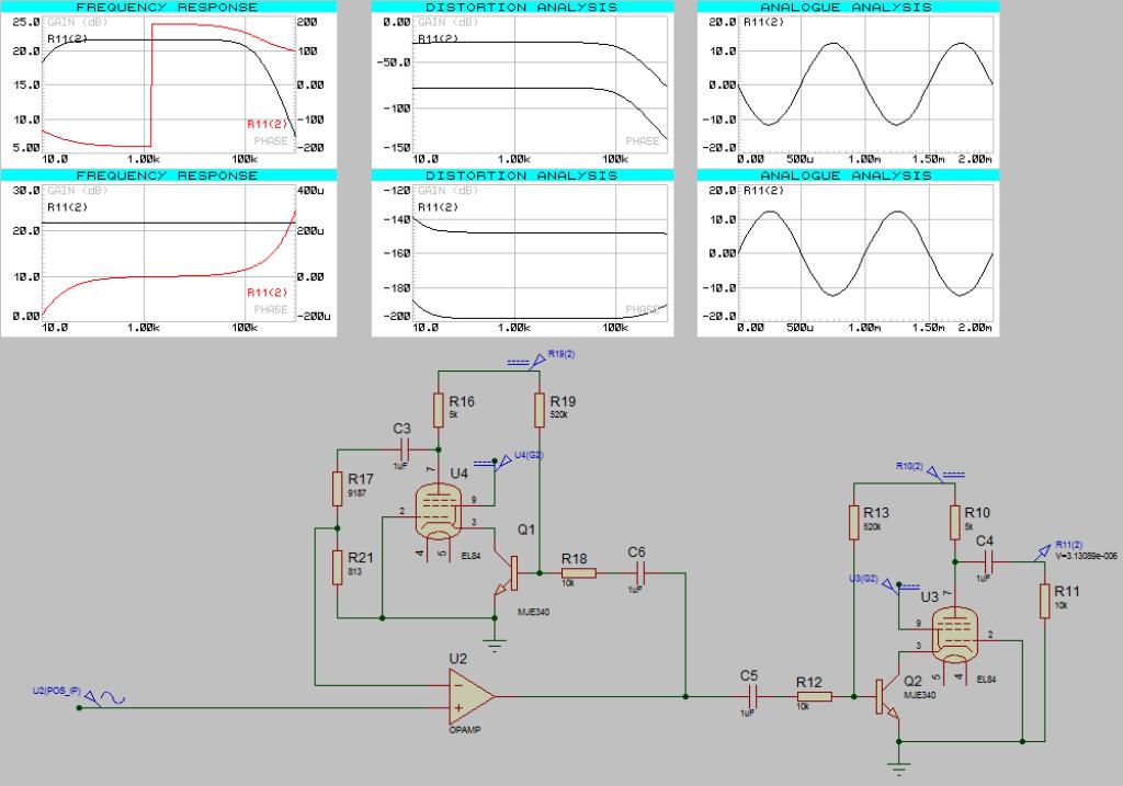

Perhaps you could put your zero-feedback amp into the feedback loop of a second, zero distortion, amplifier. Record your music in this configuration, and then play it back through your amp as usual. This might illustrate the point that feedback is an inevitable part of error correction.
Like this
Top graphs: amp without predistortion
Lower graphs: amp with predistortion
input: bottom left
amp: bottom right
distortion engine: bottom centre

That predistortion will have the same effect as NFB, in that it will sharpen the eventual clipping - there is no free lunch! However, it is a good example of applying predistortion where NFB cannot be applied (at least, not easily). In that case NFB would require somehow detecting the response of the tape head or even the tape. The same issue does not arise with amplifiers, although it could perhaps arise with loudspeakers.

If you took a conventional amplifier with NFB and 0.005% THD or whatever, are you saying that there is nothing you could do to 'null out' the remaining THD (and IMD of course) with just a smidgeon of the right pre-distortion?
practically I'd expect the distortion residual of a high feedback amp to be highly variable with operating point, thermal history – and very, very small
which would make it hard to accurately model, predict to maintain the cancellation with a predistoriton approach
to predict the Q die temp in the amp is a multi-physics problem = thermal radiation, convection, conduction
how much instrumentation are you going to afford - air, heatsink, transistor tab temperature sensors?, output current, power supply V and Re deltaV to get electrical power dropped in the output Q? - what about the driver Q now?
To be motivated to try predistortion in audio power amps over really good implementations of high negative feedback in audio amplifiers I'd like to see better evidence of “the problem” with negative feedback
