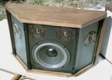

Stuff like this, which is the wall mounted Acoustic Research MST:
Aspects of the design I like there... especially those cone tweeters.

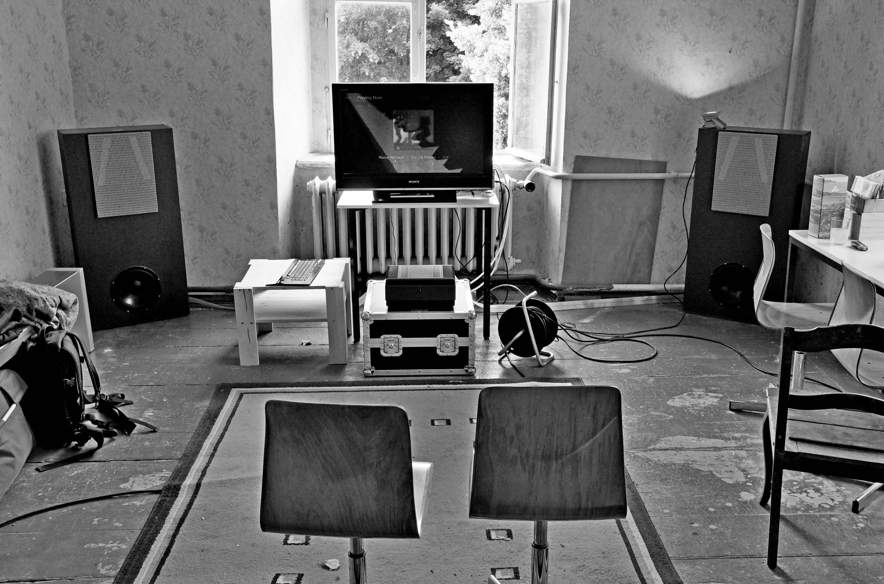

Or a much more expensive design we just saw:

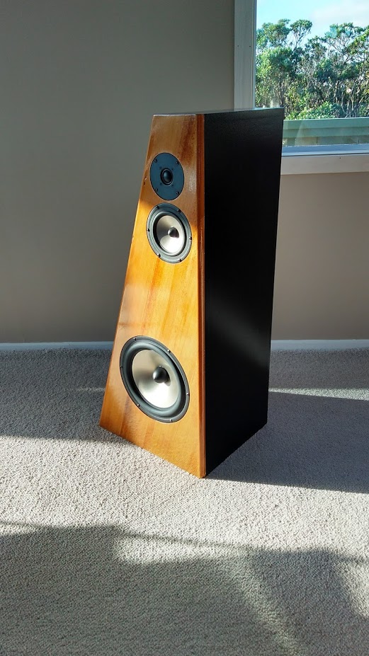

One of my heroes in this forum, Joachim Gerhard, also got interested in floor bounce, He got to this:
The Quintessentially German Loudspeaker of the 70th. Modern Interpretation.
