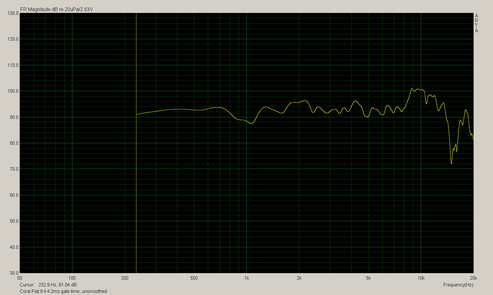

Interesting. I haven't seen anyone publish measurements of the Beta 8 before.Here is how two at least 30 years old drivers match close to perfection.
I'm surprised at how peaky the response is, it doesn't seem to be as flat as the Flat 8. Below is a gated measurement of one of my Flat 8 II. (Only accurate down to about 500Hz due to window period)
To be fair, this is after my foam block damping tweaks, and some of my other Coral drivers measure considerably less flat.
Hi DBMandrake
This graph show the acoustic of your listening room , not really the Beta 8 !
In Beta serie all parameter are optimized .... 11mm and 17mm for magnetic field plate is not common !

Not sure if you're referring to my Flat 8II measurement or the Beta 8 measurement, but my measurement is gated and does not include any room contribution.Hi DBMandrake
Although its hard to be sure the CLIO measurement of the Beta 8 also looks like a gated measurement. Peaks and dips of that magnitude from 2Khz to 10Khz would not occur due to room effects even in an un-gated measurement if the measurement was done from about 1 metre. At those frequencies a Beta 8 will be very directional so there won't be much bounce from the floor/walls at the microphone.

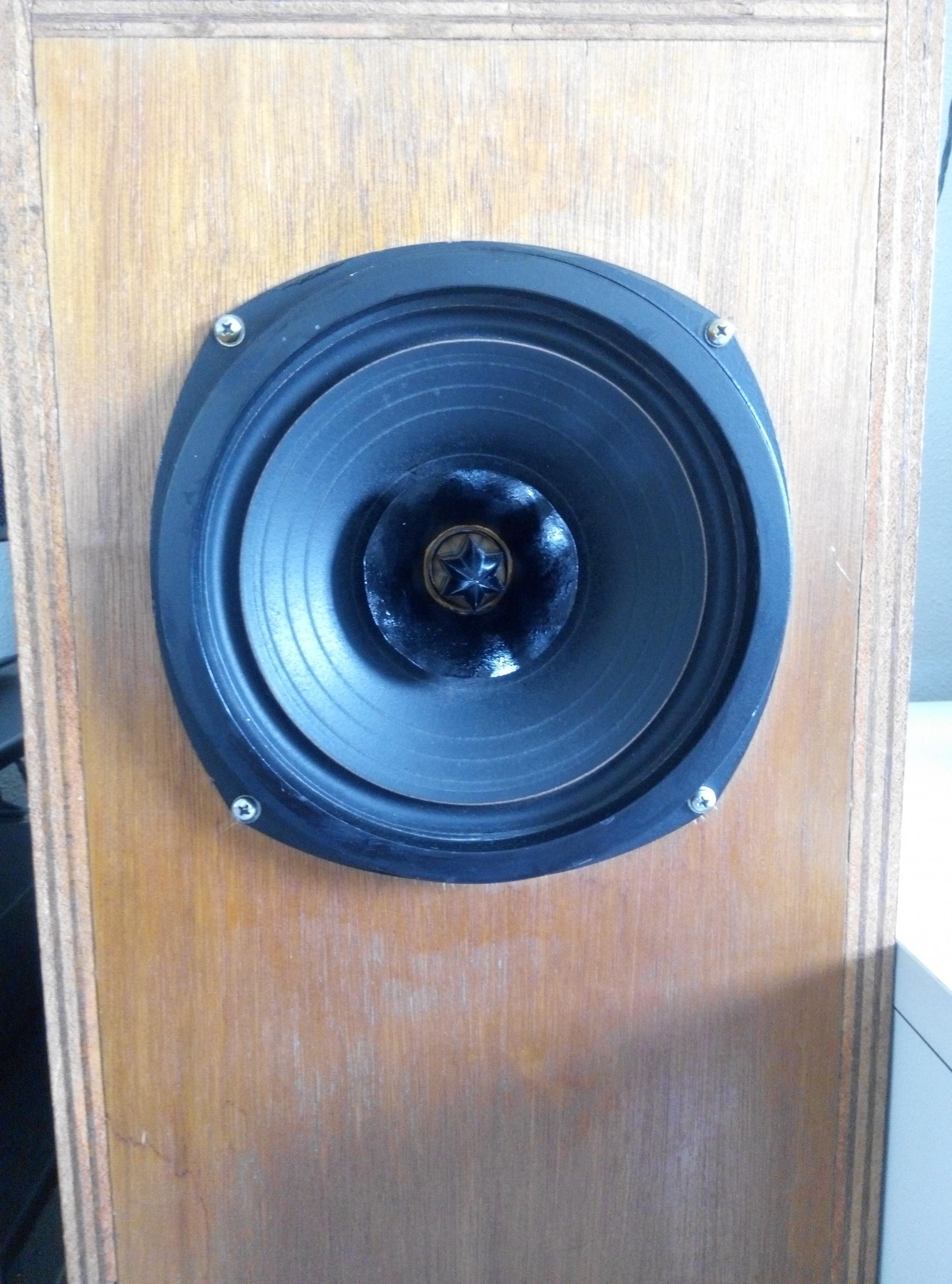

I owned a pair of Coral Beta 8 for many years, thinking of letting it go but too bad no body appreciate it at all. Sad to say this.
Share the photo here.
