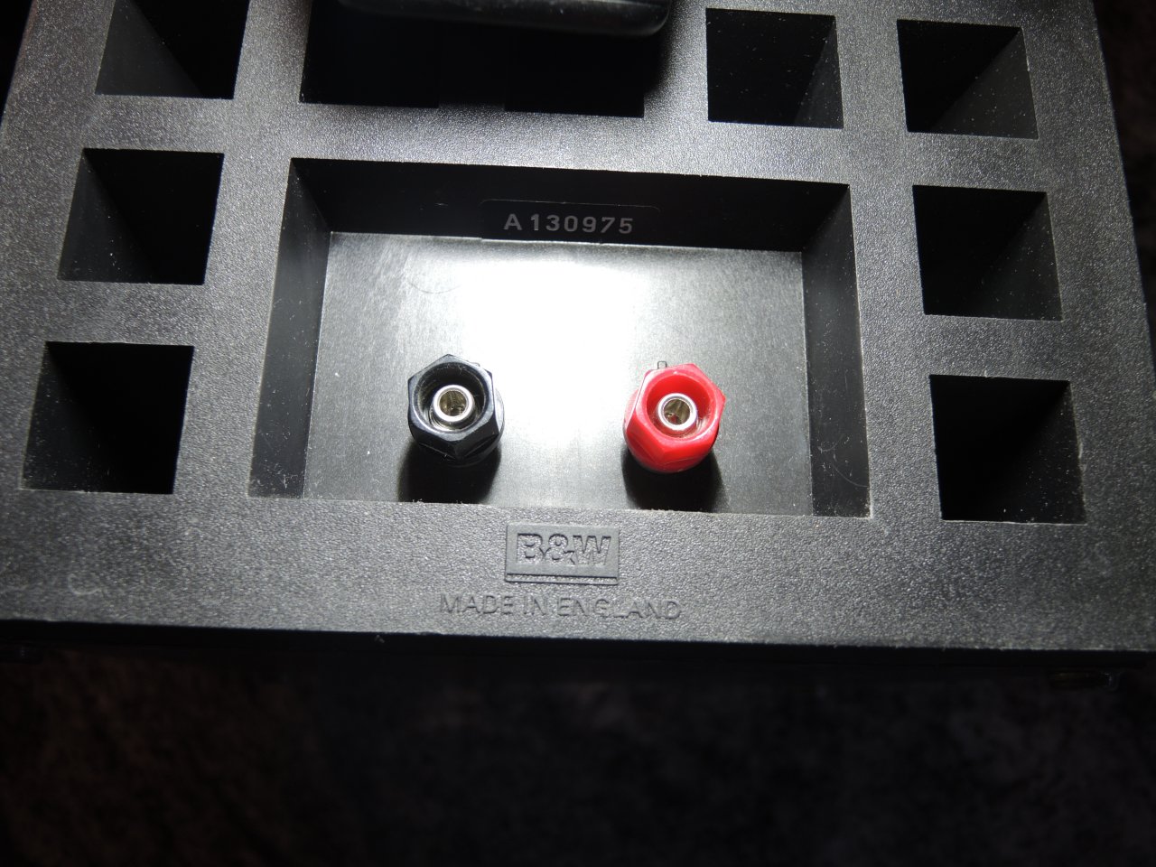

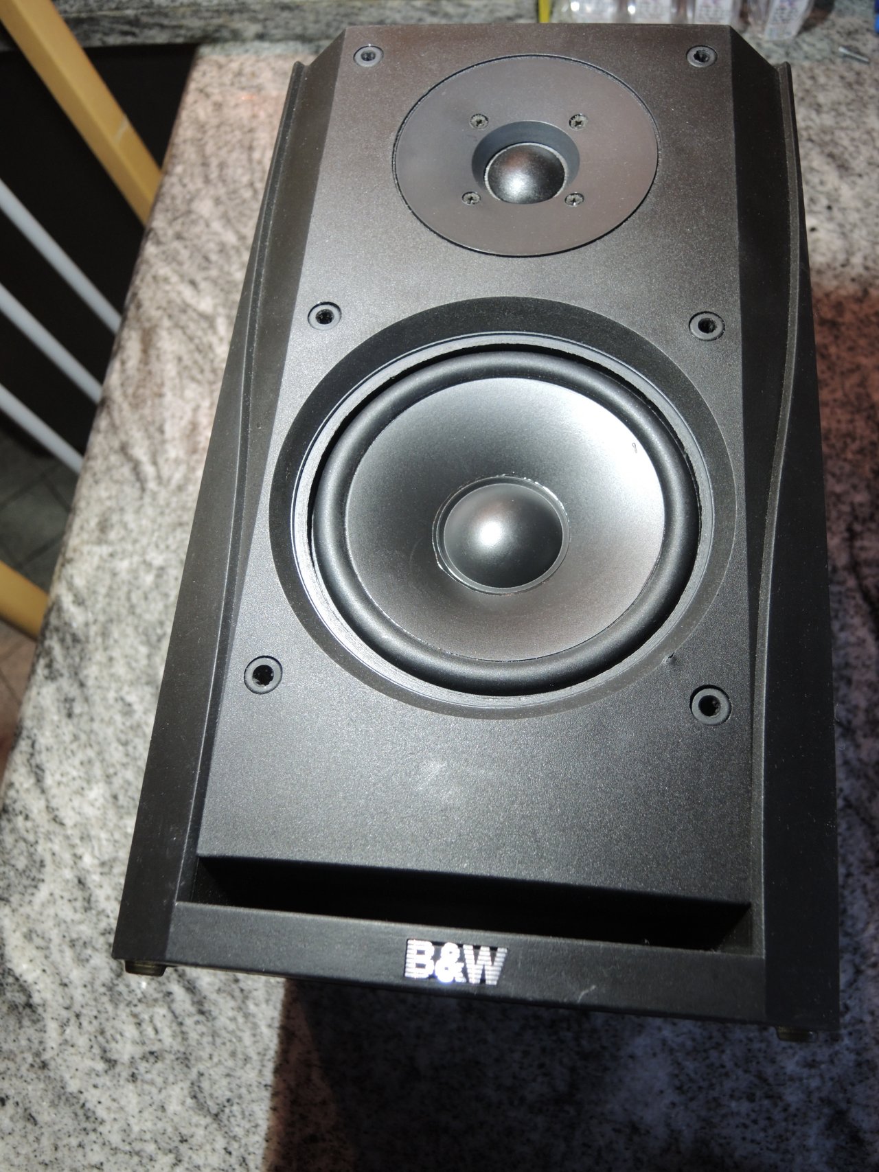

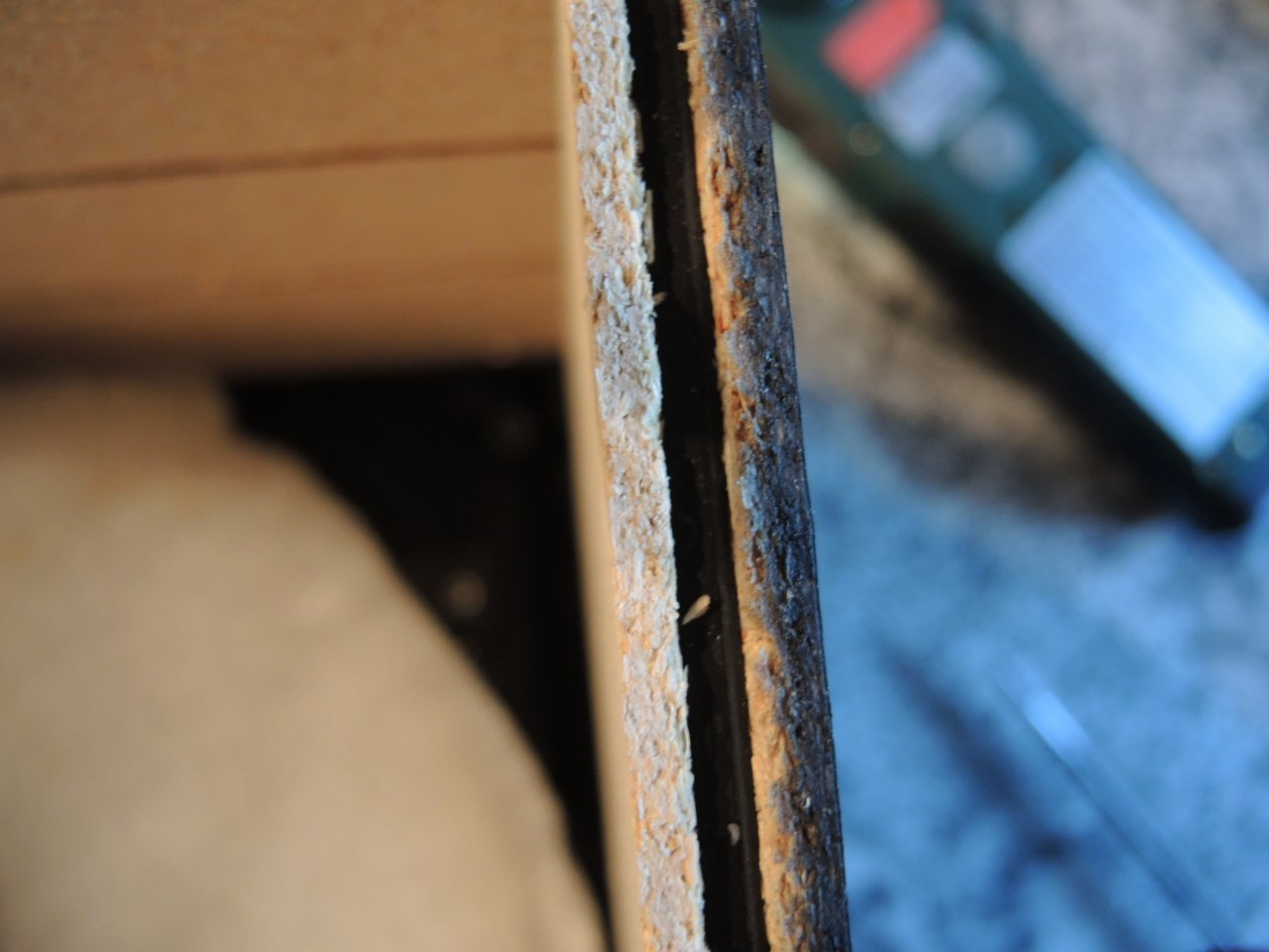

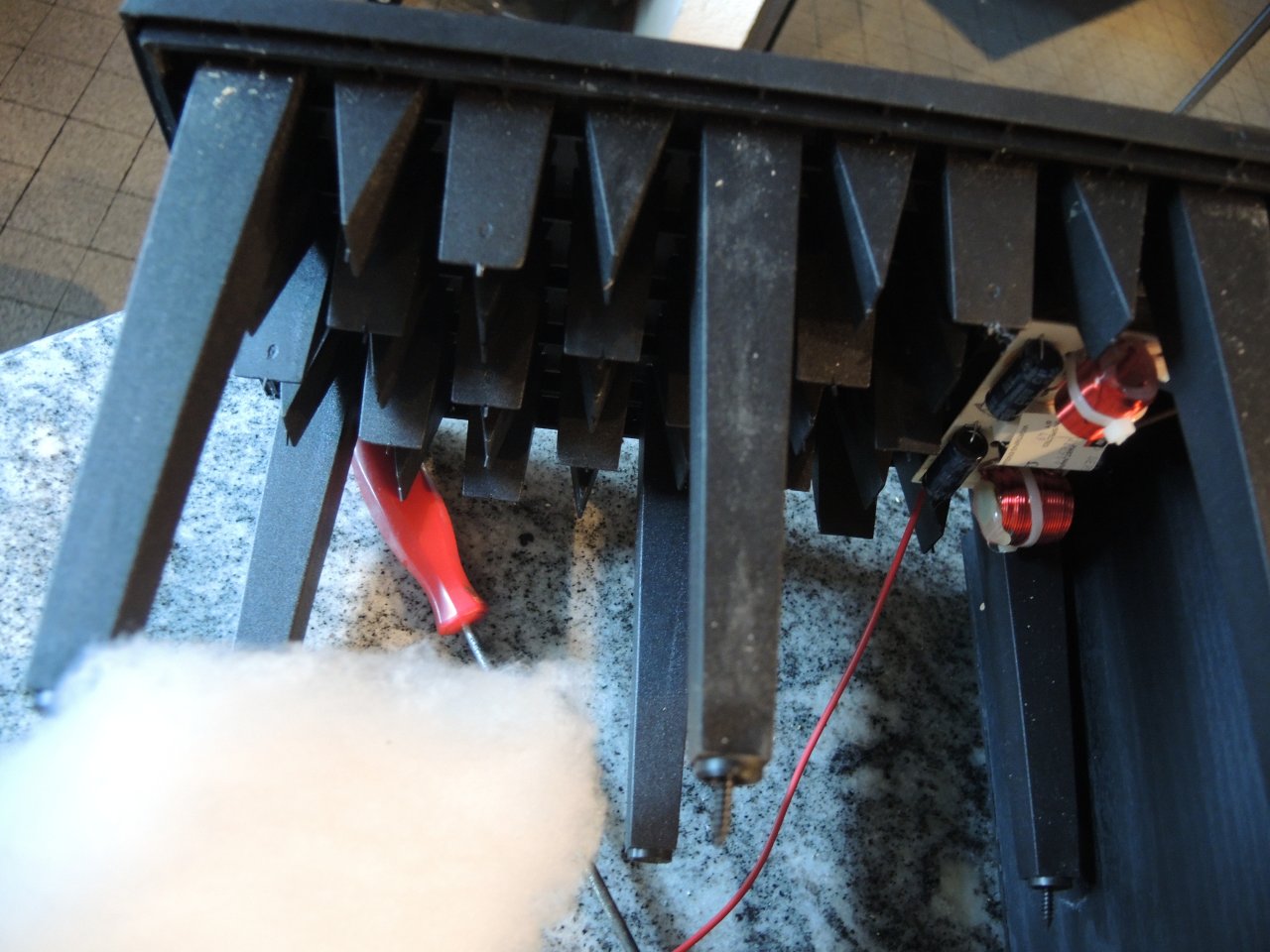

I have these Prism System of B&W.
And I'm very sorry, now I'm at home and took these 15minutes of my Valuable Time, to open up that B&W Prism System Shelf Speakers.
And I have to say, you are right they do not use MDF, at least not high quality, the sides are made of the lowest Quality I ever saw. I built loudspeaker for almost 25 Years, and we used MDF, but not such cheap stuff as I can find in here. I got these Speakers quite a long time ago, over ten years, and they were EXPENSIVE for the SIZE they have, but the sound it's what count.
But I understand, one can not know everything, it's just impossible, even he or her might think that he or her knows everything..
It's like a glass filled up with water to the top, so it can not be filled more.. A glass filled only half or three quarter with water, still can take some more water..
Anyway, No Harm done, but usually I do my research before I post.
Check out the pics, if you need more just let me know..

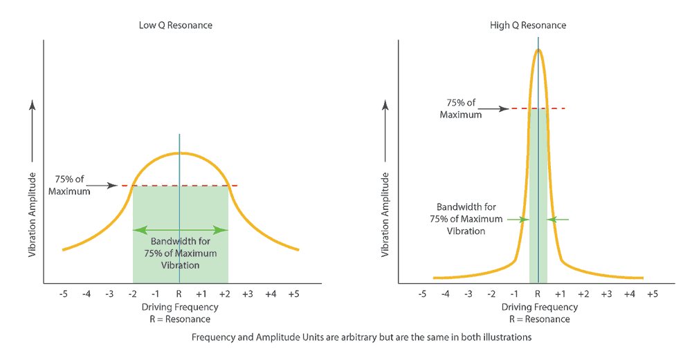

All materials resonate. MDF is heavy, not all that stiff, and tends to lower frequency, lower Q (potential) resonances, the broad Q means that lots of energy can get into the panel, is more likely to get moving, and is more audible when it does start moving. Higher mass pushes the (potential) resonance lower in frequency where it is more likely to get excited. When a speaker panel goes into full resonance it is as if it disappears.
Quality plywood is much stiffer, lighter, has higher Q resonances. This means that (potential) resonances are higher in frequency, higher in Q, and if well done much, much less likely to get excited. If a (potential) resnance never gets sufficient energy into it, it never gets excited enuff to move, and is as if there is no resonance.

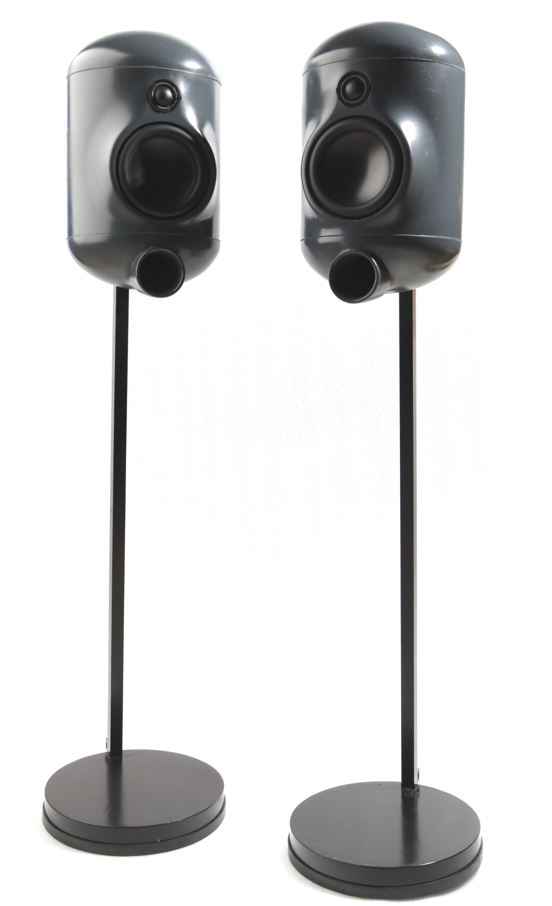

Flat panels of any kind of material are an outdated idea anyways. The reason is that modern production techniques allow for compound curves that make optimum use of material strengths. Plastic materials are the logical choice.
Loudspeakers are the only rectangular pressure vessels I know, made out of wood to boot.
Such material is ideal, If only it was easy for diy.
Howmuch would cost such a cabinet if one wanted to make one ?
3D printers are expensive for big pieces.
You need a company that can make you a mold and feel it... not cheap, well maybe in some countries but definitly not in western countries. Or... ?
