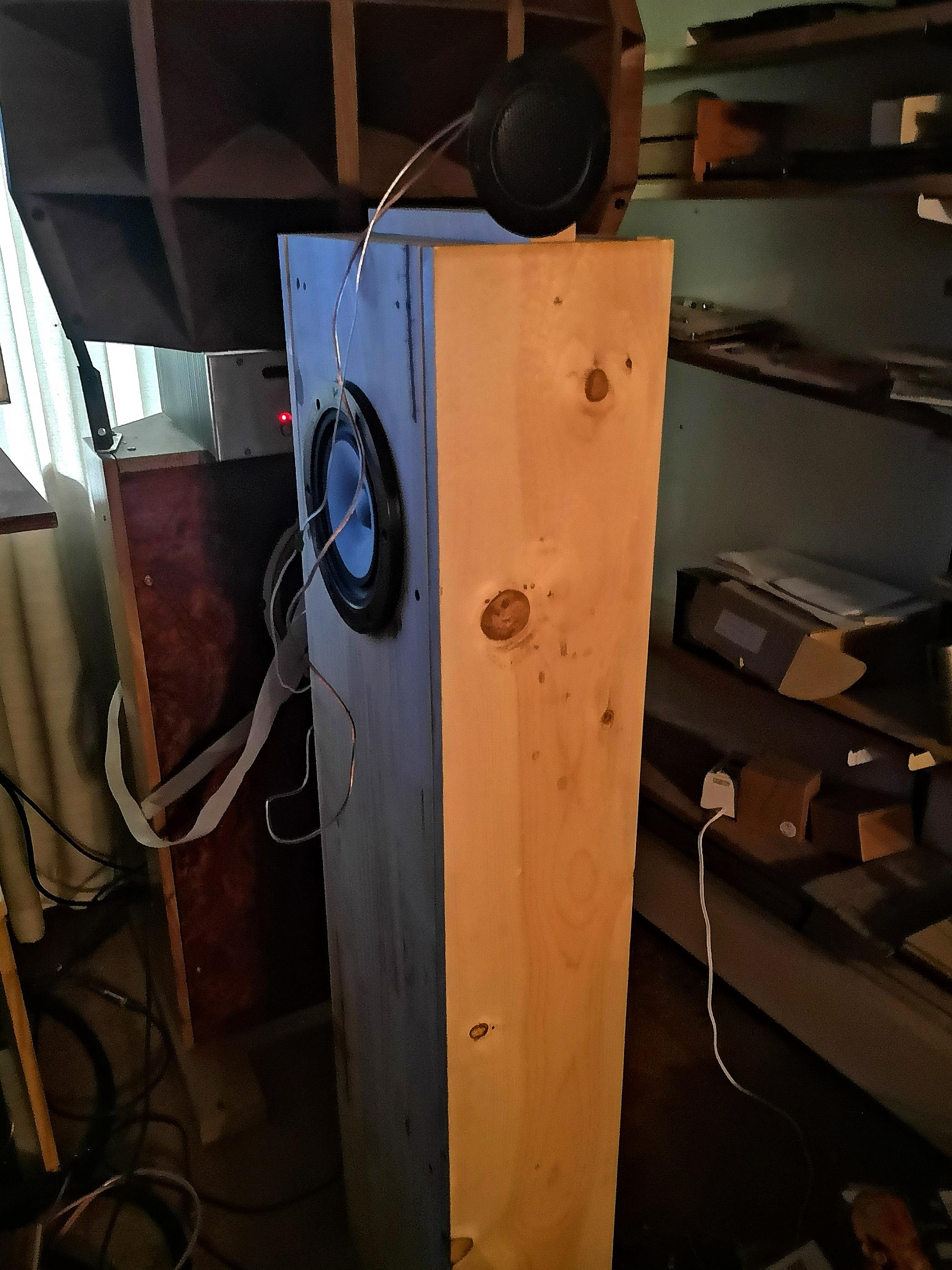

Hello all. No measurements, I just kept going over design ideas on this while hospitalized. Now almost 5 months later I finished one cabinet.
It's started life as a side firing bipolar tower, about 1.75ft3, with an Alpair 12P to the centre of the room, and an Alpair 12PW towards the nearer sidewall. No permanently installed tweeter as yet, just perching one stop the cabinet forward facing for tryouts.
The sealed cabinets are actively crossed to a subwoofer at 80 hertz 4th order.
The tweeter is very nearly not needed, unexpectedly. The forward baffle is about 7.2 inches wide, and I thought to cross the tweeters a at between 1200 and 2000 Hz for the billowy effect I'm after, but so far it's more like 7500 Hz.
Coming from dipole+horn hybrids, I wanted the spaciousness along with imaging in a much smaller speaker. I seem to have gotten that on the first try. No special tricks needed to cross a tweeter below its rated lower limit, so I'll be moving along to better ones soon, although I still quite like this Dynavox marketed inexpensive phenolic cone tweeter.

A12p + A12pw.
How do you deal with the about 3dB sensitivity difference? Are the 2 drivers in separat enclosures?
dave

I still have enough drivers to match if I want to. I'm counting on the different sensitivity to tune speaker placement in a normal sized living room. Mine in particular.
Just now I'm running them full range, about 3 feet off the front wall, the 12PW closest to it, 12P facing me without a tweeter. No filters used.
No separate enclosures.
I wanted a slightly warmer sounding enclosure than my last probably over braced ported cabinet. This one only braces the small baffles in Phi sequence. I use a digital graphic equalizer between the source and DAC to apply a shallow wide dip centred on 400 hertz.
I'm sure I'm not getting everything a purist build might out of them, but I think trading off the active analog crossovers, and a tacked on tweeter with a cap on it is a decent tradeoff as opposed to a traditional multiway.
There's enough bass that I'm in no rush to add a sub.
Parts are here from Dayton and Scanspeak to do so, but I don't really crave the bottom octave, when these produce enough harmonics for a good impression of deep deep bass.
A12P +A12PW +2604/832002
Back to the original sidefiring full range drivers.
A slightly less efficient than the summer full ranger output from a limited edition pair of Scanspeak fabric dome tweeters Butterworth filter helpers coming in at -3db 12,000 Hz is only audible to me by their comparative ommission, and seem as coherent as just a 12P alone, but in this enclosure with more heft down low, and a larger soundfield, yet focussed due to the tweeter.
I'll give it more time, but this is the best tweeter and cap value I've tried , and will likely make it permanent.
