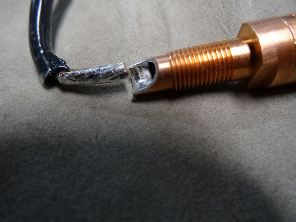

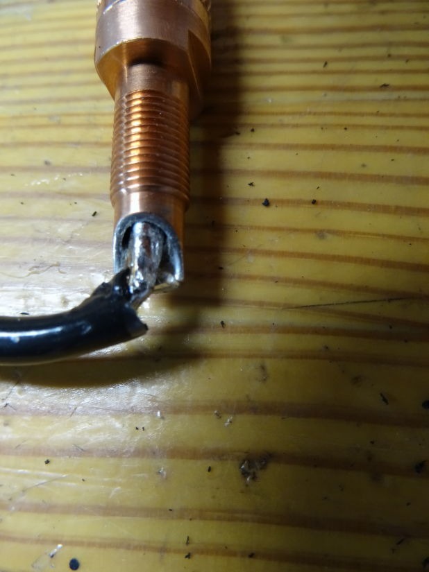

I thought the pics in post 12 showed both parts were tined properly since they are shiny and clean.
So what is the problemI thought the pics in post 12 showed both parts were tined properly since they are shiny and clean.

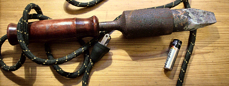

Much bigger iron is needed, I agree with Jon that that is not a good solder joint. The bigger iron may/may not reduce melted insulation since the joint will get to soldering heat more quickly. There is a reason I like teflon insulated wire.
The joint should be full of solder that has clearly formed a good bond with the wire and the binding post. No evidence here of good solder flow into the connection.
As I said the pics in post 12 are only the tinned wire and tinned post. The joint is not soldered.

There must be a limit to what can be soldered with an iron for electronic work. Perhaps you need to call a plumber 🙂

you need 100 to 150 watts of power to solder that. There should be a clean meniscus between the wire and the post.As I said the pics in post 12 are only the tinned wire and tinned post. The joint is not soldered.
