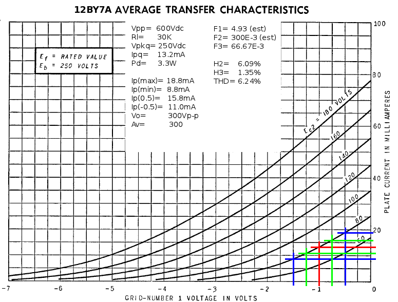

Can't do that. With these characteristics (attached) can't say no to 12BY7As (forch, I have a bunch already and an idea for 'em).
h2= 6.09%
h3= 1.35%
h4= -0.68%
THD= 6.28% (est)
Over a smaller output swing and/or use as an LTP and that distortion performance looks pretty good indeed, and it can swing a pretty good output. Expected since this was designed as a vid amp for color TVs. Only problem is that this one likes a high DC rail, which, of course, wasn't really a problem as there is no lack of high voltage in a color TV.

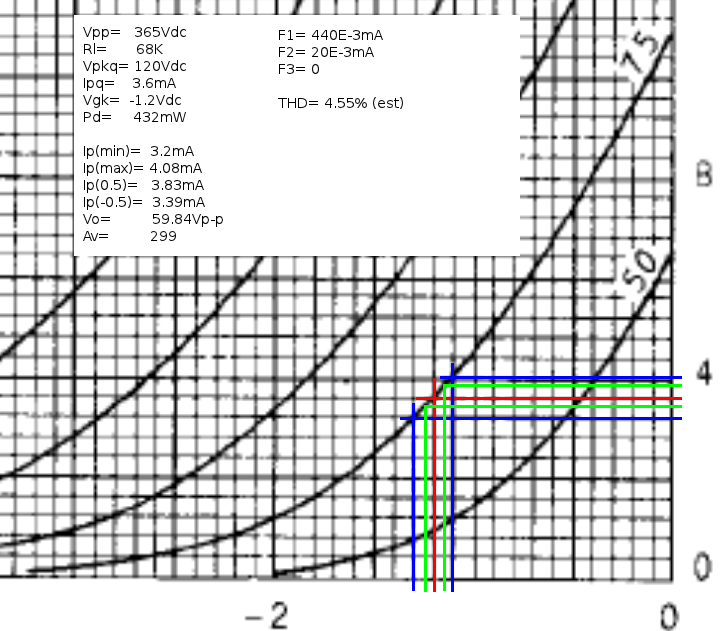

Another type that looks really good is the 6CB6 (attached)
h2= 4.55%
h3= 0
h4= 0
THD= 4.55% (est)
Who says pents have to make higher order harmonics? 🙂 As an LTP splitter, this should be pretty clean.

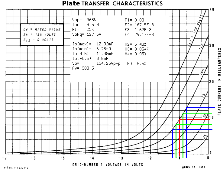

This one ain't so bad either (6DJ6):
h2= 5.43%
h3= 0.054%
h4= 0.95%
THD= 5.5%
No need to be afraid of using pents for an audio design.
