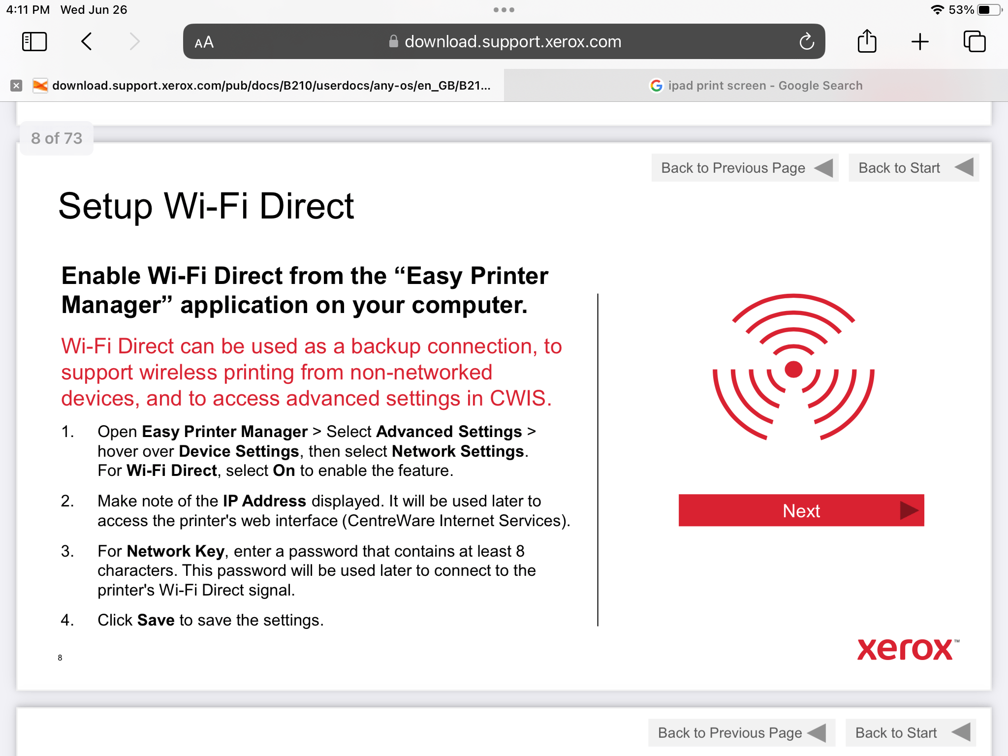

I have a router connected to 2 Raspberry Pis . ( via ethernet cables )
My printer is Xerox B210 .
When I turn on the printer , it appears on the wi fi selections on the Pis .....
( wi-fi vs wi-fi direct ? )
It would appear that if I had the 'key' I could hook up ?
The suggestion of serial number as key does not work .
I am considering another printer , but would not want a repeat experience .

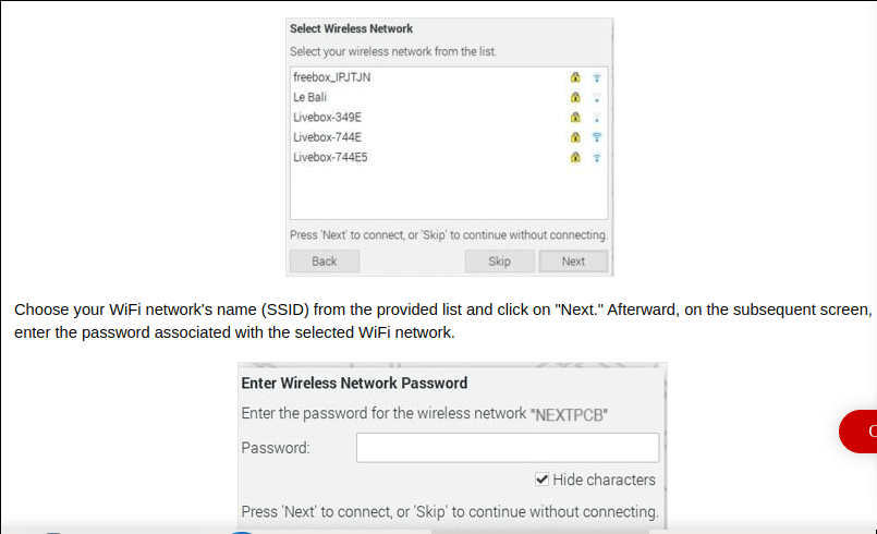

A quick look on Googl showed a YT video on how to connect a B210. BUT - you have to have the "setup" CD/DVD that came with the printer. The process involves first loading the CD into the drive and running the executable on it, connecting the printer to the PC via a USB cable, then telling the printer through the software and USB cable that you want it to use WiFi, providing the local WiFi name and password.My printer is Xerox B210 .
At least on the color Brother, you can do all that from its panel controls. I captured the how-to video and maybe I can get it to you somehow, if you have the install disc on hand. Without that disc, I'm unsure if I can help out further. Running a different OS than Windows, I'm also unsure if I can help out further. You'll probably need to obtain, or make a copy of that Xerox install disc in order to proceed successfully.
To me, such a "detail" is a super PITA, as without the little piece of plastic, the whole machine possibly goes to the junkpile. One would think they could put that executable file into the printers USB connection somehow - like any USB stick - and have their running program sail past the "drive functionality" and into the printer BIOS to program it.

Most of the time, a printer will be set to get an ip from your wireless network and it would need to be configured to connect to your wireless network, using the SSID (network name) and password you would have set up. If you have a switch or router with an open port you can probably connect the printer to it and have it on your network.
The printer is just a device that wants to connect to a network, once it’s on the network you connect to it. I doubt it would have the ability to provide a network that you could connect to. I hope I didn’t mix up the question.

It shows up ( on my pc ) as an address in the same manner as the router ...... But I have no key ....I doubt it would have the ability to provide a network that you could connect to.
