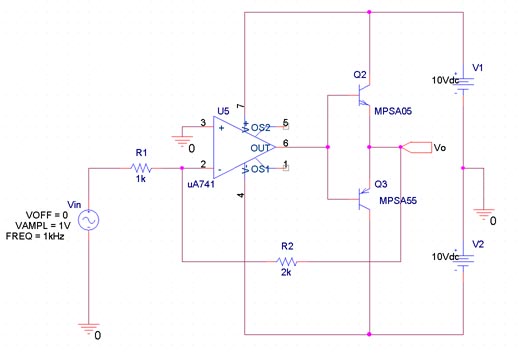

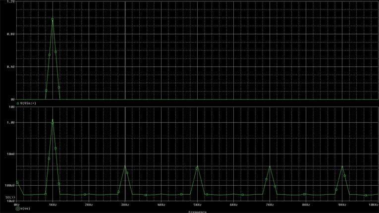

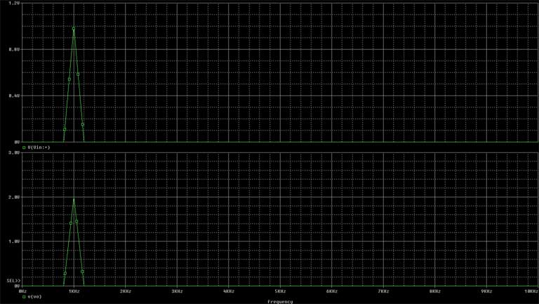

w/rt to distortion, here's a spice sim of a class B in a feedback amplifier and a fft of the output, what is it that spice doesn't know about?
I think you should change your Y axis scale. Now it is linear and higher harmonics will not be visible, because the amplitude may be 1/1000 of the fundamental or less.
First change the scale to logarithmic or dB, then look again.

azira said:w/rt to distortion, here's a spice sim of a class B in a feedback amplifier and a fft of the output, what is it that spice doesn't know about?

3) Thank you Steven for the tip on the crossover distortion, feedback won't remove it. Here is the sim output with a log plot for anyone who's interested.

Shows some of the limitations of the simulator.
No even harmonics -> transistor models are perfectly symmetrical.

Not fast enough, because of fundamental electrical principles.
(Unless the simulator assumes the op-amp has infinite gain
and infinite speed, in this case its not much of a simulator)
It is, however, arguable (or unlikely depending on your perspective) that the same is true with real life circuits or simulations using reasonably good models.

Should be obvious the unity gain 741 is a very poor choice.
isn't that exactly what perfect opamps are?
there's no such thing as a perfect Op-Amp and its utterly pointless
discussing real Class B topologies with the assumption that they exist.
😉 sreten.

I think that we've reached a conclusion then. In the topology outlined (whatever it may be decided to be classified, I labeled it Class B per the definition in my textbook(s) ). Thermal runaway will not occur because a fixed bias isn't being applied. Other issues, which also exists in many other topologies, will still likely be of note such as device overheating.

With respect to the feedback. Here is my perspective.
The feedback gain is: Ao / 1+ (Ao/B). We like to simplify this to 1/B which assumes that Ao is "significantly large". This is convenient because this means that even if Ao isn't a perfectly linear function (ie. has distortion), as long as it remains large, this equation will simplify still to 1/B.
However, at the crossover band, the Ao is not significantly large, it is 0 so that would suggest that feedback will not be effective in this range.
Actually now an interesting discussion would be, why is it then that feedback DOES do something to eliminate crossover distortion in this area when mathematically it shouldn't? Because it is delayed by the slew? Or maybe because the gain isn't truely modeled by a piecewise function.
Danny
