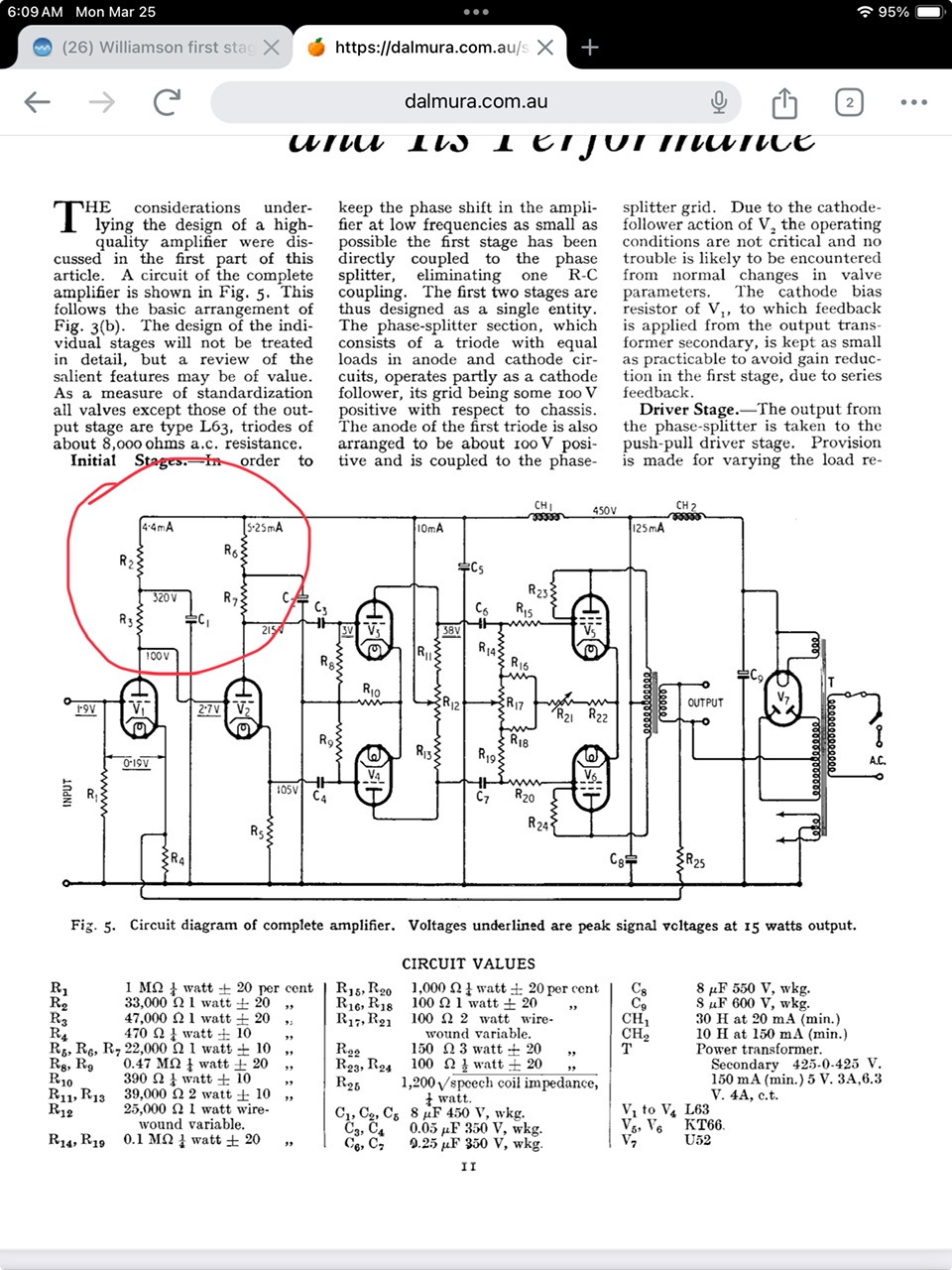

Hello. Working into a Williamson project, kind of. I can get 100 Vdc above onto the first plate supplying the first stage with the same 400Vdc as cathodyne did with 100k plate / 1k cathode resistors. I know the original scheme used 47k/ 470 ohm suplied at 250v above to get the same current. But the swing is minimal, I drived the amp with 200mVpk without nfb applied. Does it make a dramatic difference in respect with original circuit please ? Thanks.
This is my actual circuit.

The original Williamson design is carefully made, so if you are planning to build a real Williamson amplifier, you should stick to the schematic. The first two stages must be decoupled to ensure stability when feedback is applied. That's why the designer used a 33K resistor and a decoupling capacitor to drop the supply voltage to the input stage and isolate it from the the other stages.
If you're not planning to use feedback, then I suppose you can do anything you want. ;-) But if you are planning to add feedback, you should stick to the original design because it works best.
When you mention a 250 volts supply for the first stage, you may be referring to an "American" style Williamson, derived the "Musician's Amplifier" and used by Heathkit in their designs. This has a different decoupling scheme that results in a lower plate supply to the first stage. The two decoupling resistors (22K, 33K) here are in series, rather than in parallel like the original design. It also works, but it does reduce the headroom available to the first stage and results in slightly more distortion.
Reactions: 1 user
In the original circuit, the first stage has approximately 20dB less gain with feedback connected, so signal swing on the anode is much less during operation, and hence having a large signal swing is not a concern (although signal swing increases at very low and very high frequencies where feedback is reducing from nominal 20dB).
As indicated, it's the subtleties of power supply decoupling that may have significant performance consequences, along with subtle high frequency parasitic differences that cause gain and phase shift where they may not be welcome. Nowadays, LF stability can be maintained through other means, so maybe changing the decoupling is not such a concern, but caveat emptor. Similarly, high frequency stability is principally influenced by the output transformer, and first stage parasitics are likely to be second order effects.
Also note that final amplifier distortion is dominated by output stage valves, then driver stage valves, with input stage and PI stage valves a distant last, and mainly due to an increasing signal voltage swing from input to output.

See the rest of the circuits. The unbypassed cathode resistor is the feedback return point. It becomes part of the feedback voltage divider so it is necessary even though it provides some degeneration in the first stage. To minimize this degeneration, reduce the feedback network values. Then bypass whatever portion is needed to get the DC bias point right. Only needed or wanted if you want the increased OLG. Unbypassed rk also increases effective Ra by the same factor as it degenerates, so the reduction in gain is not always severe if the resistor in the plate is large.

Unless I'm mistaken, and perhaps Tim can chime in on this point, the common cathode on the driver stage is kind of key to the good performance of the Williamson, as is the common cathode resistance on the output stage. It's very tempting to "improve" upon the Williamson, but apart from the addition of stabilization networks and shifting the driver stage to a slightly more comfortable place, it really all works as designed and produces very low distortion.

Did a fault find on a sim amp some years ago and found the diff drivers 6SN7 joint cathode resistance of 390R is woefully low. 1K at least to see 7-8V on this point with 430-450V B+.
Talbot Wright recommended increasing the driver stage cathode resistance to 1k in 1962 [ https://dalmura.com.au/static/williamson_verstaerker.pdf ]. Imho Wright presented results that were in general sparse and subjectively presented. Whilst a cursory view of the driver stage loadline indicates improved headroom from increasing the cathode resistance, in practise the driver stage only approaches its swing limits when the output stage is dominating the distortion profile.
A few years ago I went through my collection of 6SN7 and 12AU7 and measured the variation in harmonic distortion coming out of the driver stage (with no gnfb) for 10Vrms output condition. As indicated by others, the 6SN7 clearly exhibited lower harmonic distortion levels than the 12AU7. For the 6SN7, the 2nd harmonic was by far the largest harmonic contributor, and the variation within my sample size of thirteen indicated tube swapping would be well worthwhile if distortion prior to the output stage was a concern. For one sample 6SN7, I compared driver stage output distortion for two cathode resistances of default 390R, and 680R, for output signal levels of 10V, 20V and 25Vrms, and found that the original 390R showed slightly lower 2nd H for all three output signal levels.
This indicates that well-meaning tweaks, and simulation results, may not end in a benefit and are best checked for results in-circuit.
