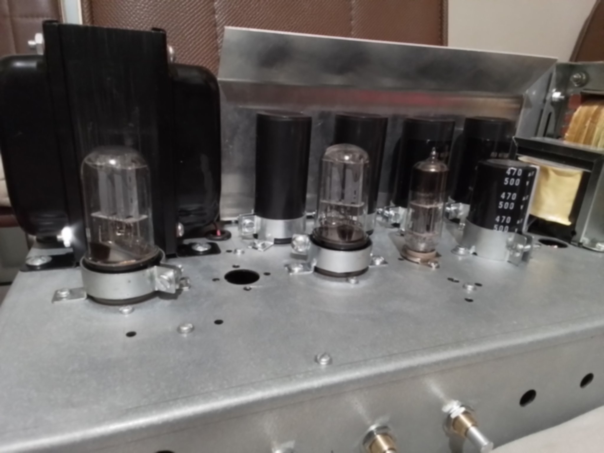

I think it depends on the 6SN7. I use NOS GE 6SN7GTB and rarely come across a microphonic one. Same with Sylvania 6SN7WGT. Are those Russian 6SN7s in the photo? You might have to do some selecting.

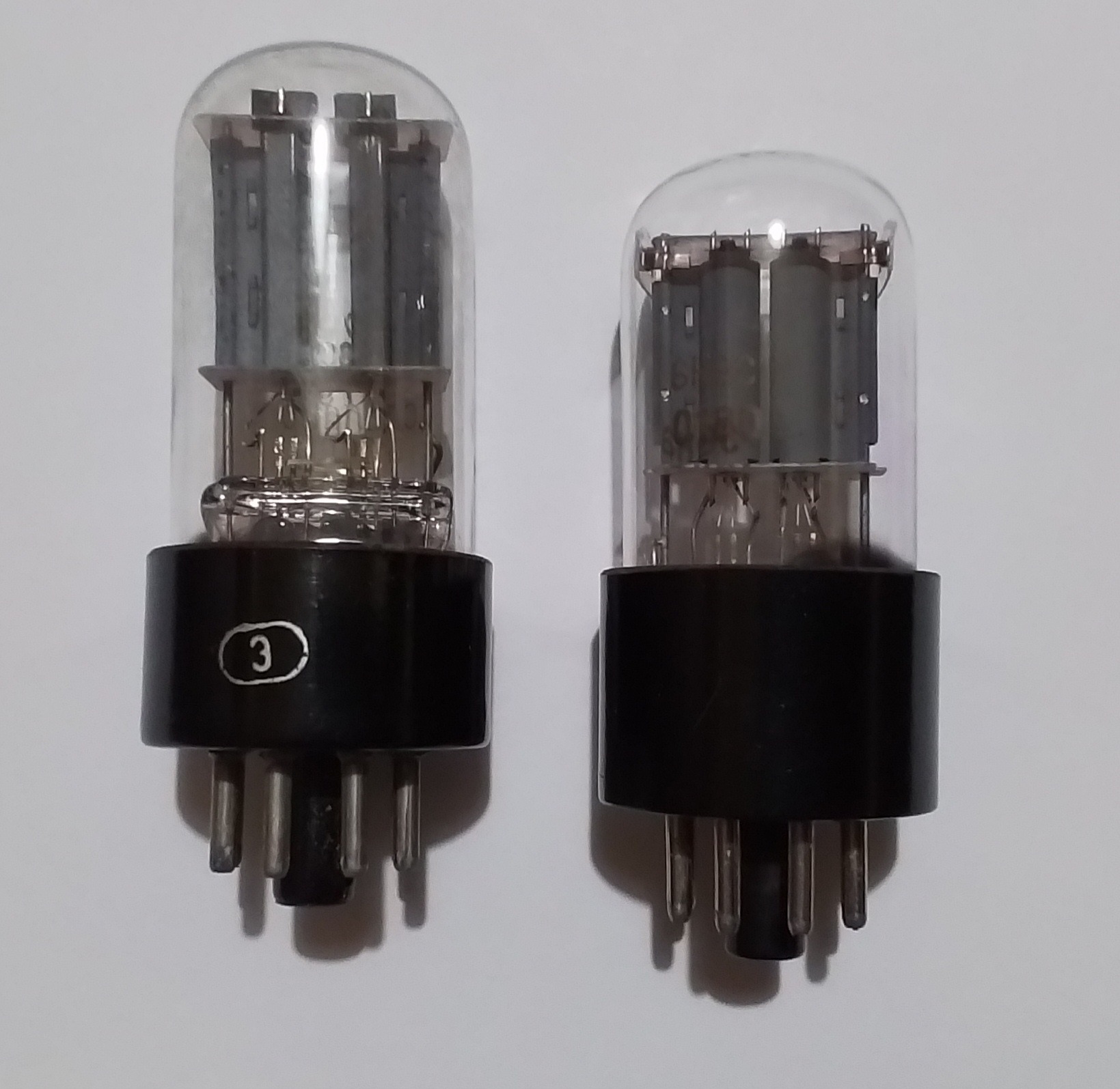

You ain´t heard nothin´yet...... One can do worse by going over to some tubes designated for early TV and note the microphony differences when compared to audio types. Video line pentodes can be particulary noisy and sensitive to knocks as manufacturers didn´t bother about high distortion nor microphony.. The only way around this is to buy several (50 off cheap at car boot sales or ebay) and test individually for the best, strap them as triodes and hope for the best, or fit acoustic type screening cans.. OMO, the 6SN7 as an medium mu tube, scores pretty good with lowish noise.

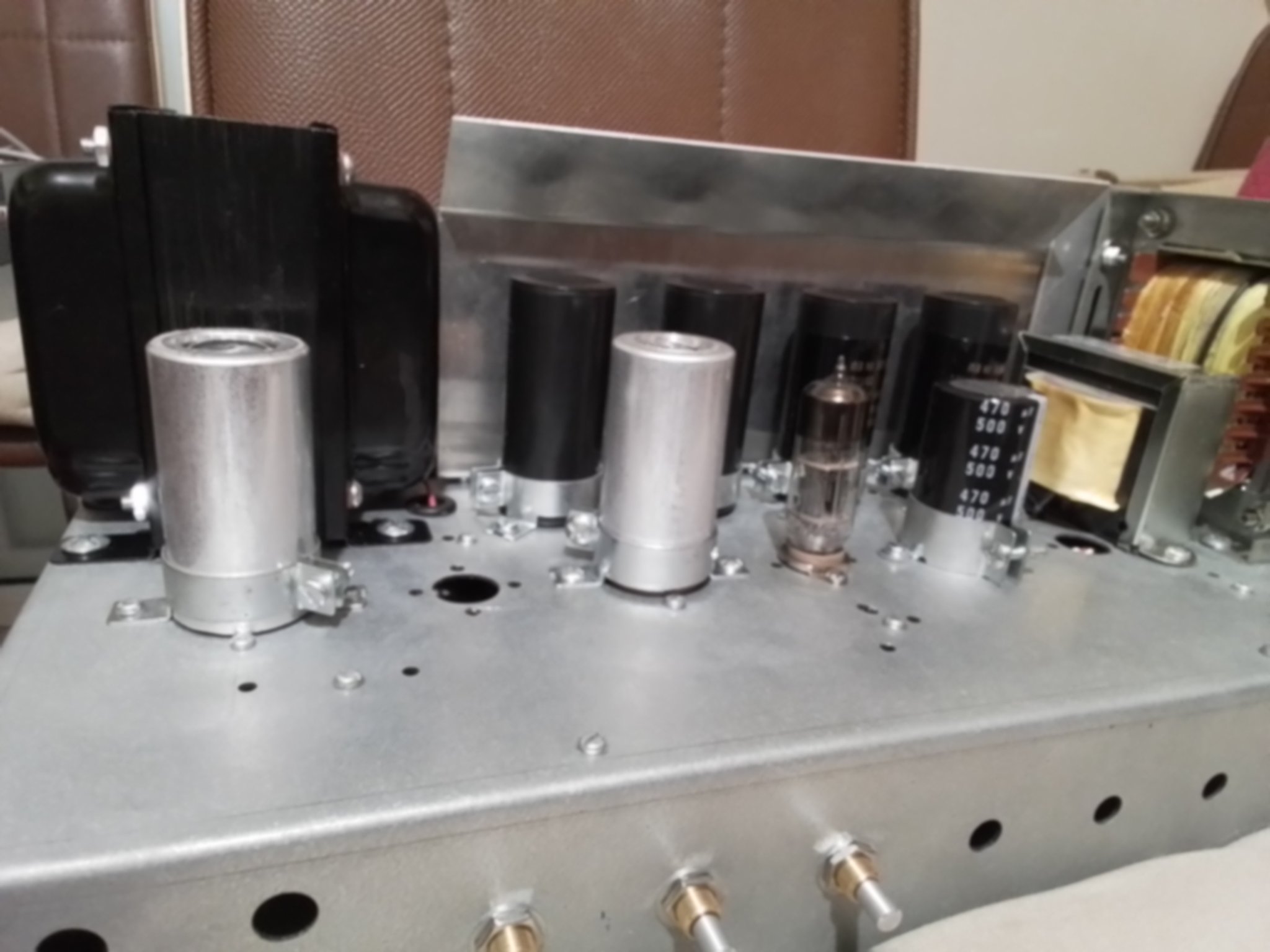

The tubes are not microfonic in a sense that mean sensitive to EM fields . More, I shielded it with tube cages made from old used caps to be sure never happen. The mechanical structure is a compromise. I have few couples of these and are more or less the same. I put a picture: left 6sn7, 6sl7 on the right ( okay there are Russian equivalents) Despite the highest gain the 6sl7 get a lower rattle noise than 6sn7 in the left.

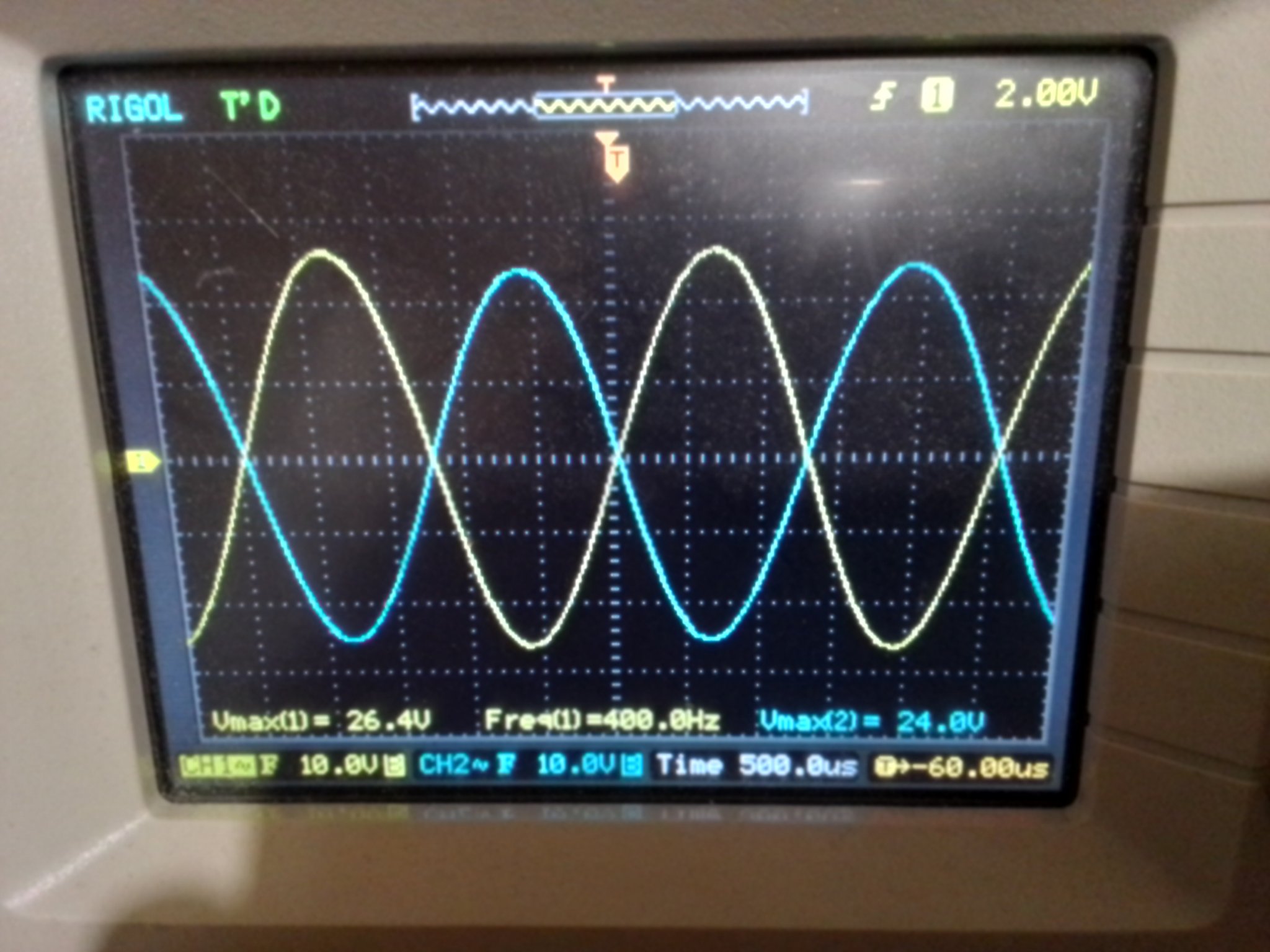

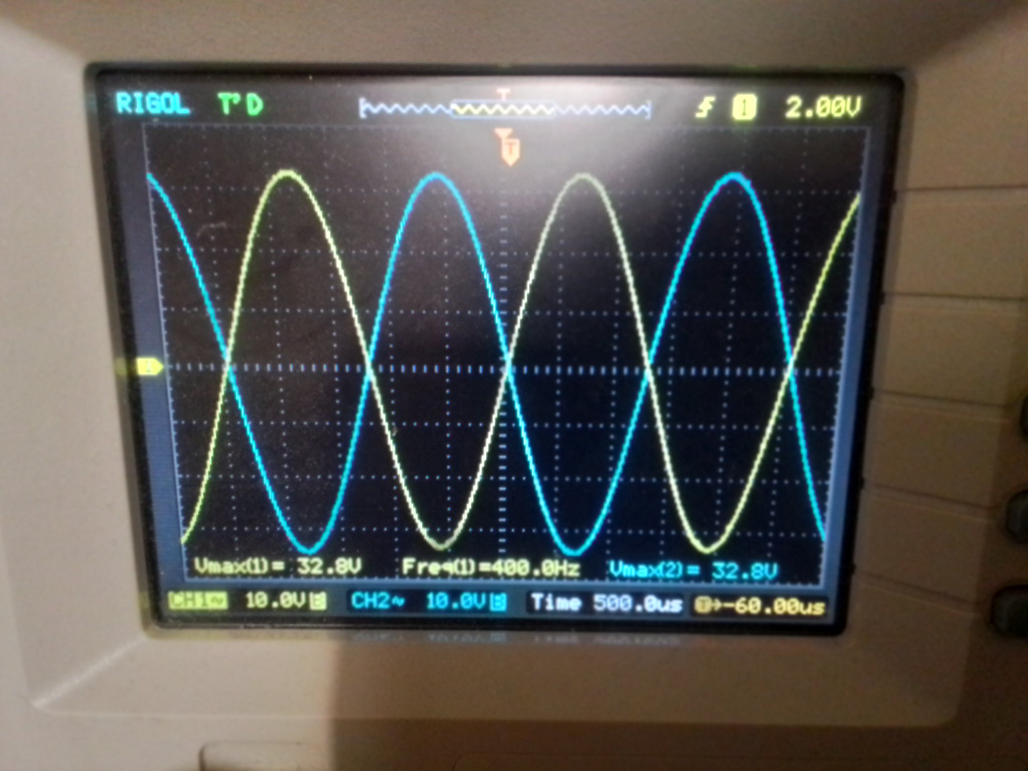

How to fix AC balance at drivers output please ? The DC offset is pretty good - less than 100mV at plates but AC swing shows more than 2Vpk difference. The signal at cathodyne output is also perfect balanced. Is just a matter of gain diference between two sections of driver I used. How can be fixed to get same balanced AC signal at power inputs please? -My drivers do not work in common mode, there are independent, individual biased- Thanks.
