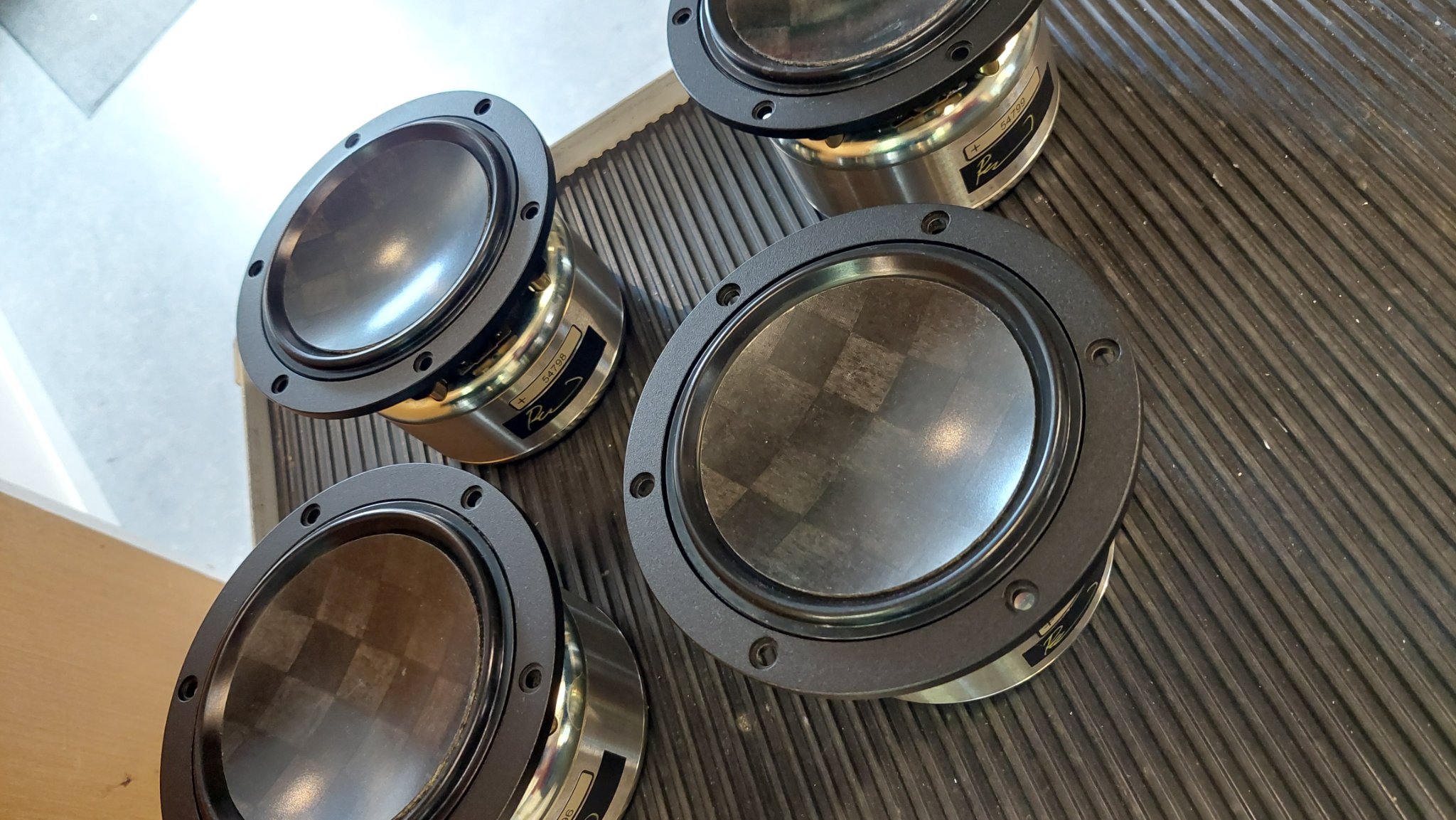

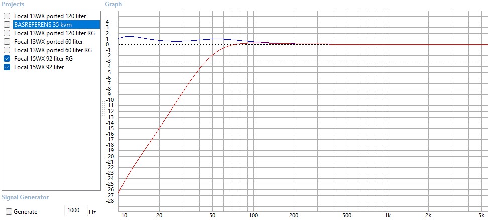

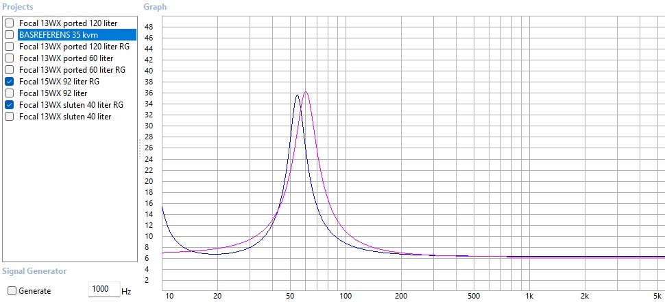

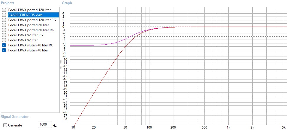

I have a pair of focal audiom 13wx and pair of audiom 15wx
I need an help regarding to make a clone of the wilson audio alexandria xlf
If there is anyone in this group who has a friend with the real wilson and can supply measurements of the bass enclosure and the port measurements.

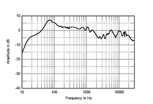

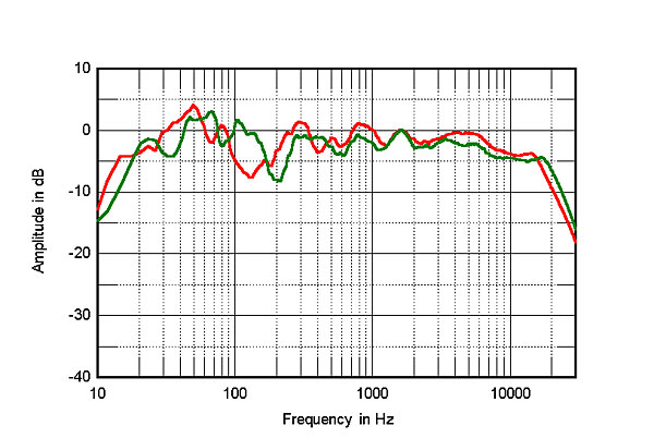

You might want to reconsider this statement. I have no intention to start a discussion about this here. But do you have access to polars and BD plots of this speaker?Sharp edges cause diffraction and have nothing to do with the spread pattern when going from 2pi to 4pi radiation.

Sorry, I've no intention to come over rude but: you don't present polars nor BD plots of the bespoke Wilson. Instead you want to discuss acoustics. Then please: why does baffle step occur? And: I didn't start about diffraction at sharp edges of enclosures. You did.
