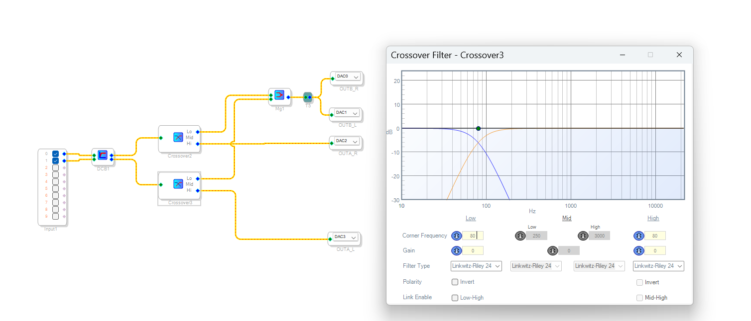

I just got this device, and I want to set up 2.1 sound and use it as a preamp and crossover to send sound to my main amp and speakers, and lows to my subs.
They give this example:
But it has a few problems. The high-pass varies from 3000 to 20,000hz for some reason, when it really should be in the 80-200 range. It uses a 6dB slope filter, which is no better than a $1 capacitor. Sigma Studio has a Crossover Filter with a Linkwitz-Riley-24 and they should use that.
I simplified the program and used a better crossover filter. Next I think I will program in my high-frequency hearing loss, and also put in a curve for my room using my measurement microphone. I am not using any of the pots at this point. So far, it has been good but I am interested in seeing what other code examples people have.
You can use any file for the ADAU1701 on the board. Do not expect any help from WONDOM. They are a hardware distribution and have no software engineers. They promised years ago some GUI for the 1701 which didn't materialize. You got to work with SigmaStudio and the examples you find online.
SigmaStudio is a very mighty tool, not made for end user, but developers that need to implement a DSP in their hardware and projects. The end user should only use the mentioned pots.

As far as protecting tweeters, I measured my hearing loss, and above 4000hz it really drops off to about 60dB below normal at 4000hz and higher. I find that hard to believe as music sounds normal to me, and I don't have trouble hearing people. But I used a few different hearing test programs and those are the graphs I get.
The DSP will allow up to 30dB of boost, and there must a reason why treble controls typically provide no more than 15dB of boost. Should I do a high-shelf filter and set it to +15? Or is it safe to go to +20dB? I want to sometime be able to play the system loud (though I never turn my amp past the 12 o'clock position because I know about distortion).

Tweeter protection is only if you do a two way active speaker, not critical with a 2.1 sub installation. I just wanted to warn about the possibility that unexpected sounds can come out of the DSP while tuning with SigmaStudio if you enter some wrong value. What happens quite easy, as SS is so mighty. No safety features included...

I am having issues with downloading to the 1701 works sometimes but often hangs. I have tried restarting SigmaStudio, which seemed to work once. Unplugging power and cables and plugging them back in. I have tried two PCs. I have not found a way to have it work most of the time.
I just added 20dB shelf above 4000 and wow - I can hear stuff I forgot existed. As mentioned, my hearing in everyday life appears normal to me. I dialed it back to 15dB and will see how that goes.
SigmaStudio needs some 64 bit Windows. Next the installation of the driver for the programing interface is very critical. If this is OK and the right jumper set, anything worked very stable with mine. I use some cheap no name cypress CY7C68013A logic analyser like this one https://www.ebay.de/itm/116377118153
