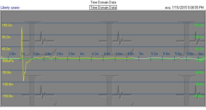

Attached here is how a S-S Illuminator 7" 4Ohm + RAAL 140-15D look like in response together, nothing but 2nd order, with Zobel network on S-S:
Now, if isn't done right down to the detail (and that usually takes time), all talk of realistic sound of this or that, or micro-macro dynamics is pointless...Especially if you don't have your own recordings to use as a reference point. I do and people that I design the speakers for, do also, and telling here what they think of the monitors would feel like tasteless bragging.
Simply, the sound is made by the complete interaction between components.
For some anomalies, you compensate, some are sorted out on the own, some you will never solve, whatever you speaker integration approach is.
In the end, once you do everything right with the crossover, baffle size, time-alignment, dampening, voicing, positioning in the room...you're left with inherent quality of the drivers used to define the sound.
While RAALs are not ideal, nothing is, they will do 2.5-3k with no problems whatsoever, regarding dynamics and distortion, when used in accordance to long established good practices in speaker integration, and from that point on, it will be very, very hard to match that performance. Sounds stupid when I say it, but I'm not the only one, so I'm not blushing when saying it.
As you can see, I reverted back to 2nd order filters (in both 2-way and 3-way) as I get the best combined impulse response with them. While the cleanup of bass-mid's upper-end garbage is not as effective as with higher orders, the sound is better than if the impulse response does not look like this.
When the project allows for it, in 3-way, I do not use a single 6-7" cone driver for the mid range, but a group of 6 x 3" Aluminum cone full-range drivers. Those have the first problem at 11k (a 3dB high peak), so they allow the above explained approach to bloom to it's full potential. And they will surpass any single cone driver in dynamics and clarity, no matter the kind.
And so on and so forth...thank you for the attention!
