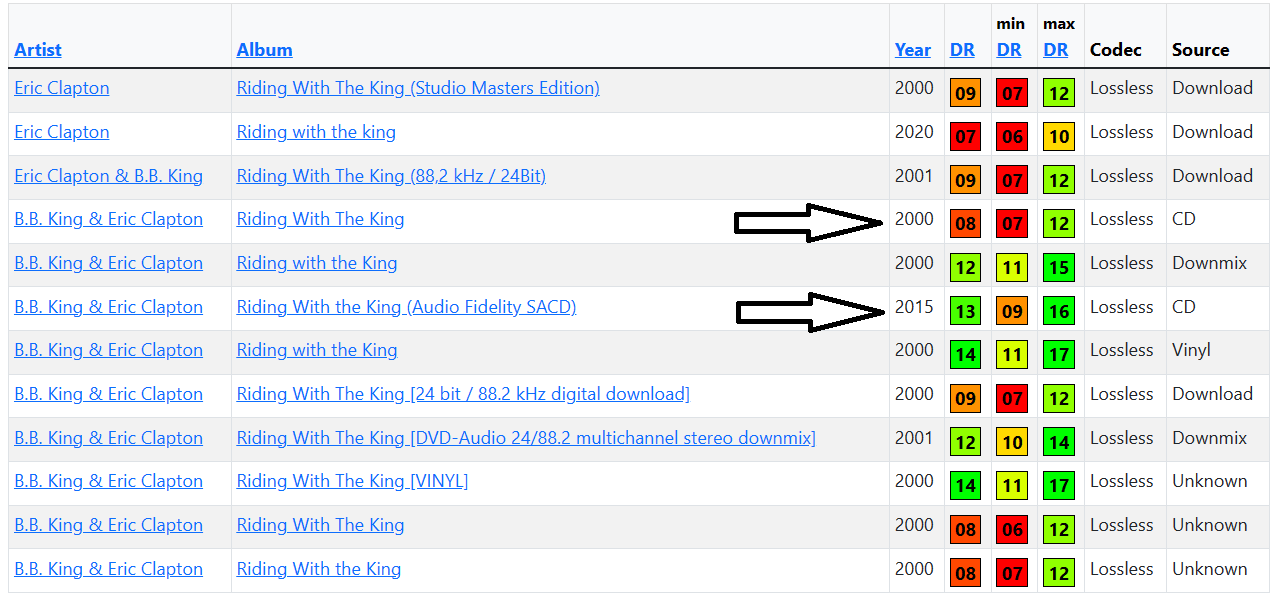

I have a couple of examples here, where I have both masters.
The original CD here is quite hot. Mastering engineer unknown (?). The Audio Fidelity SACD is more dynamic, and was mastered by Steve Hoffman.
From a pure listening perspective I prefer the original CD over the Hoffman remaster. It has better balance between each track, and sounds warmer.
I also have the 5.1 multichannel mix on DVD. This was mastered by Bob Ludwig. It's subjectively quite hot, but superior to any 2-channel edition of this album.

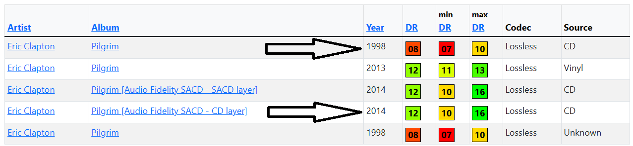

An other one with Eric Clapton. The difference in DR is quite large, but I still prefer the less dynamic mastering... because it sounds nicer. It was mastered by the great Bob Ludwig. The Audio Fidelity SACD sounds like crap in comparison.

Thanks. Believe it or not, I have a lot of respect for you. I didn't know your profession (or perhaps presently your former profession) before this thread due to your different viewpoints from the other mastering people that I have met or conversed with. I think some of the problems I have run into with those that perform mastering services may be related to local professional culture (popular music--not classical) in the geographic region where I live--which seems much more heavy-handed with its mastering practices here and non-apologetic about the results.I have a lot of respect for Cask05 but thoughts i would had an heart attack when i read he select music based on crest factor / dynamic range.
Since many of the older CDs (now I'm talking versions typically made before 1991) with higher crest average factors have little or no mastering processing compared to the present state of affairs, they are much more like downmix tracks (without additional stem processing) than much more recent versions of the same album. That allows me to re-EQ them to achieve a much more enjoyable result locally than any later versions that I've heard with lower DR ratings. YMMV.
In the particular case of Riding with the King, I have since learned of one more necessary ingredient for more pleasing reproduction in-room (that you might not yet have discovered): flat phase response. Once this factor is added to the mix on a setup with full-range directivity control and in-room control of early reflections (side walls, front wall, floor bounce, etc.), the more dynamic recordings simply sound more natural and alive (greater presence). As such, the higher DR version after demastering EQ sound much better to my ears, and that is the version that I have retained and listen to. In other words, what you are listening to (the loudspeakers and their setup) may affect which version of the CD album you prefer, with direct radiating loudspeakers having much more trouble producing a good result with more dynamic recordings.

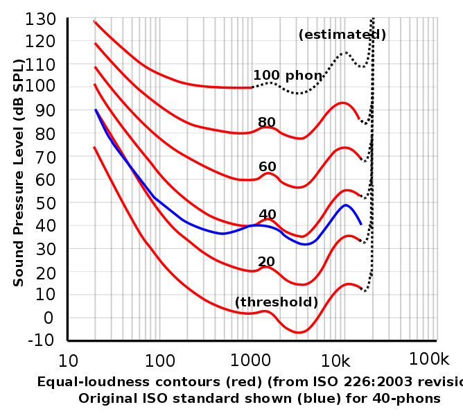

Rongon, try to replay McCoy Tyner's with same calibrating as Bob Katz ( which is 83db spl @ listening spot): it should sound very nice as is.
Bob Katz works at relatively high level. He have good explanation about it but nevertheless it is already highish level imo.
This is a real issue and why there is differences in how we perceive the different results: if it was produced/ mastered at too loud level outcome will be thin sounding played back softer... if mastered too low spl, it'll most of the time end being up too bass/high heavy ( 'smiley' eq) AND overcompressed*.
* the 83dbspl reference come from movie: in 70's Dolby choosed this reference for theater mixing. It allow for high enough level ( at that period it changed with THX) and for music it gives 6db headroom in case the material needs it: iow the reference level at which B.Katz works is 83dbspl MAX output level and his settings on volume knob is -6db when working on audio. It makes sense in case of a mastering facility as you can encounter high dynamic range material but for home listening it can be relaxed to 77dbspl @ listening spot with level maxed up ( 0db). If you listen to classical or 'purist' recording ( true stereo recording technique with only a pair of mic and no compression applied) then rather have the 6db headroom and so using 83db spl/-6db setting on volume knob as it will allow for additional headroom and possible gain if material is outside of the 20db crest factor usually seen ( however it's rare to encounter such recordings) for high dynamic range material. For pop it's usually 14db crest factor, broadcast 12db.
If you listen to EDM or Metal you could lessen spl requirements even more than 77dbspl... but headroom is still a positive attribute of reproduction chain.
@krivium
Never thought about it, but yeah, from the human loudness curve this make a lot of sense of course! 🙂
Technically speaking, these days a lot can be compensated with dynamic EQ's.
But almost no one uses these (except bluetooth solutions).
In practice it's WAY to cumbersome and complicated to setup well.
(I've tried it in some designs with various succes rates)
Also only to some extend, because that only fixes the EQ, not other things like compression etc.
It starts to go back to the chicken-egg story at this point again lol.

Ian Shepherd I think did an article on that subject. IIRC, he made the comment that the vinyl numbers usually come out 2-3 points (dB) higher with vinyl rips than the equivalent CD master tracks, no doubt in part due to the much more impulsively noisier environment of this format.Vinyl rips also result in higher DR number than CD, even if the two are make from the same master.
Yes, this is the direct effect of the equal loudness curves getting much closer together at lower frequencies:This is a real issue and why there is differences in how we perceive the different results: if it was produced/ mastered at too loud level outcome will be thin sounding played back softer... if mastered too low spl, it'll most of the time end being up too bass/high heavy ( 'smiley' eq) AND overcompressed*
Small changes of SPL below 75 or 100 Hz produce a much more dynamic psychoacoustic result than at higher frequencies. That is why there used to be a "loudness" button on most receivers and other preamplifiers, etc. Some even had a rotary dial to control the loudness compensation contour a little better than "on" or "off".
Additionally, the older "EQ to make to the mixes louder" techniques before 1991 (i.e., attenuating the bass mostly) make it a lot more difficult to undo bass-attenuation mastering EQ than higher frequencies, because perceived bass below ~100 Hz is so sensitive to small changes in relative EQ levels (but you probably already knew that if you master tracks).
