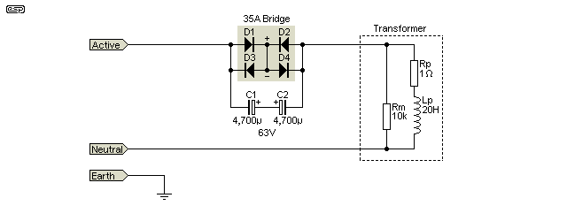

Well, using the Elliot Sound DC block the hum has decreased significantly, now it is perceptible with the ear very close, it has not disappeared completely but I think it could be fine. Do you have any suggestions to modify the DC block and make it better? I attach the diagram
Provided the total voltage across the two cap is below around 1 volt then its as good as it gets. The diodes only protect the caps from excess voltage.

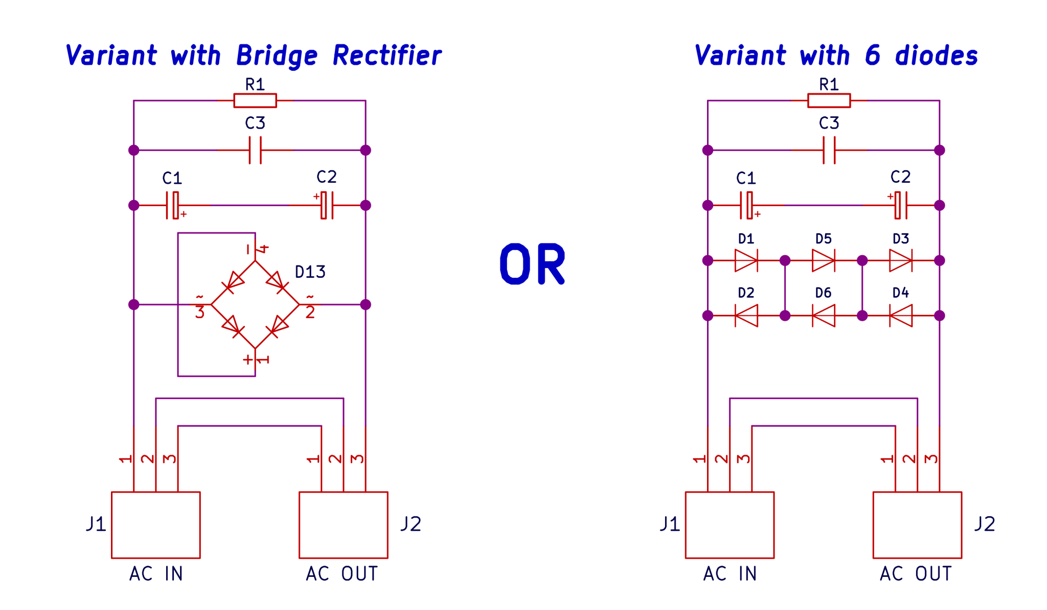

I found many discussions online, in some cases they talk about problems (fire) if a diode fails, what can be done to eliminate this problem? I found other schemes that are similar, could you explain to me in the attached scheme the usefulness of R1 and C3? I understand that more diodes raise the DC voltage withstand value, right? Thanks
If a diode fails short nothing bad will happen. If they fail open then the caps could see a massive voltage spike at switch on and could fail by going 'pop'. As with any mains circuit, it should be appropriately fused and located in the equipment such that it could not cause damage if the worst happened.
Worst case if you connect a 2200/6.3 or 10 volt cap (which is a suitable voltage rating here) across the mains it will explode instantly. If it located correctly and safely in the equipment it will do no further damage.
FWIW, large power diodes... I'm going to say I've never had a large mains rectifier fail open.
R1 and C3. I can't see they serve any purpose whatsoever. Normally we bypass electrolytics to help preserve low impedance at high frequency due to the caps self inductance. My first thought here is that doing that is a negative thing because if there were any high frequency rubbish on the mains its surely better to keep it out.
6 diode version... measure your voltage across the caps first. If you really need a 6 diode version then I think you have bigger problems than buzzing toroid and you need the cause of the mains asymmetry (that cause this misleadingly named 'DC' shift) diagnosing and fixing.
