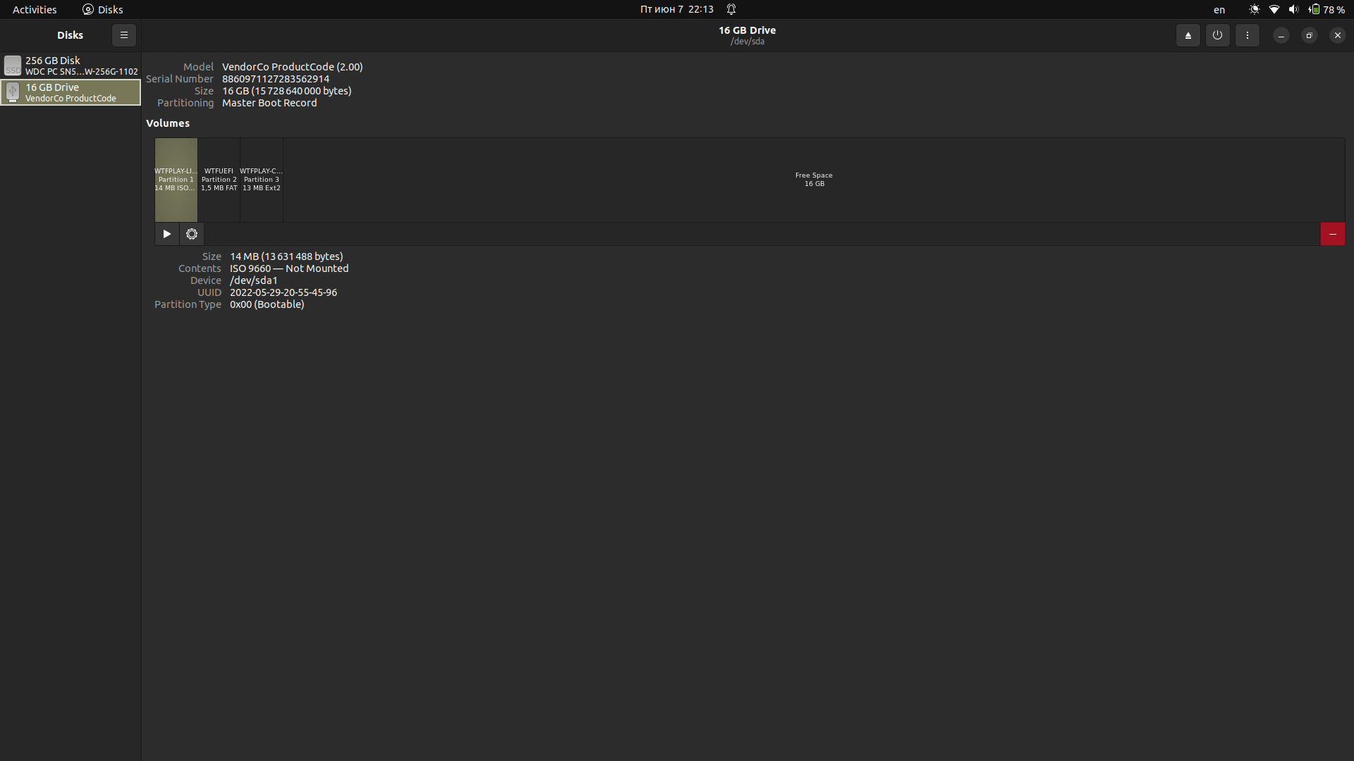

Dear @frd__ , i want to use all the free space on live usb wtfplay with music, but any manipulations with creating new partition or resizing wtfplay-conf fails with removing wtfplay-live partition. Is it possible to resize wtfplay-conf inside the wtfplay booted? I use dd to write iso.
OK - this is the procedure of adding a new FAT32 partition to the wtfplay-live image that was written on a memory stick. I have just tested all steps and it works as expected. I used 2GB memory stick.
What you need:
1. Linux - we will type a few commands. Any distribution should do. I used Archlinux.
2. root access - the disk modification commands must be executed with root privileges
3. wtfplay-live ISO image
4. a memory stick
My memory stick is /dev/sdb. Your may be different.
The ISO image that I use is wtfplay-live-0.7.4.3-core2.iso. Your may be different.
The commands are in bold. The code blocks show the command that I executed and what those command printed in the terminal (I removed some unrelated messages in the last step).
Step 1: Write the ISO image onto the memory stick
Step 2: Display the partition table. We want two things: the number of sectors on the memory stick (this will depend of the memory stick capacity), and the number of the first free sector. The number if the first free sector is not going to be displayed, but, instead we will see the number of last sector that is occupied. The first free one next.
Above we can see that the total number of sectors on my memory stick is 3913728 and the last occupied sector is 49151. This means that the first free sector is 49152.
Step 3: Calculate the number of free sectors on the memory stick (you can use a calculator instead
) I am using the total number of sectors and the number of the first free sector on the disk. In the result we will get the size of the new partition that we will append.
In my case the size of the new parition will be 3864576 sectors.
Step 4: Append the partition. We are using sfdisk utility for this. We are also using it in the batch mode.
Here is what is happening above. We pass the new partition specification to sfdisk, which kindly append it (-a option) to the partition table of /dev/sdb.
The partition specification has four entries separated by space. Their meaning is as follows:
49152 is the first sector of the new partition. We found it in step 2.
3864576 is the size of the new partition. We calculated it in step 3.
0b is the partition type. 0b is for FAT32.
- (hyphen) means the field is absent. In this case this is a bootable flag (we do not want the new partition to be bootable.
Warning: This command will modify the partition table on the memory stick, so double check everything before accepting with ENTER.
Step 5: Create FAT32 filesystem on the freshly created partition. I named mine "MUSIC":
Step 6: Double-check if everything is as intended with lsblk.
And you are done!
If you mess something up you can always try again. Writing a new ISO image onto the memory stick will overwrite the broken parition table.
dd if=wtfplay-live-0.7.4.3-core2.iso of=/dev/sdb bs=4M
Code:
[root@linux]# dd if=wtfplay-live-0.7.4.3-core2.iso of=/dev/sdb bs=4M
6+0 records in
6+0 records out
25165824 bytes (25 MB, 24 MiB) copied, 3.41836 s, 7.4 MB/s
fdisk -l /dev/sdb
Code:
[root@linux]# fdisk -l /dev/sdb
Disk /dev/sdb: 1.87 GiB, 2003828736 bytes, 3913728 sectors
Disk model: USB DISK Pro
Units: sectors of 1 * 512 = 512 bytes
Sector size (logical/physical): 512 bytes / 512 bytes
I/O size (minimum/optimal): 512 bytes / 512 bytes
Disklabel type: dos
Disk identifier: 0x480618fb
Device Boot Start End Sectors Size Id Type
/dev/sdb1 * 0 24575 24576 12M 0 Empty
/dev/sdb2 108 2987 2880 1.4M ef EFI (FAT-12/16/32)
/dev/sdb3 24576 49151 24576 12M 83 Linux
expr 3913728 - 49152
Code:
[root@linux]# expr 3913728 - 49152
3864576
echo "49152 3864576 0b -" | sfdisk -a /dev/sdb
Code:
[root@linux]# echo "49152 3864576 0b -" | sfdisk -a /dev/sdb
Checking that no-one is using this disk right now ... OK
The device contains 'iso9660' signature and it may remain on the device. It is recommended to wipe the device with wipefs(8) or sfdisk --wipe, in order to avoid possible collisions.
Disklabel type: dos
Old situation:
/dev/sdb4: Created a new partition 4 of type 'W95 FAT32' and of size 1.8 GiB.
All partitions used.
New situation:
Disklabel type: dos
/dev/sdb4 49152 3913727 3864576 1.8G b W95 FAT32
The partition table has been altered.
Calling ioctl() to re-read partition table.
Syncing disks.
mkfs.vfat -n MUSIC /dev/sdb4
Code:
[root@linux]# mkfs.vfat -n MUSIC /dev/sdb4
mkfs.fat 4.2 (2021-01-31)
lsblk
lsblk -f
Code:
[root@linux]# lsblk
NAME MAJ:MIN RM SIZE RO TYPE MOUNTPOINTS
sdb 8:16 1 1.9G 0 disk
├─sdb1 8:17 1 12M 0 part
├─sdb2 8:18 1 1.4M 0 part
├─sdb3 8:19 1 12M 0 part
└─sdb4 8:20 1 1.8G 0 part
[root@linux]# lsblk -f
NAME FSTYPE FSVER LABEL UUID FSAVAIL FSUSE% MOUNTPOINTS
sdb iso9660 WTFPLAY-LIVE 2020-10-17-20-53-04-14
├─sdb1 iso9660 WTFPLAY-LIVE 2020-10-17-20-53-04-14
├─sdb2 vfat FAT12 WTFUEFI BA01-25E3
├─sdb3 ext2 1.0 WTFPLAY-CONF 9720277f-ac9c-4831-b73d-7c10eedc3fb4
└─sdb4 vfat FAT32 MUSIC AC44-8592
And you are done!
