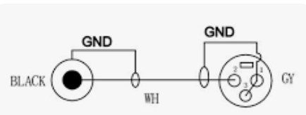

I can't see the reason to remove it. The hot runs to the xlr and the RCA. The GND does the same. The neg to the XLR. There is no extra circuit caused by the RCA being there. Without the jumper it is just there.

feel free to use RCA input (with XLR shorting plug) and leave SE to Bal conversion to amp itself

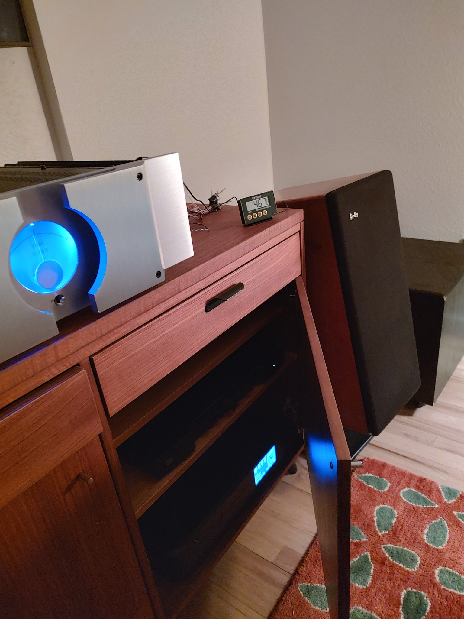

Biased the X150.5. First round dodgy af, second times a charm! Exercising pots helped... Started with a range of 93-125mv (4) @ 47
5 . Ended up after second round 140mv solid for all 4. And diff 0-1, abs, single dig. (mv) @54. Pulled the ground straps added load and 50deg idle ! Sitting at 47 RN listening to Daniel Lanois, Needle at 12 o' c lock. Not moving much. Pretty cool. Still looking to measure voltage drop across the source resistors..ordered qty-100 ERX-3SJR47. 3.3k harder to find. 5w easy, bigger. Probably fit. 100 still cheap. Peace

you measured - what - 140mV between checking "bias" headers on motherboard
that's exactly voltage sag across 2 series source resistors in output
what's room temperature?
hope you set it to +25C at top of heatsinks, recheck in Summer, when you can allow +30C, as prescribed in Service manual

Yes, Bias points A B on input boards. Room @ 25 deg C. Dialed it back a bit to 125 mv for each quadrant. Then, tested voltage drops across 0R47 n channel source resistors for the 2 quadrants accessible without tilting the heatsinks. In Theory should be close to 62.5 mv right? Left Channel A Quadrant front to rear 58,65,57,68,59,65,56,68,64,67 (mv) Right Channel B Quadrant 69,64,72,66,73,65,75,70,74,67 (mv). Definitely greater than 10% drift..... Looks like I'll be pulling the output boards, replacing resistors and testing mosfets. Upside is better sound when fixed!
no just chill, no need to fiddle with resistors and mosfets
taking in account value of source resistors, that being enough to nor worry about discrepancy you have
just recheck their torque

The torque is supposed to be around 9-10 inch lbs right? Just snug enough to compress the silicone pads properly.
