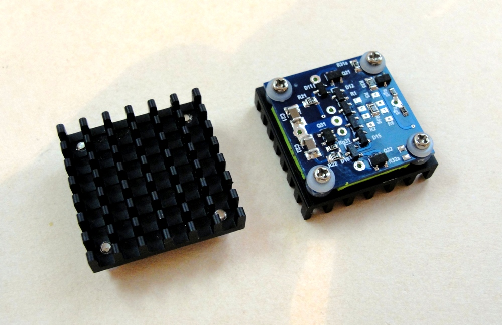

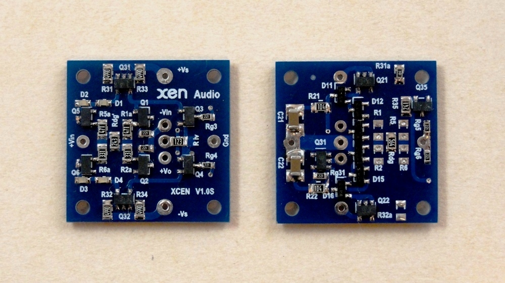

Though very happy with the performance of the prototypes, I only have SMD devices for the front end.
So a pure SMD version will serve me better.
It also allows all the devices requiring thermal tracking to be coupled to a small heatsink.
The only change in the circuitry is replacing the TL431s with 6x NXP BZX84C3v3 in series.
The latter is known to be very low noise, further cleaned off by an additional RC low pass before the cascode gates.
All performances of the previous prototypes can be repeated.
And I declare myself happy with the final result.

Yes, very pleased with that myself.
The circuit can of course be adapted to have differential gain >1 by simply changing one resistor, R_dg.
Distortion is pretty much the same at the same output level.
I am in love with these current conveyors circuits.
So versatile.
